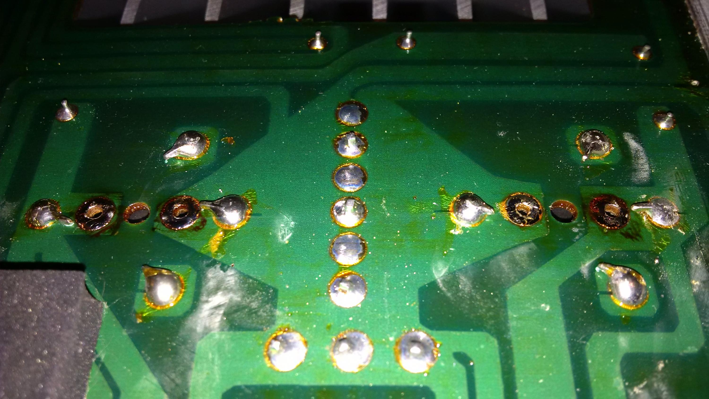

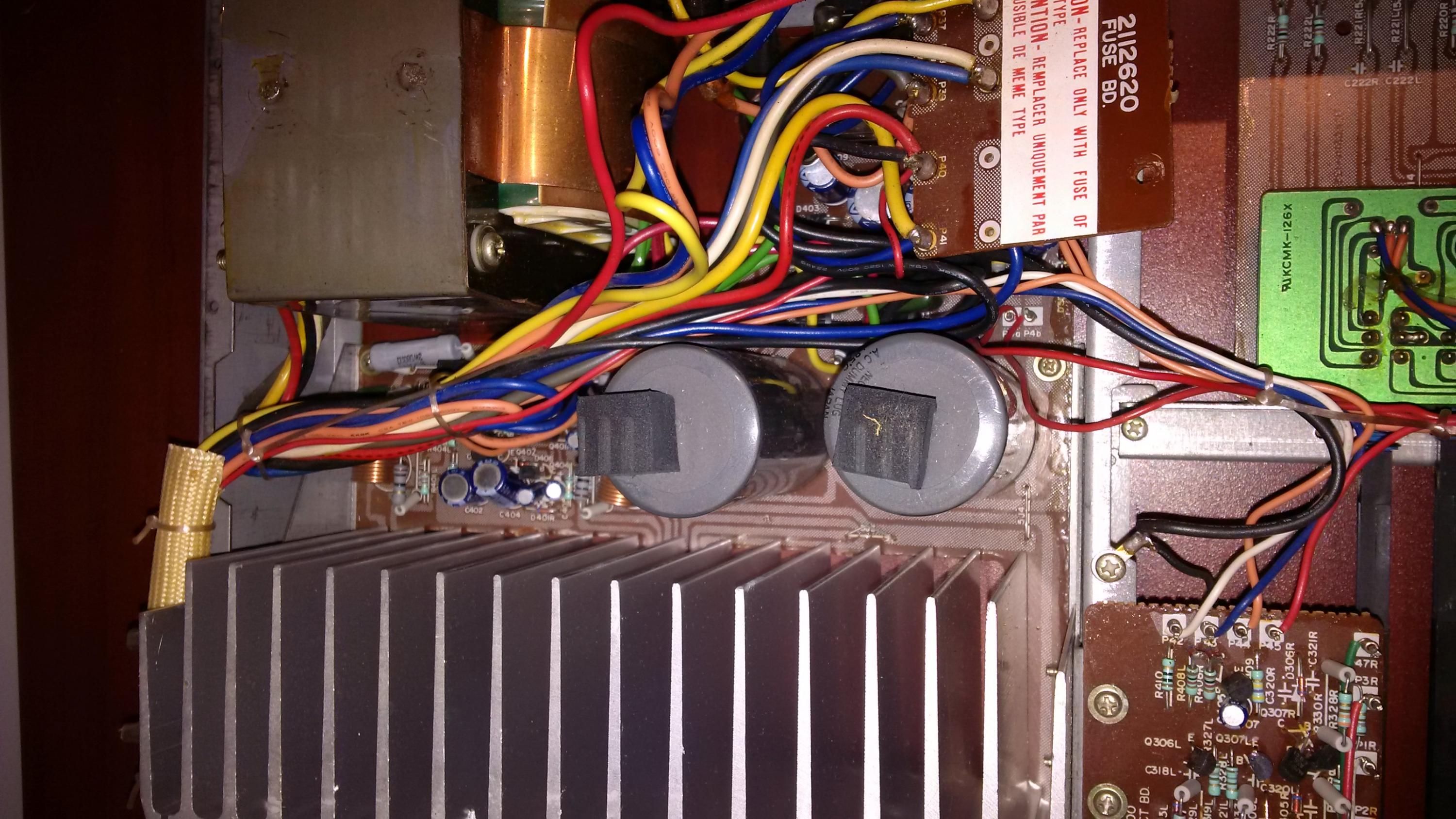

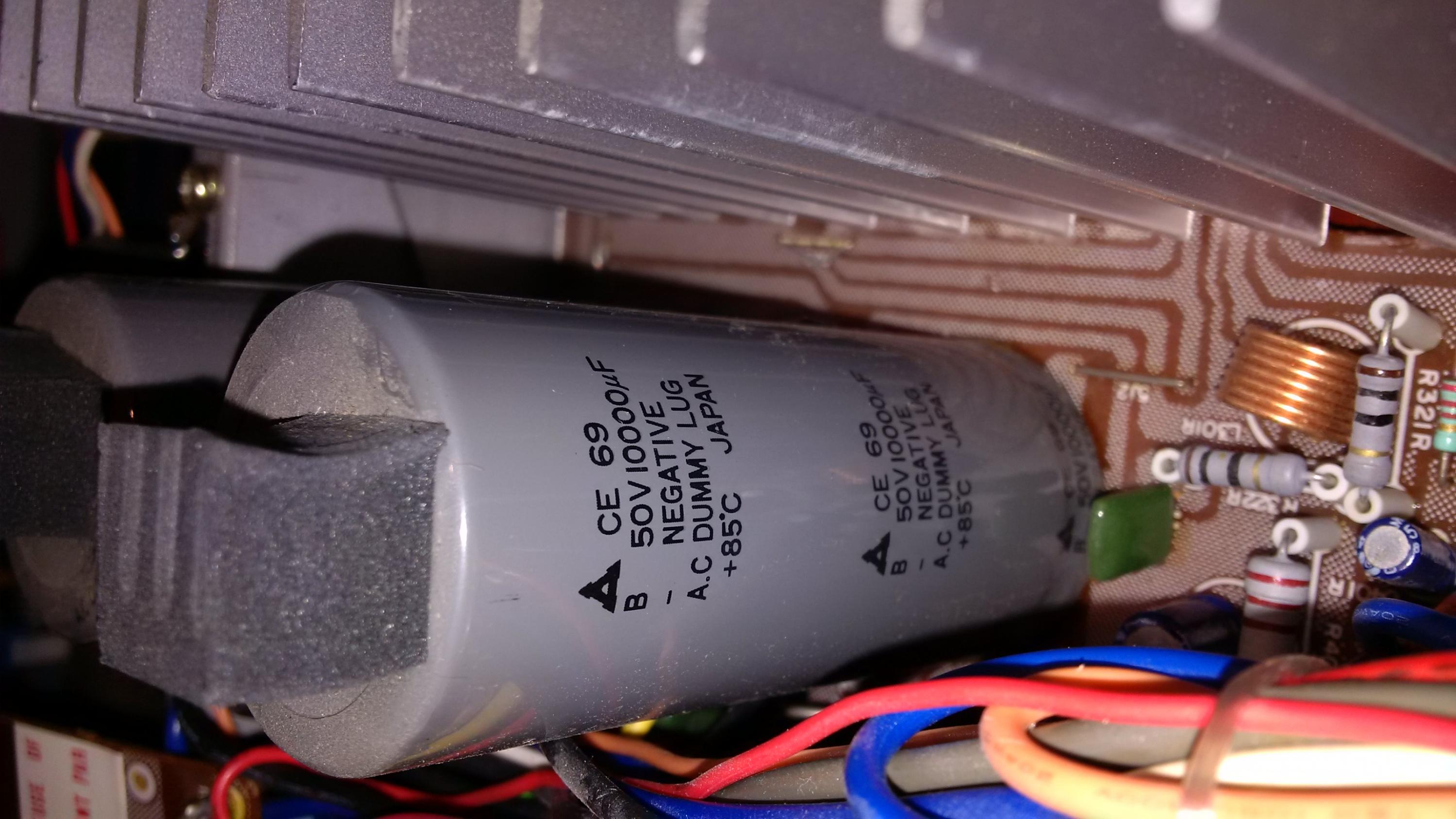

    I'm looking to recap this amp. looking at the power supply I'm not able to find proper replacements.
    10,000uf (0.01F) @ 50V
    Terminal Pin Spacing = 22mm
    Dummy Pin Spacing = 20mm
    Diameter = 35mm
    Height = 80mm
    See attached pics, thanks in advance.

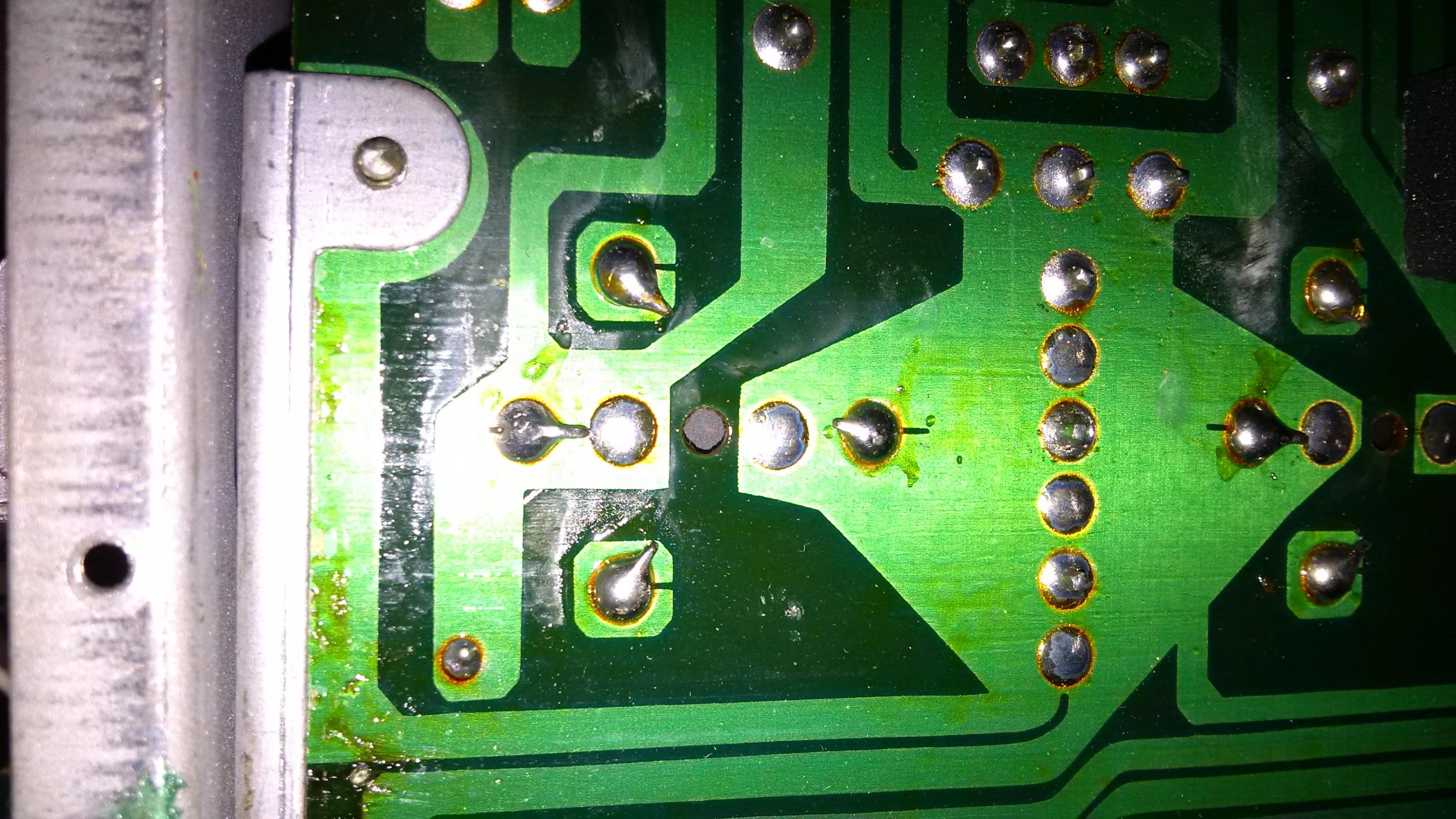

    the board has extra holes, is the spacing between the 2 unused holes 10mm??
    • Vinster
      • Feb 2016
      • 25
      Re: LXI AM4023 (Sherwood A2220-CP) - Power Supply Re-Cap
      you sir have corrected my tunnel vision...
      yes they are 10mm.... I feel a little silly now... kept looking to 4 pin caps (knowing the outer pins are just for support)
