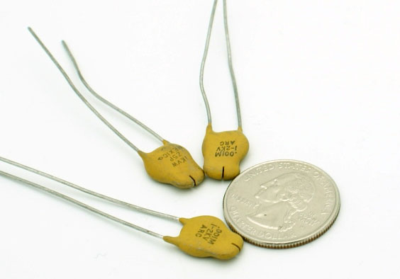

    I was using my Fluke 75 yesterday and it gave a low batt sign. I bought it around 1986 at Fry's in San Jose. I opened it up to throw a new 9-volt batt in it and noticed two yellow capacitors which looked like they had a black stripe running top to bottom on both sides. They looked like large tantalums from the shape. I put my finger on them and found the coating was rubbery and the stripe was a crack. Any ideas what they are and are they going to be a Problem? Meter seems to work fine especially with a new battery. I should send it to fluke for a new display the LCD is looking very washed out but still readable.

        These?

            Yeah, that's what they look like goon. Not exact but real close. Are they supposed to be split?
              Yes. Breakdown voltage of the gap is 2kv
              Follow the white rabbit.
                Re: Fluke rubber capacitors.
                Roger that. Not a problem then. I was thinking I might have to replace them. Thanks.
                    The Fluke 70 series I, II and III have an outstanding 2,000 (two thousand) hour battery life. Once the low battery comes on, replace it immediately otherwise you can get funny and incorrect readings.
                    As goontron noted, they are spark gaps. See this recent and relevant discussion over at eevblog where I just finished posting some comments.
                    http://www.eevblog.com/forum/repair/...pair-teardown/
                    Faded digits on early Fluke series are a known problem. See
                    http://mrmodemhead.com/blog/fluke-8x-faded-lcd/

                          Well, I pulled the display. That rubber was really stuck to the circuit board. I cleaned the solder pads and the end of the rubber. I tried to get the rubber off the contacts on the glass but it wouldn't come off. I was concerned about pulling the contact off with the rubber so I didn't push it. Put it all back together. Good news is it still works, bad news is no change, still looks washed out. It's still usable so I'll leave it alone. Thanks everyone.

                            Did you use IPA? Sometimes it might take multiple cleaning applications to get it completely clean. If that doesn't work, then the original zebra strip may have degraded after 30 years.
                            I have read stories of people boiling their zebra strips to make them expand, but like modemhead, I have never tried it.
                            http://www.electro-tech-online.com/t...ectors.110678/
                            Another story I read is to add solder onto the pcb so that the contacts are raised a bit to make better contact with the old zebra strip. Right now, I can't find that post.
                            Sometimes I see replacement zebra strips being sold on ebay. Here is one for $20 USD + free shipping.
                            http://www.ebay.com/itm/191806766518
                            Is it worth $20 USD? Only you can decide.

                              Found the stories about adding solder to the pcb at modemhead's blog in the comments section
                              "Chris Kay says:
                              December 4, 2013 at 10:44 pm
                              just did the cleaning of the zebra strips on my 73 iii fluke meter I noticed the display pcb pads were not very even, or missing solder so i either sucked off clean a couple, added a little fresh solder, even up the height of pads, cleaned pads as well very well with iso as well as zebra strips and glass. display nice and dark like brand new."
                              "Adam Wong says:
                              August 8, 2015 at 12:38 am
                              I have a Fluke 12 DMM that is 25 years old. The buttons stopped working because an elastomeric connector wasn't making good contact with the PCB. Cleaning did not fix it. The way I fixed it was to “touch up” the PCB with solder making sure that the solder on the contact points was a little thicker than original. The idea was to increase contact pressure between the elastomeric and the PCB. DMM works perfectly now."
