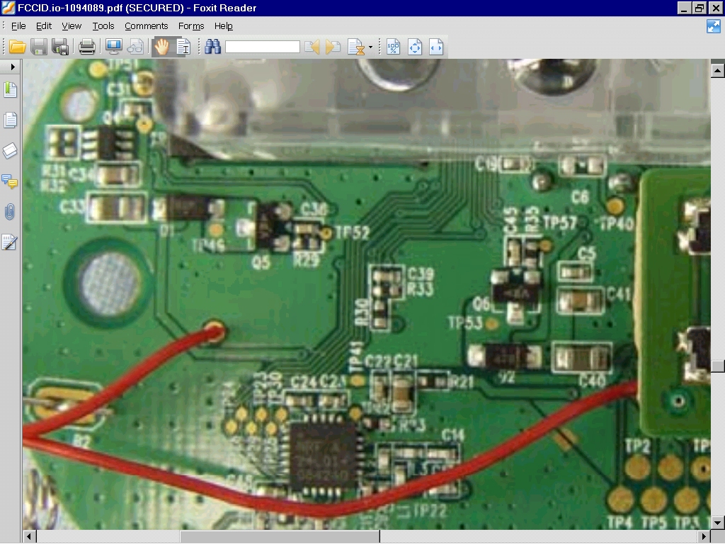

When I tried replacing that cap on Q5, capacitor C38, I accidently got a glob of solder between C38 and R29 on the end there. So now, R29 and C38 are both soldered to TP52. It's just the end of R29 and C38, the ones closest to TP52. Is this okay? Or should I try separating them? Originally they were hooked in parallel and C38 went to TP52...this shouldn't cause any problems, right?-- Law of Expanding Memory: Applications Will Also Expand Until RAM Is FullComment
Re: Need help identifying value of this bad SMD cap.
After touching a soldering to the transistor pins and removing the glob between the resistor and capacitor that, the blue light turns on most of the time when I flip the on switch on. Maybe one out of three times it won't turn on and I have to turn it off and back on. But I think that's progress.-- Law of Expanding Memory: Applications Will Also Expand Until RAM Is FullComment
In post #13, the first picture I uploaded shows a little black thing with a circle and some shiny stuff inside. I believe that's the sensor that tells when the mouse is being moved. You can't see from the pictures, but there's a square inside there has marks on it. Perhaps I damaged that? I noticed if I push on that black thing, it'll make the mouse do different things. Perhaps there's a bad solder joint there? I can't get to the pins though, they're under the plastic. I'm afraid if I use hot air, I'll melt the plastic.-- Law of Expanding Memory: Applications Will Also Expand Until RAM Is FullComment
I think that is some type of photon receiver chip. The light bounces off a surface and the photon receiver must pick it up to tell where it is. Perhaps when one moves the mouse there is a frequency change in the light being received and that tells in which direction it is going? I also thought Y indicated an oscillator to. I always like pictures of the circuit when I am talking about sinking current because to me it is so much easier to understand than trying to describe a picture in words. A Transistor a Bi-polar devices where Fets are uni-polar. Fets are linear devices. Transistors are not necessarily linear. Fets are turned on by a gate or a large enough potential between Drain and Source. The gate controls a channel that the current is flowing through between drain and source. It does this by imposing a charge on the channel. Transistors can have a common gate, common base or a common emitter. The common base is the most widely used. A Transistor can be biased four separate ways. The TTL logic are with a collector connected to the output. It is very noisy and slow. ECL logic is with the emitter connected to the output it is faster than TTL but uses much more current. Both are the design of transistors, bi-polar devices. Then CMOS stepped in which is a FET design N&P channel. They were quicker, linear and supposedly able to handle various different voltages. Latch-up was a problem and has to be consider in the design. That is all I can remember. If I am wrong on some of it I would hope BudM would specify.Comment

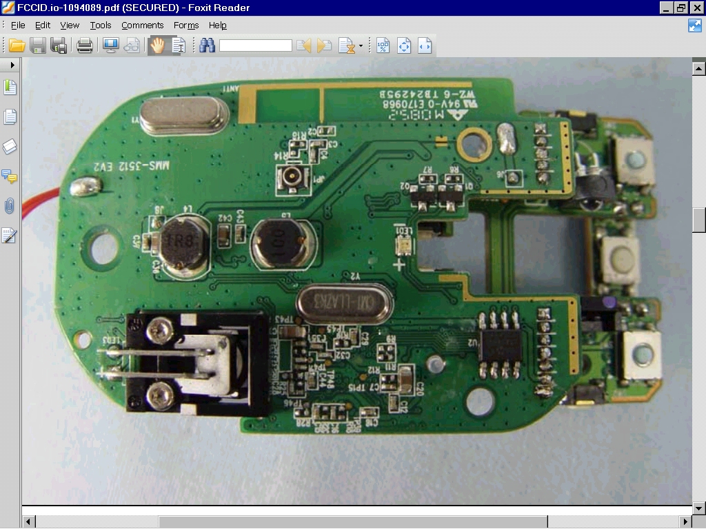

1383, Wireless Mobile Mouse 6000, FCC ID C3K1383:
https://cdn.badcaps-static.com/pdfs/...845bfa4e3b.pdf
Exhibits for C3K1383 at FCC database:
https://fccid.io/C3K1383
Internal Photos FCC ID: C3K1383:
https://fccid.io/document.php?id=1094089
https://cdn.badcaps-static.com/pdfs/...8a55129079.pdfComment
Here is the block diagram of the circuit AISI:
There must be a microcontroller (MCU) at the optical sensor. AFAICT the MCU provides two PWM outputs for two boost converters.Code:BAT+ 1.7V - 5.5V ___ 1.9V - 3.6V EEPROM | ___ 24AA32A | | antenna 4Kx8 .---------------. | \|/ __ | | .-----------. | -o| |o--| | | wireless | | -o| |o--| MCU |-----|transceiver|-------' -o| |o--| | | | -o|__|o--| | | nRF24L01 | U2 | | '-----------' | | | .---------. | | _-_ | switches| '---------------' |___| | _/ | | | | | - BAT+ | -o/ o-| | _-_ | | | + | | | |___| | | PWM1 | | LEDs | | - | | Y1 | | -|<- | | | | | 16MHz L4 C| | |--' | | 1R8 C| | scroll | Y2 | | R29 C| | wheel | 16MHz | | ___ | D1 | | | | .--|___|--. Q5 +--->|---+---+---> Vcc1 | opto | | | | | | | | | sensor | | '--| || |------||-+ | | '---------' | '----||---' ||<- --- --- C34 | || ||-+ --- --- | | C33 | | | C38 | | | | +--------+---' | | | === | BAT- | | | | BAT+ | + | | |PWM2 | | L5 C| | 100 C| | R35 C| | ___ | D2 | .--|___|--. Q6 +--->|---+---+---> Vcc2 | | | | | | '-------| || |-----||-+ | | '----||---' ||<- --- --- C41 || ||-+ --- --- | C40 | | C45 | | | +--------+---' | === BAT-
I would measure the voltages across the filter capacitors on each of the Vcc1 and Vcc2 supplies.Last edited by fzabkar; 12-17-2015, 04:56 PM.Comment
Sorry, I should have drawn Q5 and Q6 as NPN BJTs, not N-channel MOSFETs.
This part looks like it might be the one:
NSS40201LT1G / NSV40201LT1G, Onsemi, 40V, 2A, Low VCE(sat), NPN Transistor, marking VB, RDSon 44mohm, hfe = 370, SOT-23:
https://cdn.badcaps-static.com/pdfs/...eb830320fa.pdfLast edited by fzabkar; 12-17-2015, 11:59 PM.Comment
Just FYI, the manufacturer appears to be Commutek.
http://www.commutek.com/?p=6&cat2=3&id=4&s=&lang=en
http://www.commutek.com/?p=6&cat2=3&id=6&s=&lang=en
The part number looks like a special run for Microsoft. The nRF24L01 datasheet specifies 16MHz.Comment

BTW here is my amended diagram:
Code:BAT+ 1.7V - 5.5V ___ 1.9V - 3.6V EEPROM | ___ 24AA32A | | antenna 4Kx8 .---------------. | \|/ __ | | .-----------. | -o| |o--| | | wireless | | -o| |o--| MCU | |transceiver| | -o| |o--| |-----| U3 |-------' -o|__|o--| DSP | | nRF24L01 | U2 | | '-----------' | U1 | | .---------. | | Y1 _-_ | switches| '---------------' 16MHz |___| | _/ | | | | | - BAT+ | -o/ o-| | _-_ | | | + | | | |___| | | PWM1 | | LEDs | | - | | | | -|<- | | | | | L4 C| | |---' | | 1R8 C| | scroll | Y2 | | 390R C| | wheel | 16MHz | | R29 | D1 | | | | ___ +--->|---+---+---> Vcc1 | opto | | | .--|___|--. | | | | sensor | | | | | |/ | | '---------' | '--| || |-------| Q5 --- --- C34 | '----||---' |> --- --- | || | C33 | | | | | | | C38 +--------+---' | | | === | BAT- | | Q5/Q6 = NSS40201LT1G | | BAT+ | + | | |PWM2 | | L5 C| | 100 C| | 800R C| | R35 | D2 | ___ +--->|---+---+---> Vcc2 | .--|___|--. | | | | | | |/ | | '-------| || |------| Q6 --- --- C41 '----||---' |> --- --- || | C40 | | | | | C45 +--------+---' | === BAT-Last edited by fzabkar; 12-18-2015, 05:17 PM.Comment
