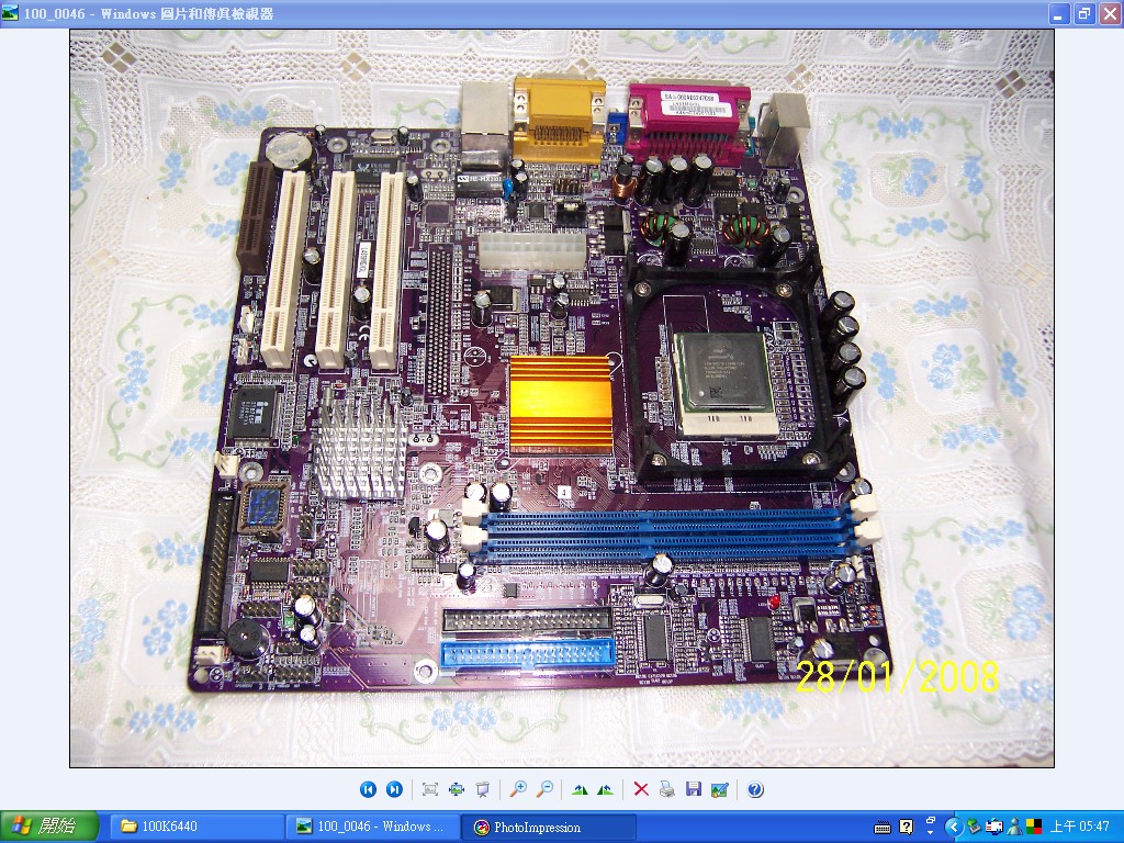

                              Re: Still No Banana After Recapping
                              Originally posted by dubois928
                              Hey all. I have a FIC AM35 motherboard that had bad 1000uf 10v caps. I replaced all eleven with chemi-cons and I am still getting the same exact BSOD I was getting before the recapping. What could be wrong here? Weak contacts?
                              Thanks,
                              Ken
                              Dear Friend,
                              My past experience tells to replace all the capacitors of your motherboard instead of replacing only those seen to have problem.
                              • Leung Kai-yan
                                • Apr 2006
                                • 32
                                Dear Friend,
                                After replacing the majority of the capacitors of this mainboard, it was found to reboot once for about two months. This persist until all the remaining capacitors were replaced.
