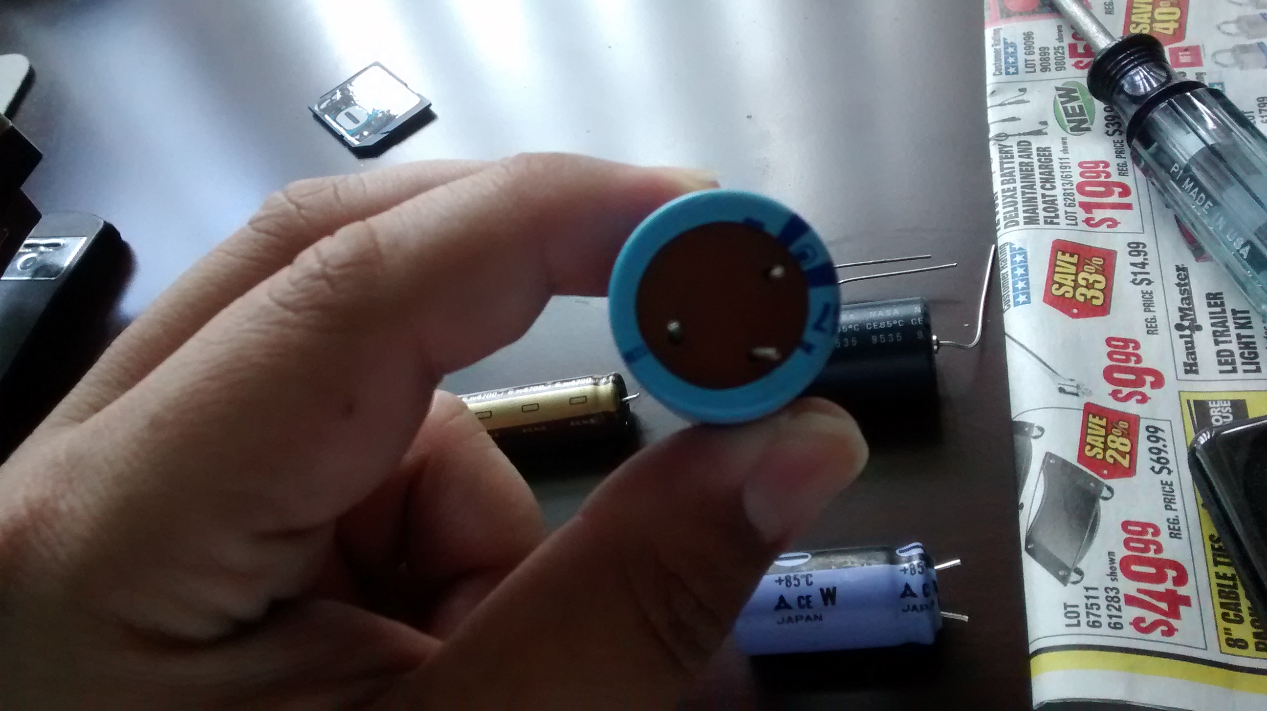

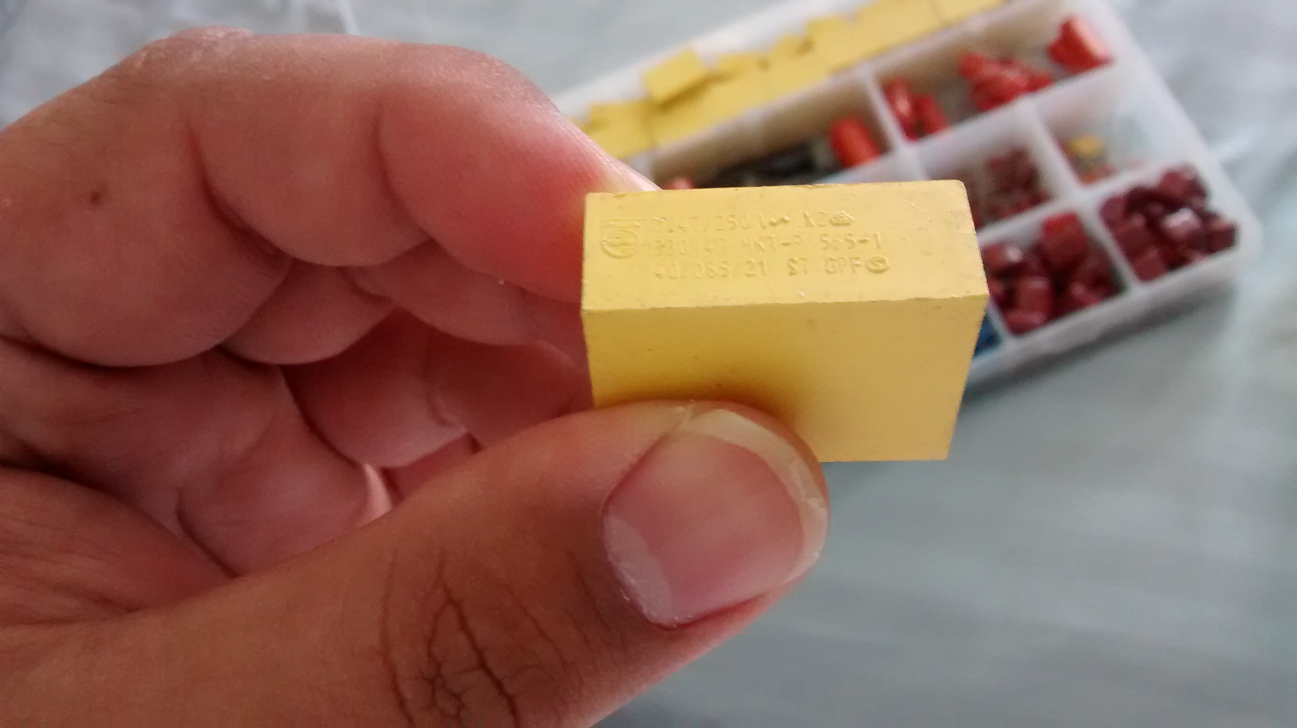

    Hi everyone coreangel here i purchased some time ago a random case of all types of caps from Electronics Goldmine, and it had tons of Y,X Caps,Electrolytic caps,film caps,etc
    Now while i know many are old or probably used or NOS, i still want to know your opinion on some of them i am uploading some of the pictures up to here for input and see if they are worthy to go in the good caps section

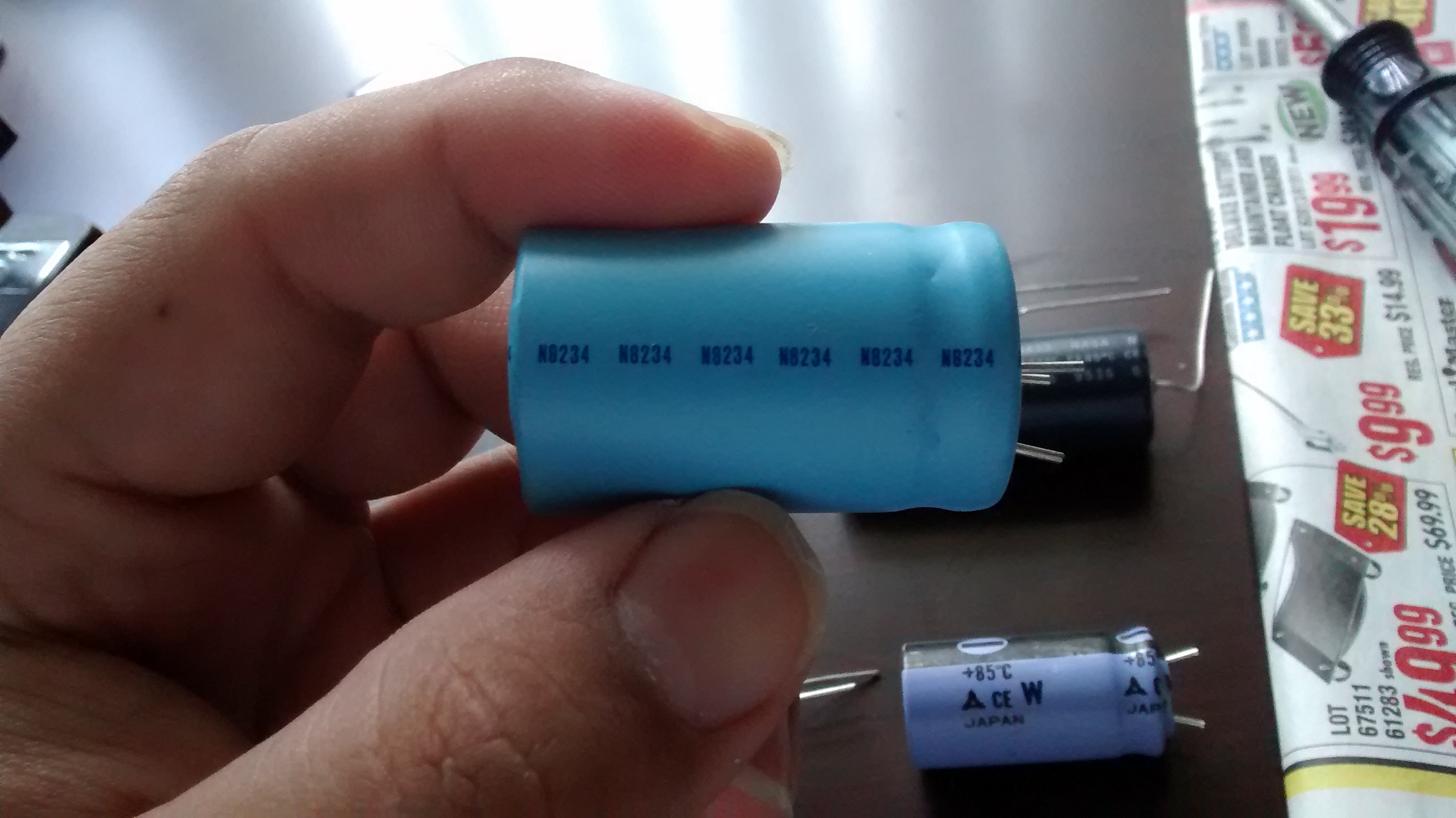

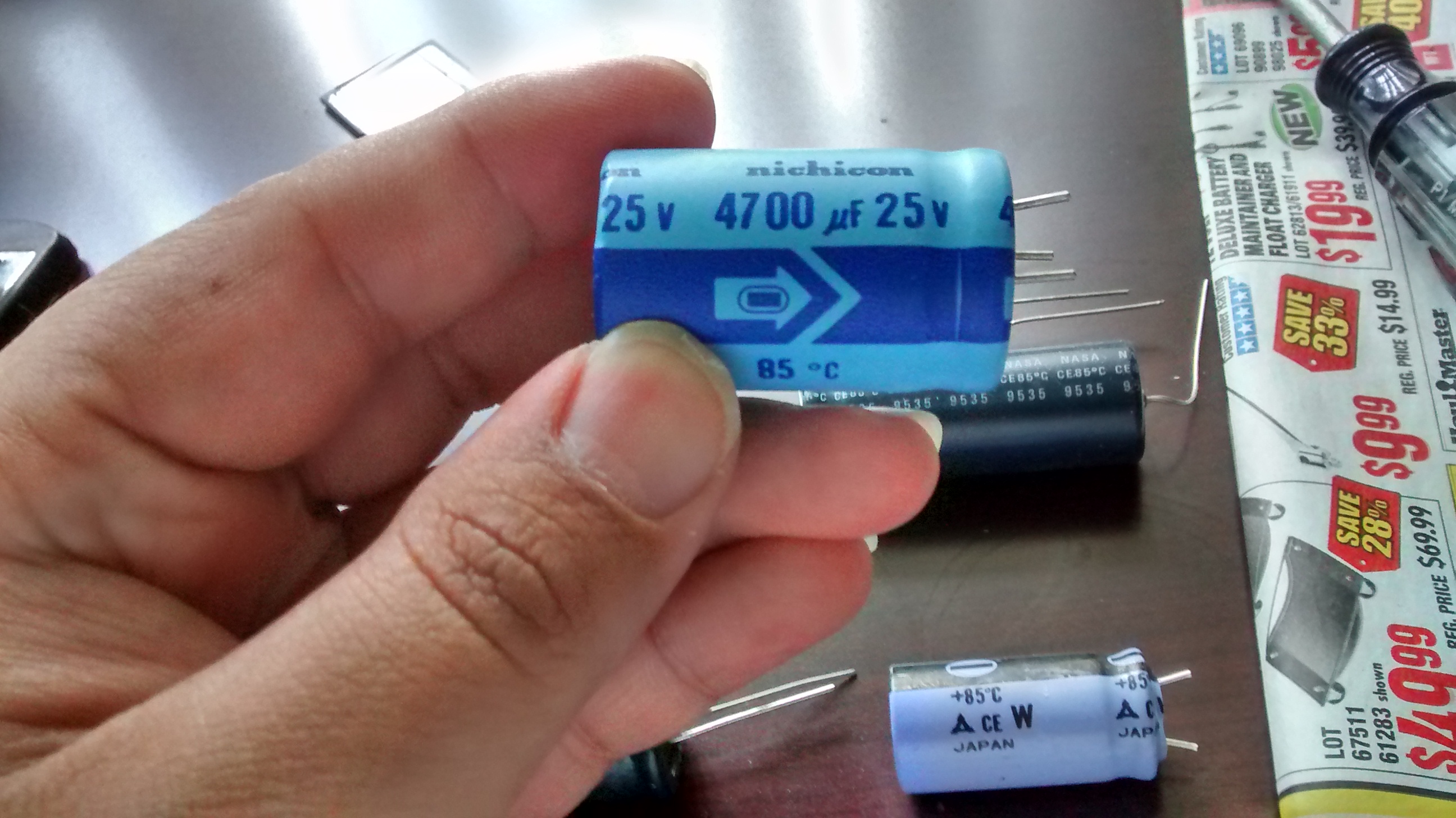

    (The first one is a nichicon cap,it has no bung just a flat bottom. at first i thought it was a counterfit cap and it was going to have a tiny underrated cap in the inside... nope it's all electrolyte material, although it looks old? it's still moist which left me surprised .)

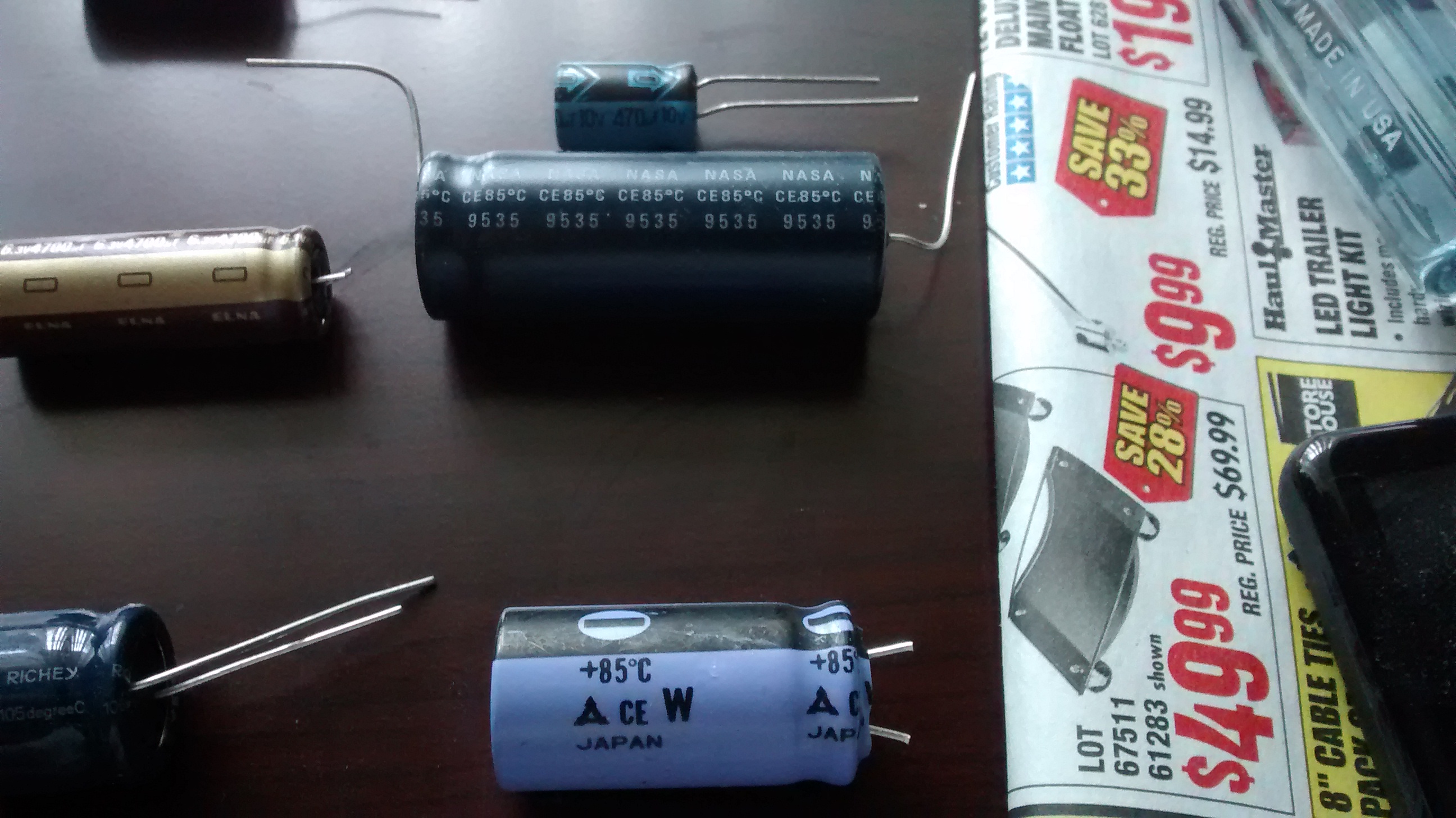

    (The second set of pics is a Nc cap? made in japan 16v 10000uf(M) it says NASA CE 85C(degrees) 9535
    the other one is a lilac A ce W Japan Cap 85C 2200uf 16v with no vent marking on the top just 7hK1)
    the other one is a AM 470uf 10v cap rok9143 85c agr cap)
    (The last set of caps
    Ritchey 105C 63V 470uf ,
    ITT 2200.0u 16.0S Cap, and a
    chemicon KMG 25v 2200uf cap,and last but not least
    Elna (looks audio grade) rjh 6.3v 4700uf ce105c 9840 s)

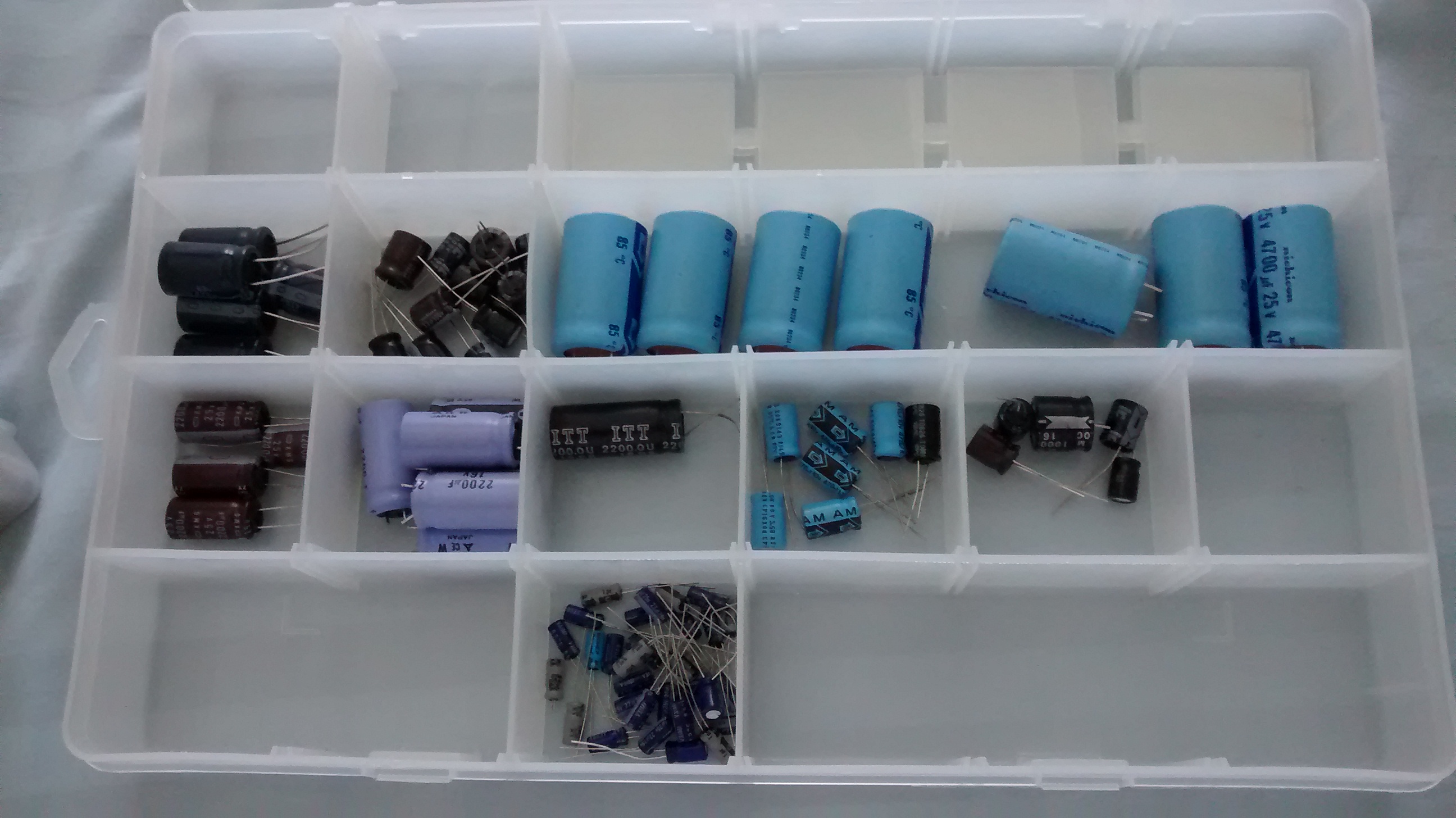

    If you think that enough take a look at the rest
    what am i supposed to do with it all i though it was just going to be a couple of caps not this:
    Now should i test them all ( i have an ESR meter with additional functions on order)

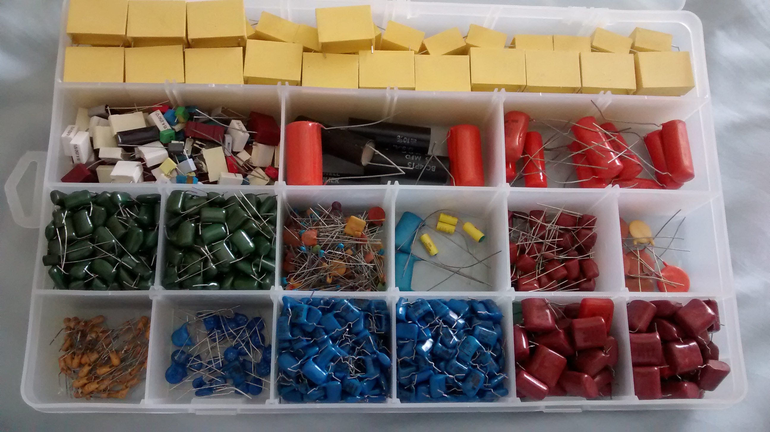

    the i also took a pic of an X-cap (phillips brand)
    any suggestions, are they all crap caps? can they be used for repairs, or are they all just not worth it? thanks for all the help
    Yes i love Nichicon MUSE Audio Capacitors...they would look awesome all over any motherboard

    Electrolytics look like general purpose caps. I've got some similar bins of NOS caps. They are useful for some things, just make sure to test each before using because some have lost forming and/or dried out over time.

      thanks thats what i thought about the electrolytics maybe they are just vintage stuff...However the rest of all the caps ceramic,film, should i test them all?...

          elecrolytics are worthless, the tantalums and multi-layer ceramics are normally pretty expensive and usefull.
          the film caps are good if your into audio.
          how much did those packs cost?

            It was a box for 15-20 dollars i think 2 orders of random caps, i mostly got film caps as you saw, but the electrolytics especially the nichicons are what got me ( i wonder if they are fakes) i dont think i have tantalum caps, but i do have lots of x caps or y caps,and film caps, do they dry up like electrolytics? is there a time when they cant be used any more?

              tantalums look like yellow or blue blobs on wires.
              you have lots.
              i doubt anything you have is fake, just old.

                  The X and Y caps are very useful if you like to play with cheap power supplies.
                  The polypropylene/polyester/polystyrene caps are useful if you are building audio circuits or replacing old wax capacitors in very old electronics.
                  Bot the X/Y and poly- caps don't age much without use, so you can use them with no worries.
                  The electrolytic caps you have look like general purpose stuff. Probably not suitable for motherboard, monitor, and power supply repair. Given that most of them are quite large in capacitance, they are probably fine for linear power supplies, though (i.e. simple power adapters with a line transformer + rectifier + caps). And should be okay for audio gear as well.
                  The only thing is, you might have to reform those electrolytic capacitors. This is done by hooking the capacitors in series with a resistor (10 KOhms usually works for one or two caps... use 2 to 5 KOhms for more caps) and charging them as close as possible to their maximum rated voltage. Leave the caps hooked to your charing power source for at least a few hours. And don't forget to discharge them before putting in a circuit.
                  I usually charge 6.3V caps with 5V, 10V caps with 9V, 16V caps with 15V, 25V caps with 20-24V, and 35V caps with 30V (I just have a bunch of wall-warts and small power adapters at my disposal for that).

                    thanks for the tip i have heard of reforming the caps but im still unsure about those behemoths of nichicons even though i thought they were fake i opened one up and sure enough a long roll of wet paper and aluminum film.So i just think they are old, ill test capacitance with my new meter when it arrives from china...

                      If it has a vent, then it is not that old. Be careful with really old (I think early 80's and older) vent-less caps. Those can explode when they gas-up good enough inside - literally !

                        They are not fake, but really really old. I see a 82 datecode on the Nichicon - that makes it 33 years old. On the capacitor marked nasa the datecode is 95 - so that is 20 years old.
                        Personally, I would not use them.

                          The Nichicon looks to be sealed with epoxy, so if it can be reformed without damaging the dielectric (and if it has a vent), it might be good for use.
