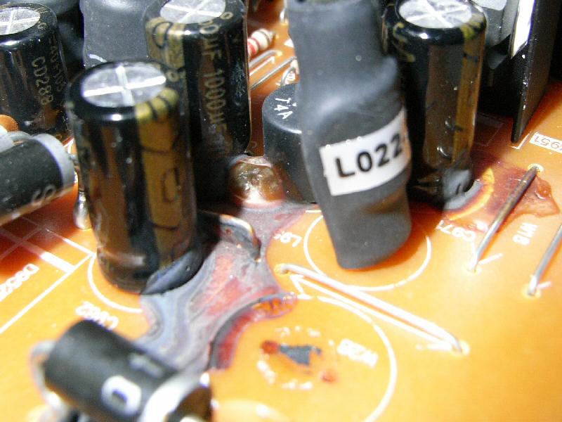

    Is this electrolyte leakage?

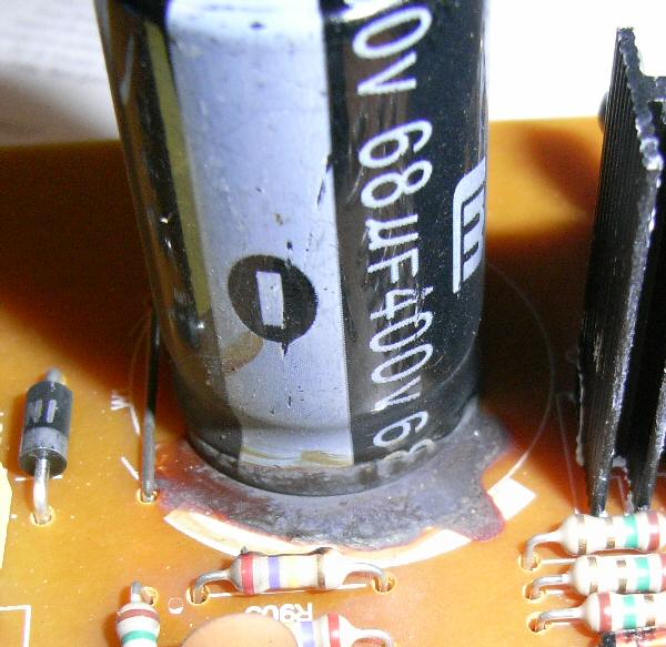

    I have removed one cap from this power supply as it was bulging top and bottom so oviously faulty.
    Are the brown marks you can see here elecyrolyte leakage or glue?
    Some of the connecting plugs do have a thin layer of a brown rubber type compound on them which is oviously designed to stop them coming off by themselves but I dont know if the marks on the board are the same stuff. You can see a large clump of stuff between the cap and inductor on the 1st picture.

    Looks like electrolyte to me. I don't think glue would flow like it looks like that stuff did. I say replace those buggers. Clean off the board good when they're out though.

      its glue.
      definately clean it off as it can corrode stuff.

        Thanks. I am looking to get an ESR/Capacitance meter next week so will probably test all the capacitors anyway as others could well be bad but not showing any physical signs.
        Its a cheap dvd recorder. Aparently it started going wrong where it would power on but when trying to eject the DVD it would power itself off. However after getting it home it does not power on at all.
        First step is to get it to a state where all the caps are ok on the psu and then go on from there.

          only sure way is replace all known crapcaps esp on the secondary.
