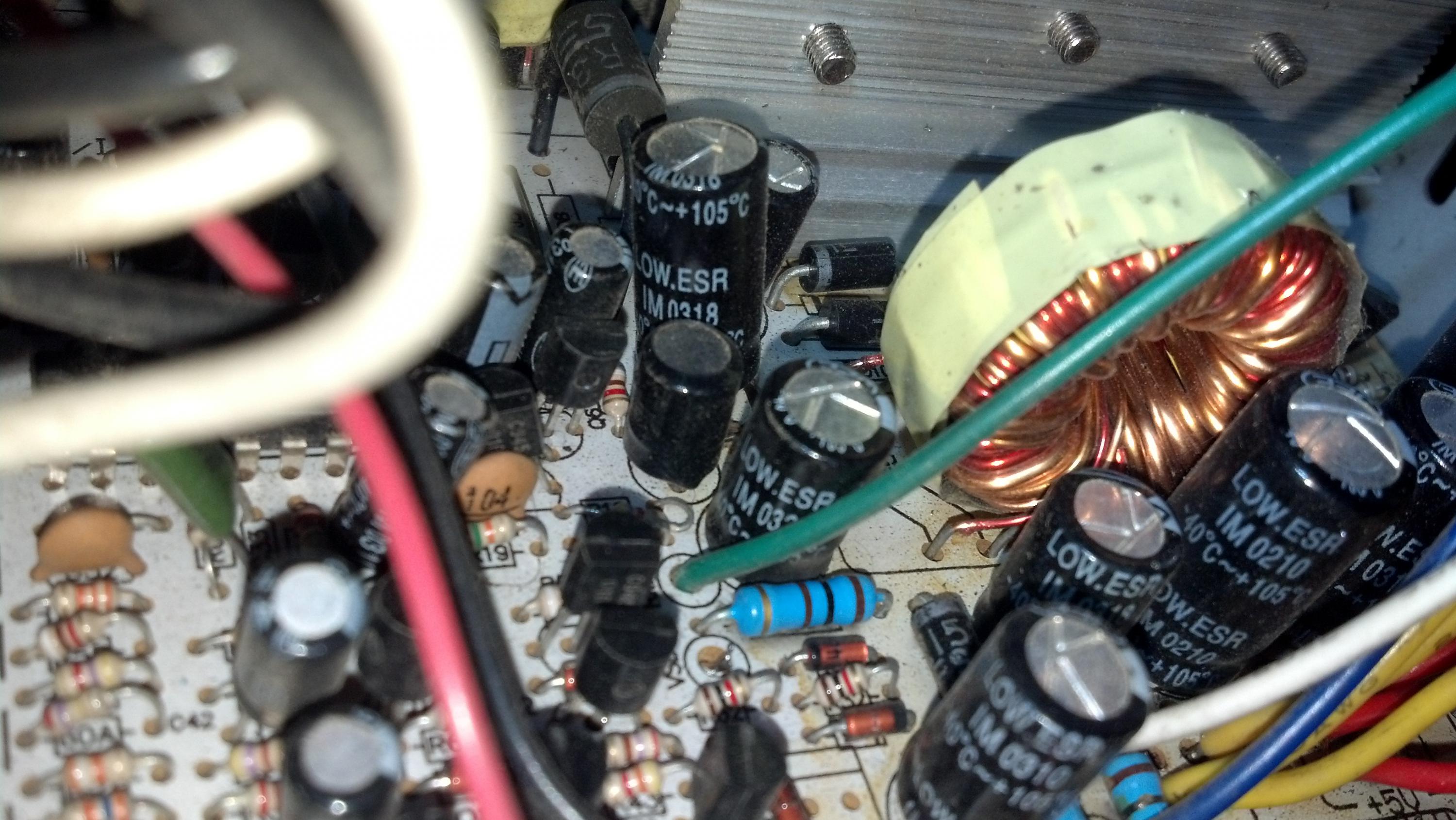

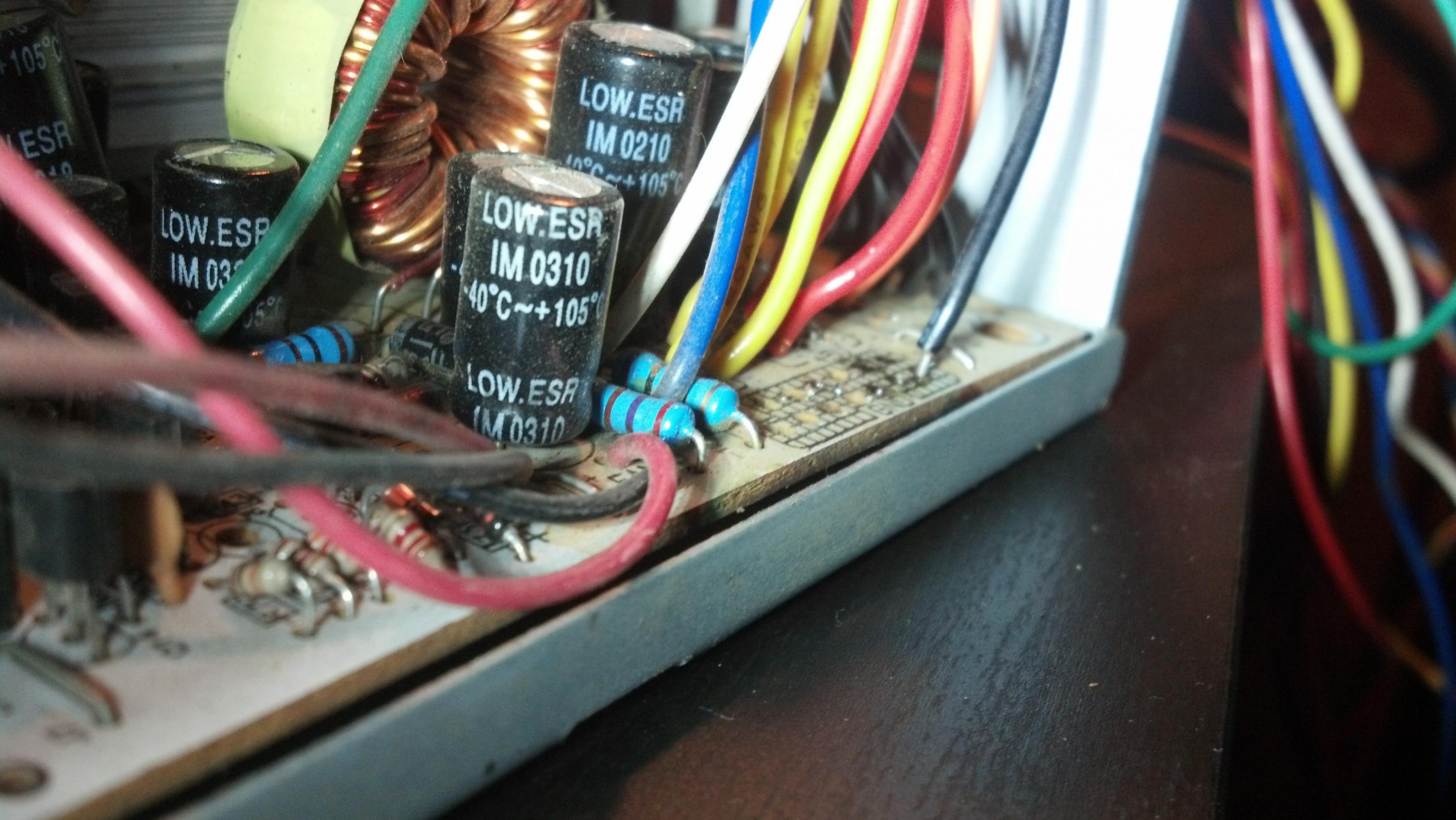

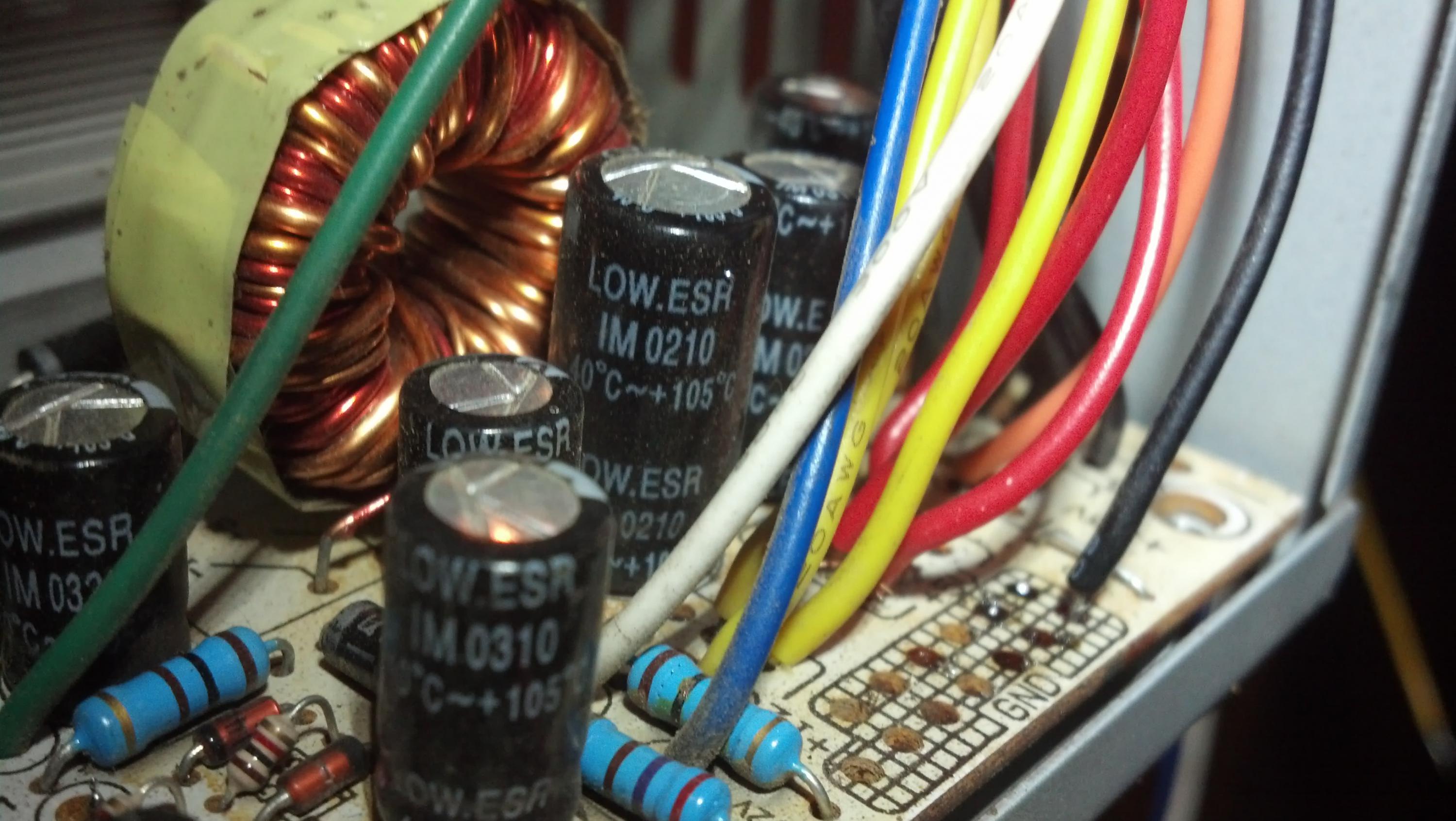

    Please help me identify these caps
    Hello, these are in an old 500w power supply.
    I cannot seam to find any info on the following:
    IM0310
    IM0318
    IM0210
    Thank you.

    Re: Please help me identify these caps
    Do they have anything else on them? A brand name or logo perhaps?
    If in doubt, Panasonic FM or FC should work fine as replacements, according to most on here.
      that is all that is on them sadly, I couldn't find anything more. its probably 15 years old.
        No surprise really, that K vent is only used by Rubycon officially, everyone else who uses it are fakers like Rulycon or other rubbish...
        Just use a middle of the road Low ESR series for replacement. Don't use General Purpose or Ultra Low ESR. Make sure they're 105 degree rated.
          You need to try and take a clear picture of the opposite side of those capacitors, as there is obviously some sort of logo and whatnot on the back side of them.
          It looks like it could be perhaps JEE capacitors?
            They're JEE/F-yoo "low ESR" junk. Note the ripoff/fake K vent, imitating Rubycon. Garbage by appearance, garbage by nature.
            I once tried non-swollen ones for the bulk filters in an FM transmitter kit. Horrible! GP caps were better.
            Replace all with Nichicon HE or PW, or Panasonic FC.

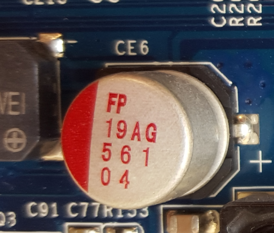

              Hi guys, can you help me to identify this capacitor (also attached)? I want to have it replaced because it looks a little bit inflated which I've never seen on this kind of capacitors.
              Many thanks.
                • 31214
                that's a solid polymer cap.
                http://www.fpcap.jp/
                • ulltrium
                  • May 2015
                  • 4
                  • Romania
                  It is, but can you help me to read its value and voltage? The value I believe it's 560uF but I'm not so sure about the voltage, I'm puzzled by that "04" from the end. Please help, I'd like to replace it. Thanks.
                    • 31214
                    560uf 4v
                    • ulltrium
                      • May 2015
                      • 4
                      • Romania
                      Thanks!
