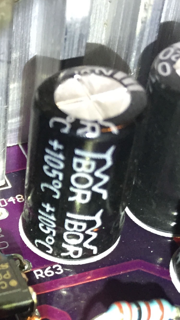

    I just bought a NOS (new old stock) power conditioner, manufactured in 2007. Literally factory sealed and unused. I unboxed it and tested it to make sure it works. Everything checked out. I popped the hood to take a look inside and saw it has about 17 TBOR caps rated to 105C, ranging from 10uf to 220uf. How crappy are these caps and should I just go ahead and replace them right away?

    I would recommend replacing them all with Japanese units.

      TBOR (actually TWBOR) are crap; I had a D-Link router full of those and suffice to say, it did not work since half of them had vented or pushed up from the bung.
      Link with photos:
      https://www.badcaps.net/forum/showthread.php?p=285999

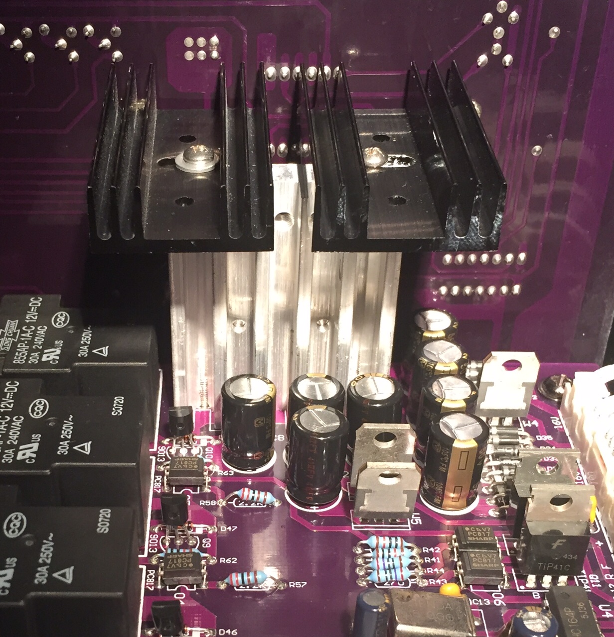

        Done - replaced all with Panasonic FM and a few FC.
        Also, they had two 12V regulators on one somewhat substantial heat sink. Still, it got so hot that I had to pull my hand away. I added two smaller ones that all together, nearly double the size of the original. So...what the hell were they thinking putting the cap bank RIGHT next to a blazing hot heat sink?

          that's the work of satan's school of electronic design - i'v seen it a lot.
          it's either very clever - and evil or very stupid.
          what will happen is the heat will dry out the cap, but because caps look better when they are warm you wont realise anything is wrong until you power it down one day and let it cool.
          then it wont work again.
