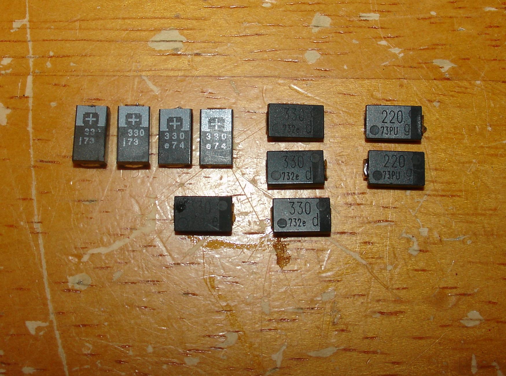

    Hi!
    I apologize if this is a repeat, I looked around and haven't found an answer yet, so I figured I would ask here
    Long story short, I have a Dell M90 that began not POST'ing unless the AC cord is pulled out (gives an error about the wrong adapter, although it is the factory one, & swapping it with equivalent gives the same). I pulled up all the caps on the mobo & found 10 that seem out of range according to both my Supco cap tester & Fluke meter, some over 100mf beyond the rated value.
    I'm having more difficulty than I expected trying to procure replacements. The 220 or 330 appears on all which I assume is the micro-farad value, but the voltage ratings elude me. How are the codes translated into voltages? ex, 220 73PUg, 330 72DTe, 330 732ed, 330 j73, 330 e74.
    Any help is much appreciated!
    -Chris

    lol, those are polymer - the value is what it says.
    your problem is related to the 1wire serial bus on the charger connector, nothing to do with polymer caps.

      Ohh, so you mean they are actually 73 volt, 72 volt, etc? I'm used to the electrolytics' nice round numbers like 25v, 50v, 100v.
      The middle wire was my prime suspect, but I ruled it out with a continuity check on my adapter from solder joints inside the p/s to solder joints on the mobo, all 3 wires look solid even if i wiggle the plug around a good bit, and no shorts. A known good p/s resulted in the same error. I suppose it could be something else in the mobo... There are other issues as well that started at the same time, most notably the panel starts displaying what looks like tv static in color (fixed by closing the lid and reopening). The problems have gradually gotten worse over the last few weeks, which is why I started leaning toward capacitors, they were the 1st thing that came to mind as getting worse over time
        • 31296
        Re: Learning SMD capacitor markings
        no, on the caps i mean 330 = 330uf ec.
        get a chematic for the laptop, then trace the center pin across the board.

          The 330 and 220 are the capacitance values, what's below varies from manufacturer to manufacturer, or even series to series.
          One digit may represent the voltage, the others may represent a series code, or the year/month of production.
          Like the above posters say, a message like "unrecognized charger" hints to a problem related to the 1-wire identification chip inside the charger or how the laptop reads that signal - the charger has a third data signal in the jack.
          Maybe the IC is blown, maybe that IC receives excess voltage from the adapter (due to a damaged zener diode or a capacitor or something, or maybe the IC got damaged due to ESD or some crap coming through that third data wire, it happens. Just because there's continuity between the pin in the connector and the psu pcb, doesn't mean it's still functional.
          You would want to check the stream of bits sent by that IC as you plug it into the laptop if you're really motivated.

            Thanks for the help, guys! After some long digging, i was able to find the schematic for the M90 motherboard, a Compal la-2881p. It has the capacitor voltages I was hunting for, too.
            Heading out for a weekend getaway, but next week I'll dig into the schematic and see what i can figure out with the charger signal wire.

                I ordered 10 replacement capacitors on ebay for $15 total, and after soldering them in, am happy to report that the laptop has a clean bill of health. One week and no issues! The main issues this solved for me were the display going nuts, and extreme slowness. The slowness was strange... not a HDD caching issue or something like that -- with nothing open but one browser and no hard drive activity, the laptop was barely able to display a web page. It was acting as if the CPU cache had been disabled. Now it's fast as ever again.
                stj & mariushm, you guys were absolutely right, the power adapter warning was a separate issue, I still saw it after replacing the caps. Unable to find any issues tracing the center wire signal along with the schematic, I tried what I should have tried first -- sprayed contact cleaner in the jack & plug That seemed to fix it. Odd, since my meter showed 0 0hms end to end.
                Thanks again for the help and advice!!!

                    I never did make any sense out of the codes under the values. The best I could figure, you have to dig out a schematic to find out what they are ... Sure would be useful IMO if they just printed the value & voltage.
                    Laptop is still running great after the replacements, it definitely did the trick.
