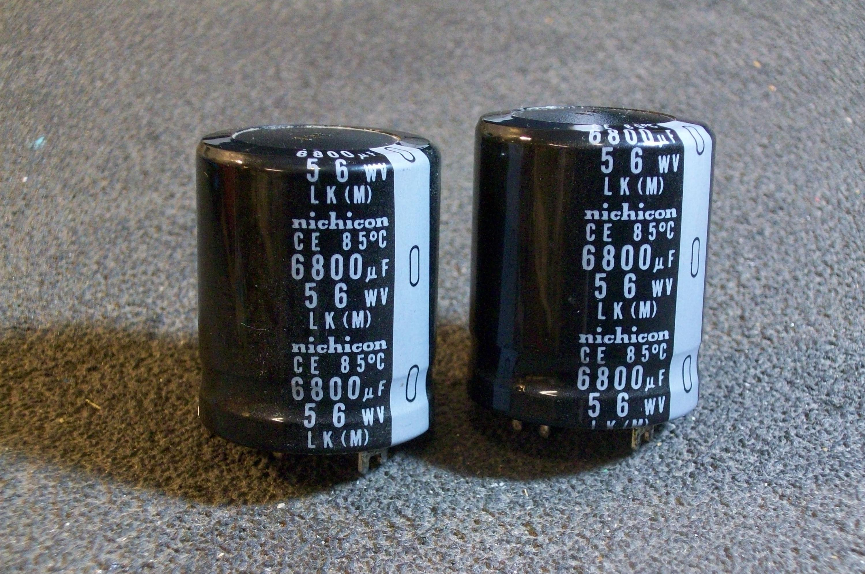

    Nichicon 6800uf 56wv CE 85c replacement
    I can find no specs on these caps. They are bulged at top and test bad. Date code on top indicates 1993, so it's no surprise.
    Tests (OOC):
    4982uF .05 ESR
    5469uF 0 ESR
    They are from the PSU of a Sony STRD611 stereo receiver.

    3800ma general junk.

      Not surprising. Thanks. I did look for LK series in Nichicon but couldn't find anything.

        The terminal style (one terminal offset 90 degrees) corresponds to Chemi-Con terminal code LI and with the current series of Nichicon snap-in units, I cannot seem to find units with this terminal style, although Chemi-Con still makes units with the aforesaid terminal style.

          BTW, looks like the Nichicon LS series is the current replacement for the LK series, but anything with 3 amps of ripple current, or better, should be fine.

              given the fact that newer caps will be smaller and you need a 10mm snap-in,
              i'd be looking out for something like 10,000uf at 63v

                  The LK series (and 105C GK series) are large can general purpose parts, but I wouldn't call them junk. They were very good for their time - introduced in the late 80s, IIRC - and for filtering 50Hz/60Hz. By the time this stereo receiver was produced the LK series had been superceded (IIRC) by the LQ series. Nichicon tends to be really slow about obsoleting older, popular, series.
                  Comparing general-purpose snap-ins to low impedance electrolytics is an apples-pears comparison, and snap-ins vs. polymer is an apples-pineapples comparison. BTW, the highest voltage rating for a polymer cap I've seen - not that I've looked recently - is 35V. Put one of those in a 50V circuit and you may witness a launch!
                  I'd suggest replacing this with the current 105C series part, which may also be smaller, improving airflow.

                    Before we blame the capacitor, are the rectifier diodes ok?
                    I find it odd both went prego, being reasonable quality filter caps in an audio amp.

                        they can do,
                        the good news is most of them have the same distance between the tabs - 10mm
                        so you only need to watch the diameter & height when ordering.
                        there are some exceptions, very large caps may have between 3 and 5 tabs, but only 2 are used - the others are just to hold it to the board.
