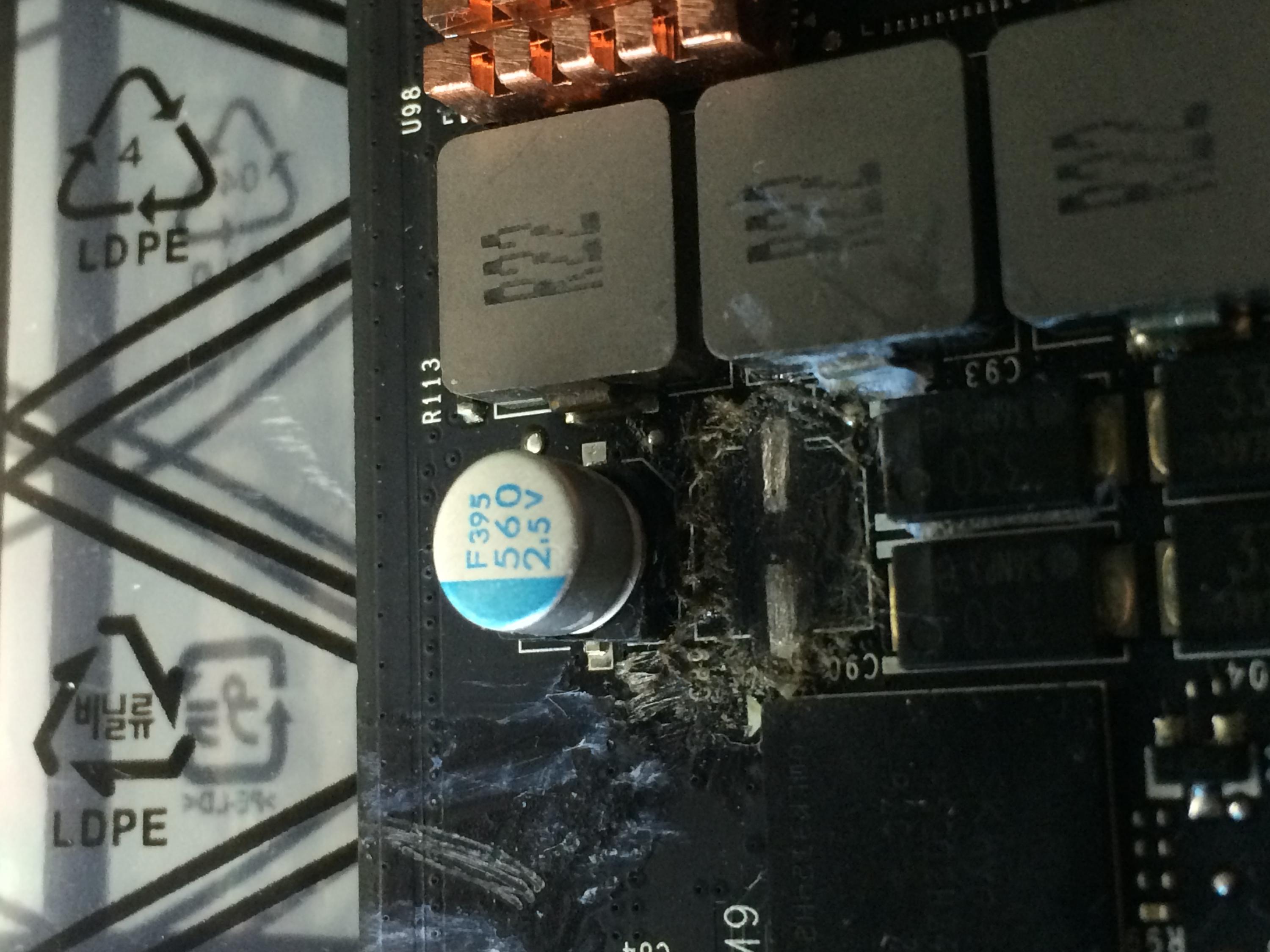

    Hello All,
    I've been slaving away googling on where to find a replacement for my capacitor. I stupidly ripped one off when replacing the stock cooler on my graphics card with the NZXT Kraken G10.
    Anyway, I've attached the pic of the bad cap. If you guys would help at least identify an exact replacement that would be great. I would just need all the specs of the cap, such as the microfarads and the voltage and all that. If you can send me a link to the exact one that would be even better! The coding on the cap is this in order from top to bottom: F395, 560, 2.5V
    It seems the cap is surface mounted and is about 6mm tall with a diameter of 5mm with a lead separation of 2.5 mm. Thanks you guys so much! I wouldn't ask if I haven't been researching for the past week.

    560uf 2.5v obviously.
    and almost certanily a polymer cap.
    next time you post a foto, dont use a gameboy camera!!!

      Haha I didn't use a game boy cam! It was from an iPhone 5S, I guess only a thumbnail got uploaded?
      Question, should I ignore the F395 on the top? I can attach a higher quality pic if you want. The cap is Surface mounted too.
      Thanks again!

        a better foto may help others ID the make & series.

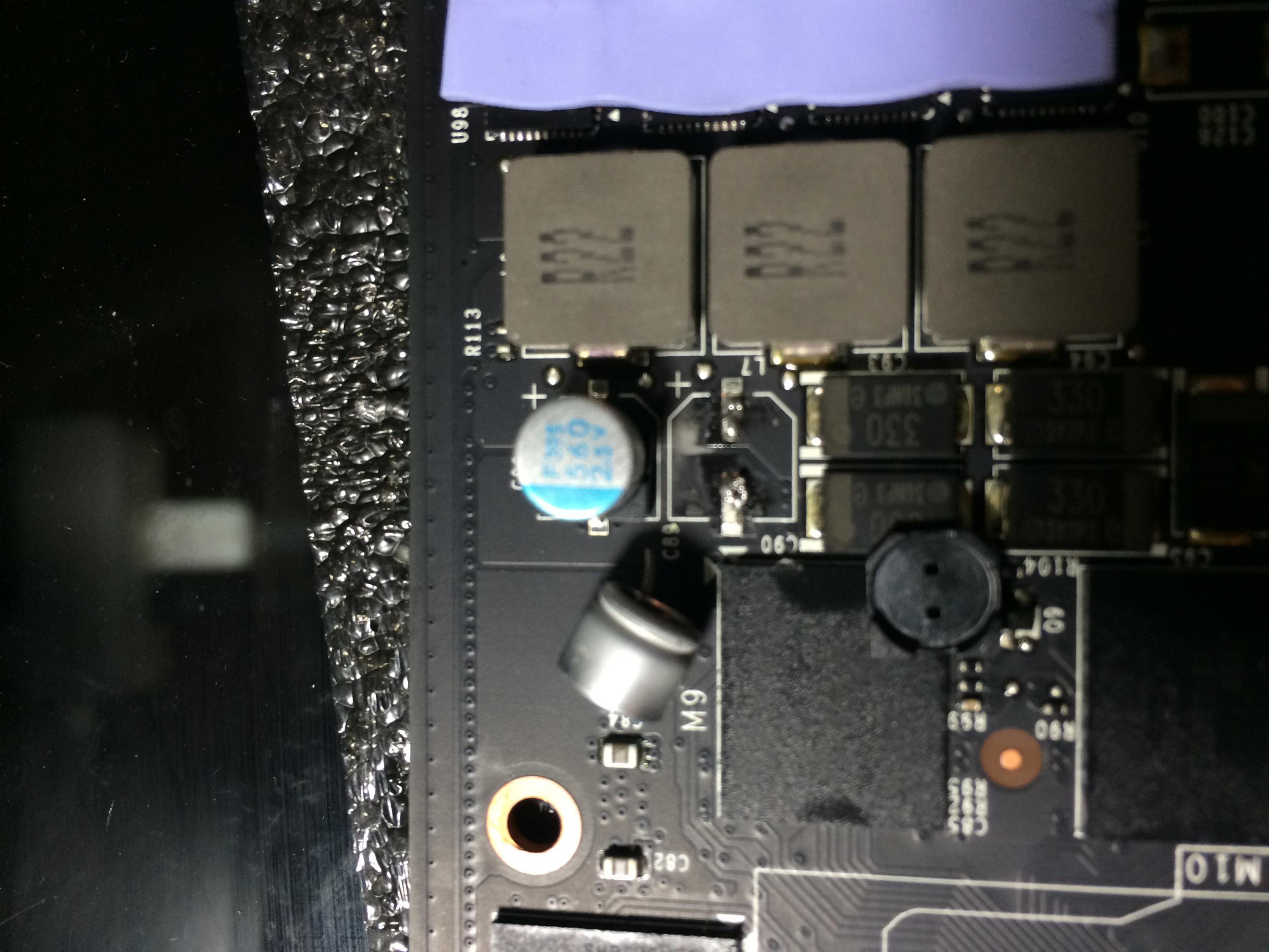

          You're right. Here's a way better pic.

            This might do?
            http://www.digikey.com/product-detai...9CT-ND/4204336
            But you really need the land size and diameter for a smd cap not the lead spacing as that does not figure. ( unless of course you are going to try surface mounting a through hole one?)

              if you look at the space on the board, it looks like it may be drilled for both types - maybe.

                No it's not both surface and through hole, I wont attenmpt to mount a through hole one in a surface mount. How do I measure the land size? In fact what is the land size?
                Will this do too? http://www.mouser.com/ProductDetail/...qtMK41m06qA%3d
                I would prefer buying from these guys since they're local.

                  Land size is the size of the base. (mentions it on digikey site)
                  You need to measure the base and check the data sheet.
                  The one you link to according to the data sheet is F61 so is 6.6x6.6
                  the connectors appear to be 1.9 apart so perhaps yours is a larger one??

                    Hey guys, I went ahead and ordered the caps from the link from Mouser.com. They turned out to be exactly what I needed; the land size, height, and diameter were a perfect match.
                    Just one thing, the topmost numbers are different; on the original one the numbers is F395, while on the new ones, the number is K28J. Should I be worried? What does that number mean anyway?

                      only thing matters is the capacitance and voltage in that application. It's Chemicon so its a good cap

                          That cap is part of the switching power supply (see those inductors next to the caps?) filter cap, do not use just any cap.
                          The one FlyingMammalMan selected is the correct type low ESR/Impedance type not general purpose type.
