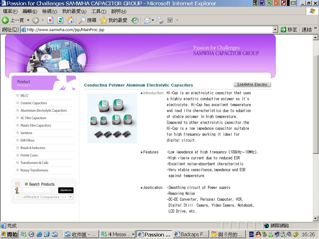

    What brand are these new polymers?
    http://forum.coolaler.com/showthread.php?t=160049
    Recently, Gigabyte has been advertising DS with solid caps. However, these new solid caps doesn't seem to belong to any of the Japanese brands.

        It is Korean brand "SAMWHA" polymer FB series.
        My SAMXON Capacitors Database HERE!!
        X-CON is a new brand for SAMXON's Polymer Capacitors.

          It is the latest radial type polymer series of "SAMWHA", there is no datasheet to the public now. However, I am sure this matter, trust me.

            I just searched google, and got the datasheet!! Now, enclosed here for downloadng.

                        It's weird that the data sheet shows the series name printed on the cap is only a capital "F" while the series name on Gigabyte motherboard is "FB".

                          The photo of caps will different from the real product in market without any notice by factory, it doesn't matter. Please refer their web site for more details and photos, then you should understand why i sure those are SAMWHA polymers.
                          Also i have checked some web sites in China(of course language in Chinese only), there are suppliers to make advertising there that "We are dearler of Samwha, and selling Samwha polymer FB caps....." So, i am 100% sure this matter.
