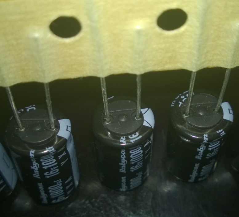

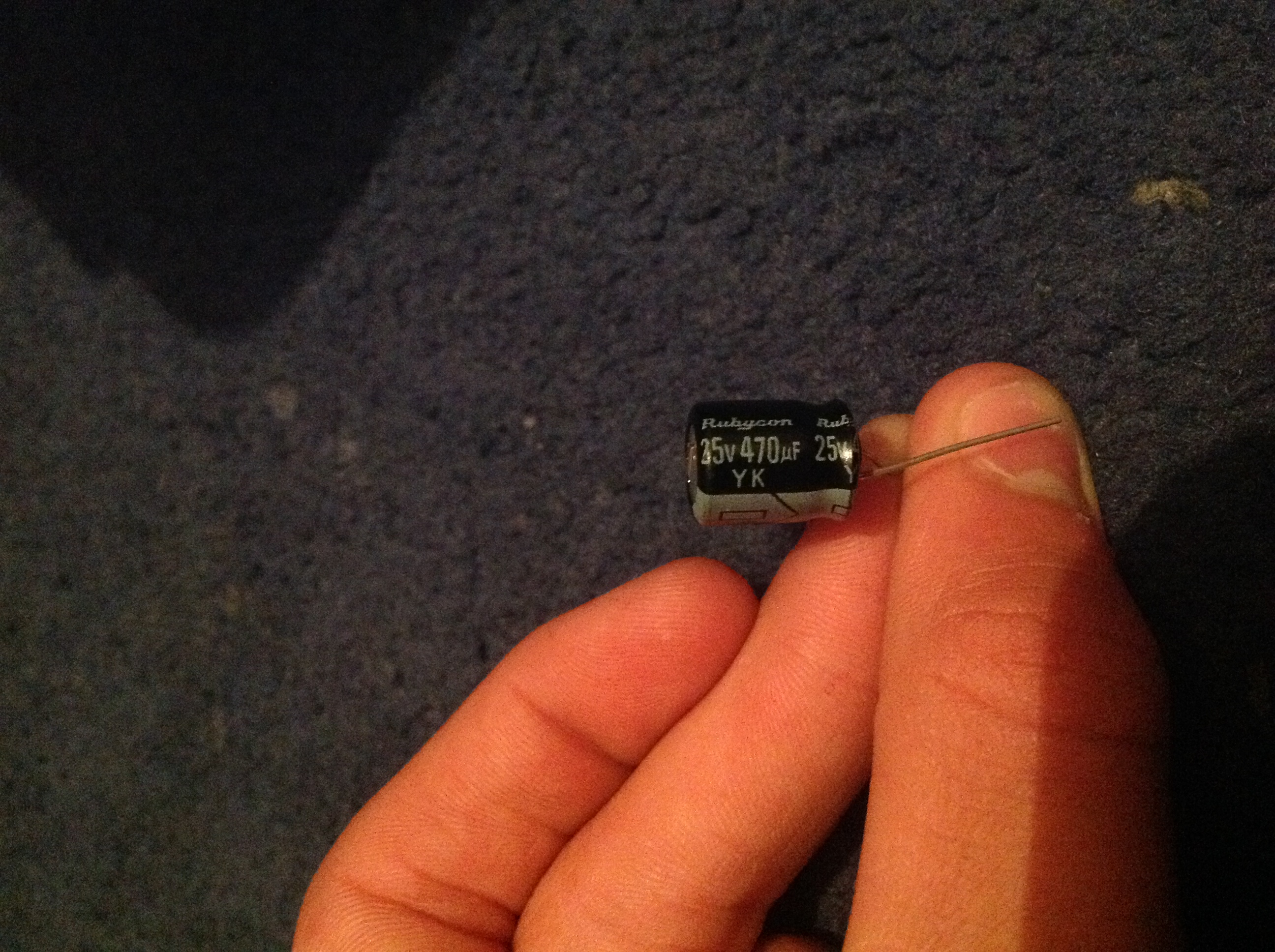

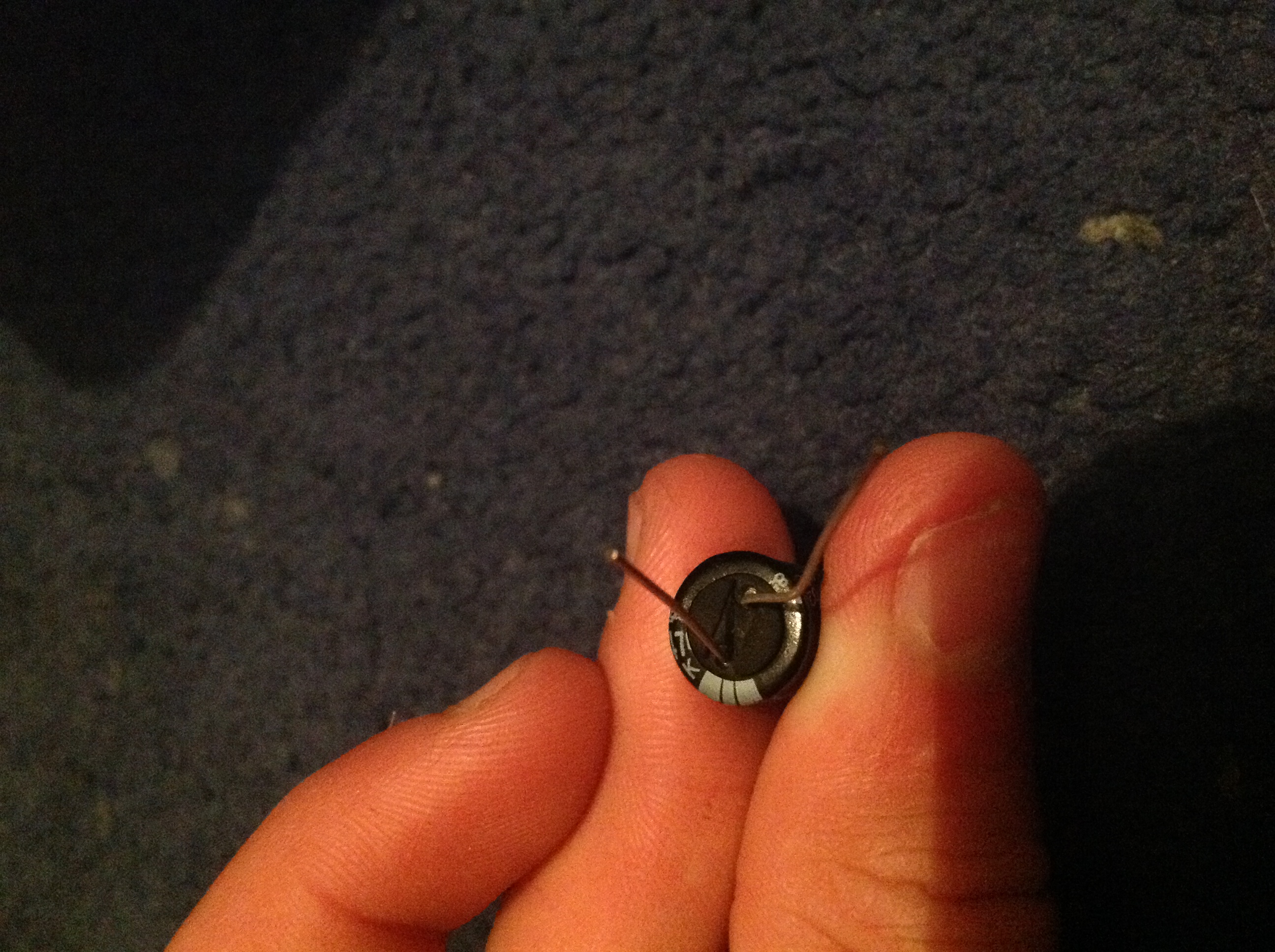

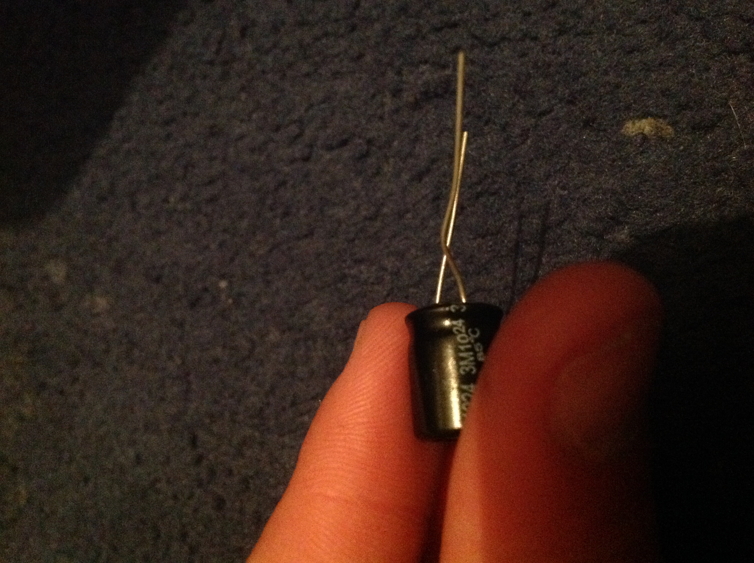

    What do real rubycon yk look like ?
    Hello everyone lately I have notice a very common issue that I have been coming across with rubycon yk series I ordered supposedly "genuine" from a few different sites to get the values I needed but all seem to be of the same quality and I don't feel that they are genuine. The print is ok but not rubycon standard and the bung isn't the usual rubycon type, they measure fine on the esr meter but I would like to know what you badcappers think as I don't want to use these until I can be sure of them.
    Also I have looked these up on-line and they all seem to be the same so I don't know what to think.

    Pretty sure they are fake... The bung should have a dot in the middle, and printing looks bad.

      Hello thank you for the reply, I know that the bung looks fake but its the same on all rubycon yks ?

        Confirmed these are fake junk.

          I have a bunch of YK's I had salvaged off an old plasma TV board long ago. The 16v capacitors I have definitely don't have that dot in the center of the bung but it otherwise matches. I do agree though.. the sleeve printing looks really shoddy in the fakes. The Y and K are spaced too close together and the F in uF is too tall as it's normally about 1/2 the height of the capacitance value.

            I Have confirmed that they are fake they capacitance is correct but esr is too high for that series, put them in the bad cap bag.
