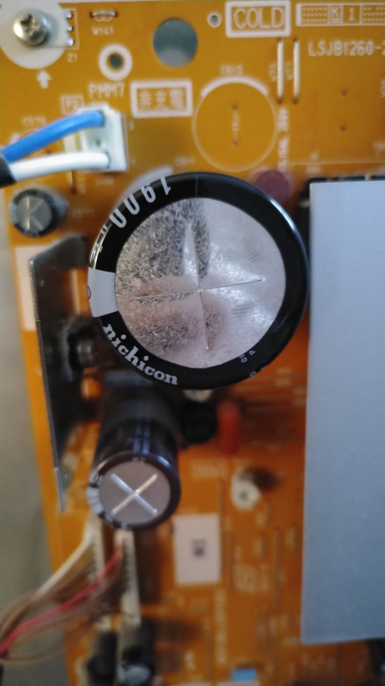

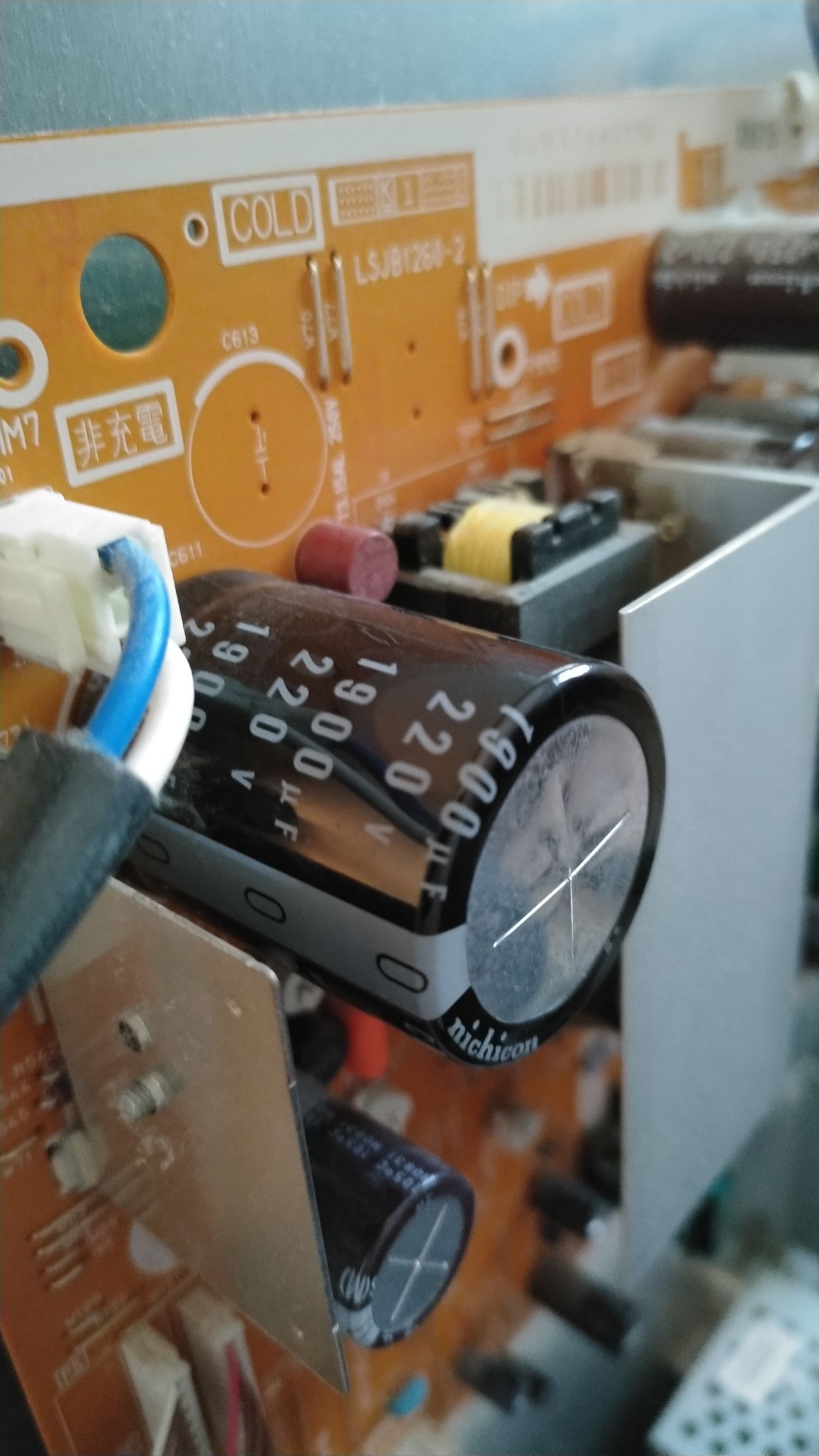

Having a hard time finding one of these in stock anywhere.
Where to find capacitor for Plasma TV - 220V 1900uf?
It's 17 years old. It did it's job. All it says on the other side is:
nichicon
CE 105C
C U (M)
I did eventually find something on Digikey that had the same specs. https://www.digikey.com/en/products/...KA54M/17728518
That was the only 1900uf 220V snap in capacitor in stock I could find anywhere on the internet. I'm hoping that is good enough to get the TV back up and running. I would like to get another nichicon for longevity but I can't find them for sale anywhere.Last edited by SluggerB; 06-03-2025, 08:07 AM.Comment
