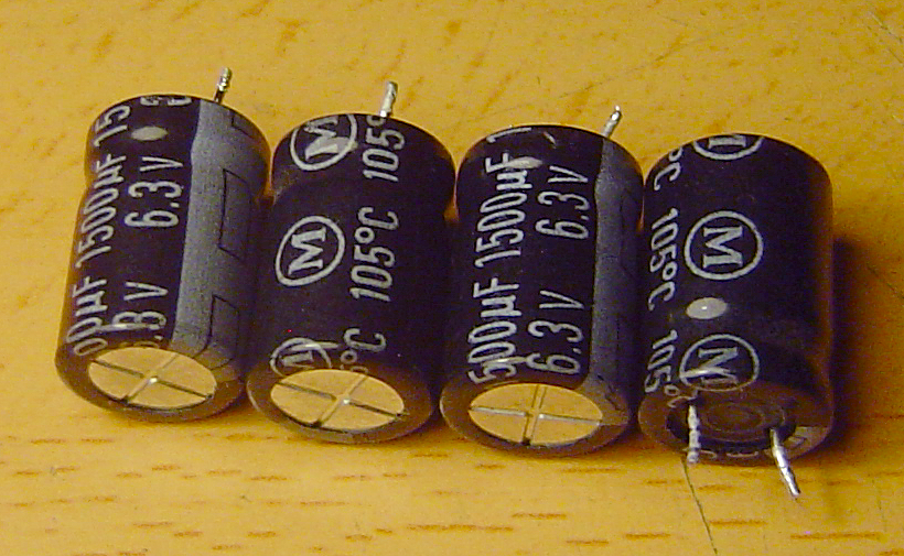

    Which cap brand is this?
    Extracted from a ~1999 440BX mobo:
    I suspect they're not Panasonics .
  • mariushm
    • May 2011
    • 3799
    Re: Which cap brand is this?
    What would make you think they are Panasonic, the M?
    M is standard code for the tolerance, +/- 20%. The M in a square with rounded corners on Panasonic capacitors is short for Matsushita, the previous name of Panasonic.
      Certainly not Panasonic, even the vent is wrong. Could be one of the many OEM capacitors that came and went (setup for a short period then folded up). One good example I've came across would be Rifeking...
      That "(M)" logo may be actually the manufacturer logo (since its labelled prominently), rather than tolerance code (as everyone in the capacitor business knows that high capacity electrolytics are mostly +/-20% tolerance, pretty standard knowledge)...
        Some unknown forgotten crap cap maker then I guess. The smaller caps were also crappy D.S. ones, it's amazing the mobo still worked OK after 14 years (although a couple 'M's were starting to bulge).
