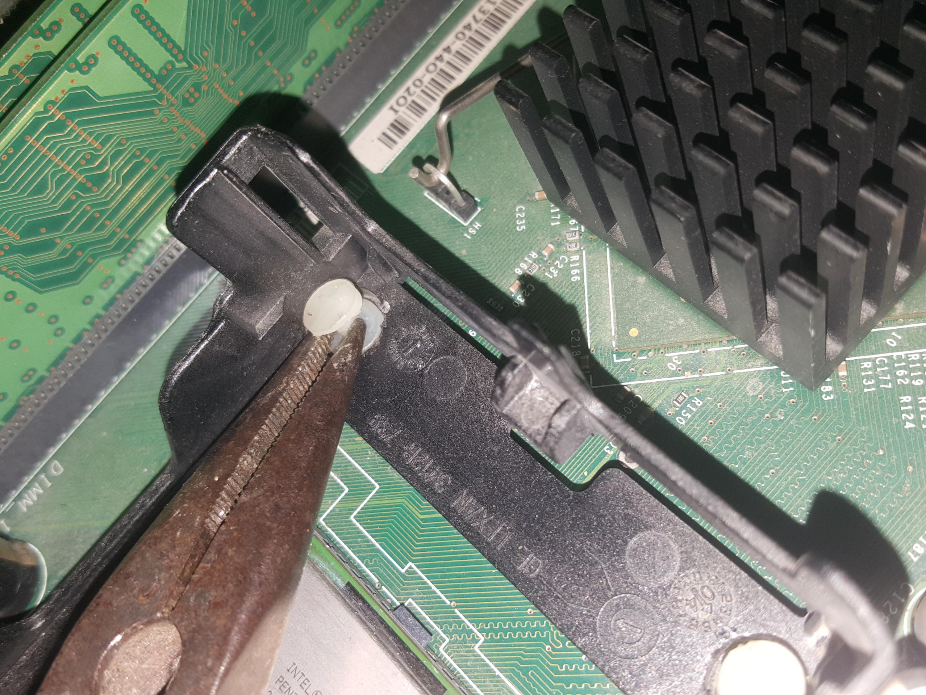

                Re: Need help removing metal plate from bottom of GX270 board
                push the white pins out from the bottom.a small screwdriver will do.
                then pull the retainer off the top.
                  What kc8adu said ^
                  The white pins can be a bit of a PITA to remove sometimes, but that's how it's done. If you happen to break any of the white push pins, just substitute some proper sized screws in their place. That's what I did for mine (the first GX270 I tried).
                  You can see the results in this picture (top left corner of the heat sink bracket):
                  https://www.badcaps.net/forum/attach...8&d=1334645782
                          Adding information into this ancient thread because it seems like the only freaking place on the Internet discussing the removal of the Dell Optiplex GX270 heatsink retention bracket (Plastic piece is P/N 5Y747, metal piece is P/N 2F402). (There you go, Googlebot, hopefully that's enough keywords.)
                          I had to destroy the white plastic push-pins entirely - they were too tight a fit, even after popping up the pins (from the top of the mobo) using a screwdriver. First, with the mobo upside down, I cut the plastic tips, then removed material from the center of the "pin" with a manual hand drill (a very basic one - just a drill bit with a hand grip on it). That gives the pin enough room to deform - eventually some downward force with the same drill allowed me to push the pins through the board.
                          The metal bracket isn't glued on (in this case). There's a plastic insulating film that has some adhesive that sticks it to the mobo, but you can just fold and tape it out of the way while re-capping.
                          I may have missed an easier way to do it, but this is the way I found....
                          [edit] Oh, and you need to replace the push-pin with a screw (or maybe screw and nut). Will update with specifics.

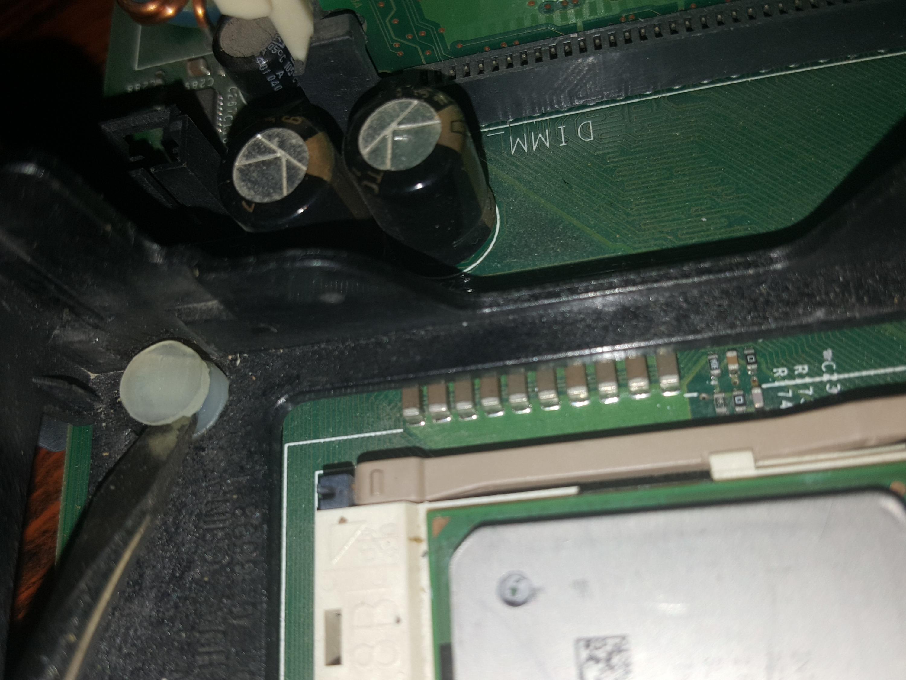

                            Oops, took too long to edit.
                            To re-attach, I used M4-.7 x 10MM screws with (M4-.7) nuts. (Alternatives exist.) Couldn't find a screw that had threads that could grab the plate precisely, and I would guess the tolerances probably vary too much from plate to plate anyway.
                            (You *can* manage to push out the pins from the bottom without drilling - but it requires way more force than I'd be comfortable recommending. Plus, they don't really hold properly if you try to reuse them, probably because of the bit of plastic that you need to cut off to get at the pin.)

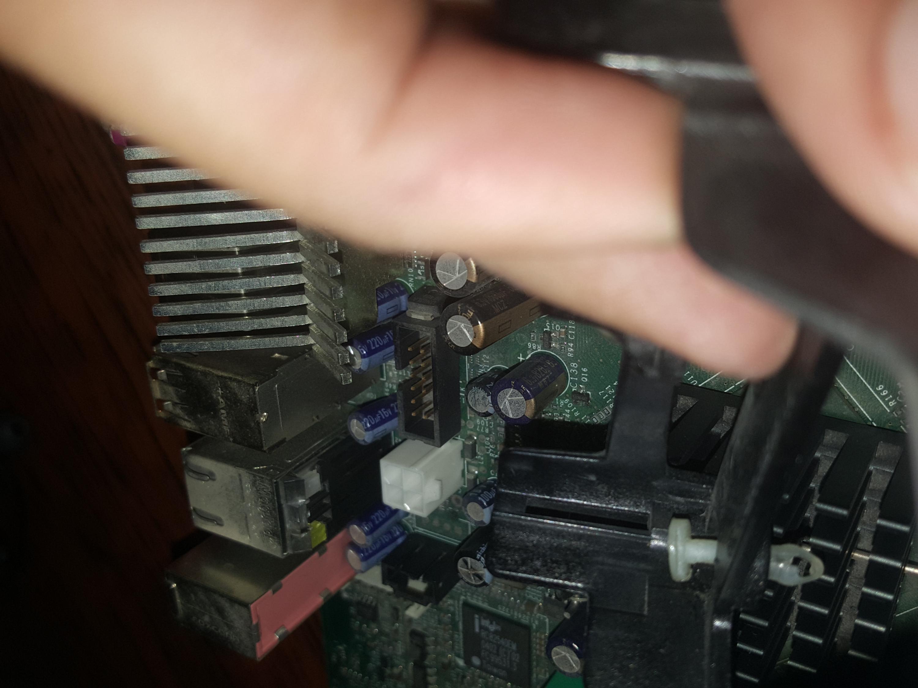

                                old post hope u found out solution. just got pc with bad cpu capacitors and faced same issue as urs so stumble upon this thread in search of solution
                                here whay i did. motherboard facing up used screwdriver to pull up those white studs enough to use needle nose pliers anf pull forcely upwards. done without damaging anything
                                hope this help
                                  hope this help
                                  stud should be pulled halfway. pull whole frame once all four done.
