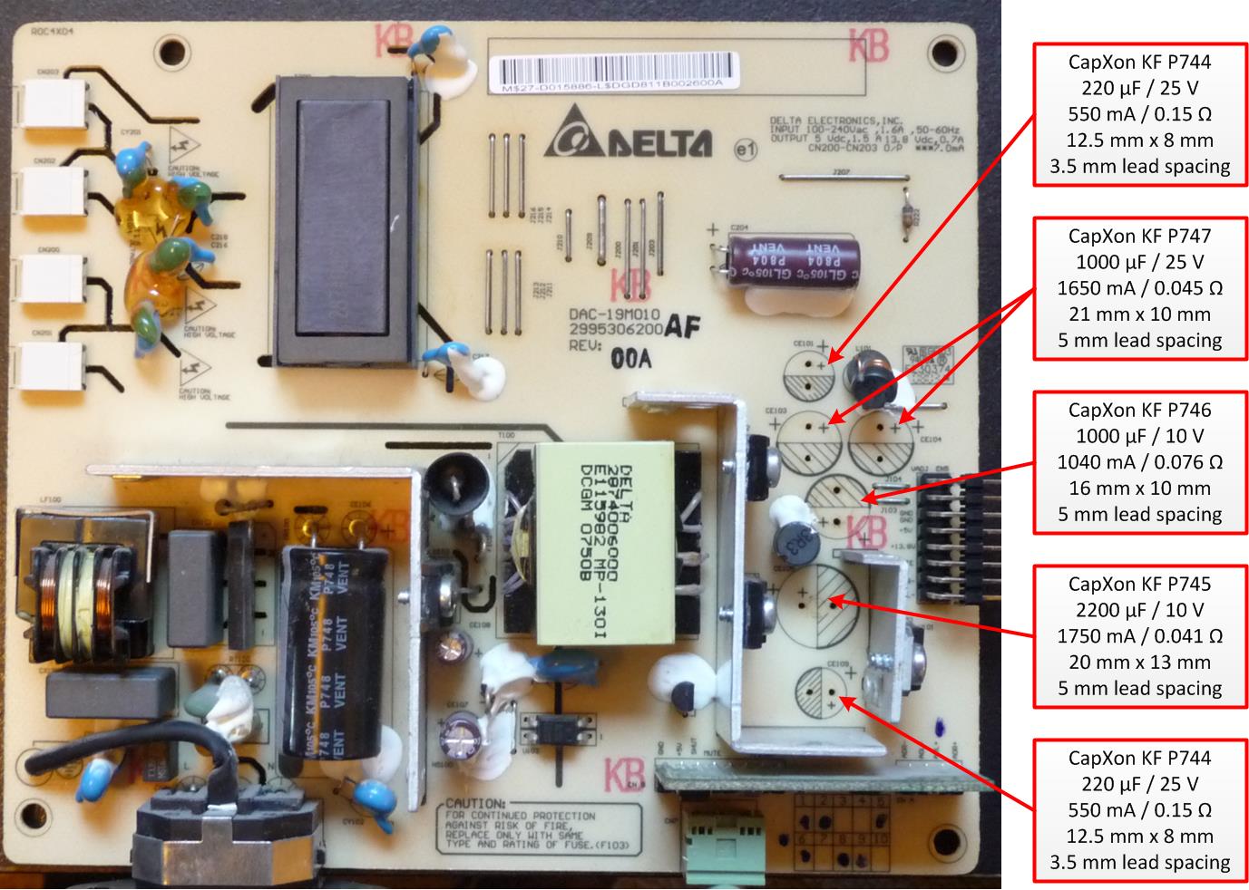

    So I'm here because when my monitor died, I vaguely remembered reading something on the internets about bad caps in TVs--my memory was that a couple of cheap caps failing was causing people to throw their expensive TVs away and buy new. It occurred to me that the same was probably true for LCD monitors, as they're basically the same thing.
    The monitor in question is an off-brand el-cheapo special from Micro Center. It's 21", and it was only $99 two or three years ago; I'm probably lucky it worked as long as it did. Economically, it's not really worth fixing (and it's already been replaced), but that's no reason not to try
    The caps in question are from the power supply board. The monitor started having problems waking up from power save mode, and eventually refused to wake up at all.
    After taking it apart, there was one cap that was clearly bad, but I went ahead and removed all of the smaller ones on the same side of the board. There are two still left on there (see the attached image), but they're glued on and I'm afraid of breaking something before I actually get to try to fix it. If it's really not difficult to remove them and you think it should be done, go ahead and say so.
    Anyway, I managed to identify all of the ones I removed; they're called out in the image, and listed in the table below. Each double row in the table lists the one that came off the board first, followed by my guess for the replacement. For the last one I listed, I'm really unsure about the replacement and left it for suggestions.
    So, how'd I do? (I'm fully expecting people here to have better suggestions, but I wanted to try before asking.)

    Those all look pretty good. For that last cap, a Rubycon ZLJ 25V 1000uF should be close enough. A closer replacement would be nice, but it should work. You can get them here.
    Those other caps, if they look okay, could probably be left for now. Primary cap failures are rare, and little tiny caps don't die often either.

      The date code on the main O/P transformer is "0746", the "P7XX" for the caps you listed is the parts' date codes, and I saw the date code on the cap that is laying down (and glued) is P804. So that power supply is probably 5-5.5 years old. Judging by that cap being mounted that way, I'm going to guess that height is a tight dimension where that P/S is located in the monitor, and cooling is probably marginal. Nichicon's PW and HE series are both excellent series; in that environment, I would recommend using PW rather than HE (and looking at United Chemicon's LXZ and Panasonic's FC series if you can't get PW parts with the right values and case size). HE should probably do just fine, especially if you don't drape shirts over your monitor, but PW would probably last a bit longer still (a difference, in the application, between excellent and reeeeally excellent).
        Wow. I amazed the monitor is that old. I know that there was probably a greater-than-usual lag between maunfacturing and sale because it seemed like one of those weird lots that discount retailers sometimes get, but still.
        You're correct; the power supply is mounted in the rear of the monitor case. It's a fairly tight fit, and all passively cooled. Because of the fit, case size was the final constraint that put me down towards the caps I chose. My basic method in narrowing down my choices was to use the Digikey site and filter by lead diameter (exact), ripple (>= spec), voltage (exact), capacitance (up to 20% above spec), and impedance (+- 10% from spec). That pretty much always left me with no more than four choices, and size was the final determining factor.
        Anyway, glad to hear that my choices are generally good. I'll get them ordered and update the thread when I have it put together.
            Huh? HE has a longer endurance lifetime rating than PW does. (2000-8000 hrs for PW vs 4000-10000 hrs for HE), and the ripple ratings are slightly higher. I would have thought that HE would last much longer.
