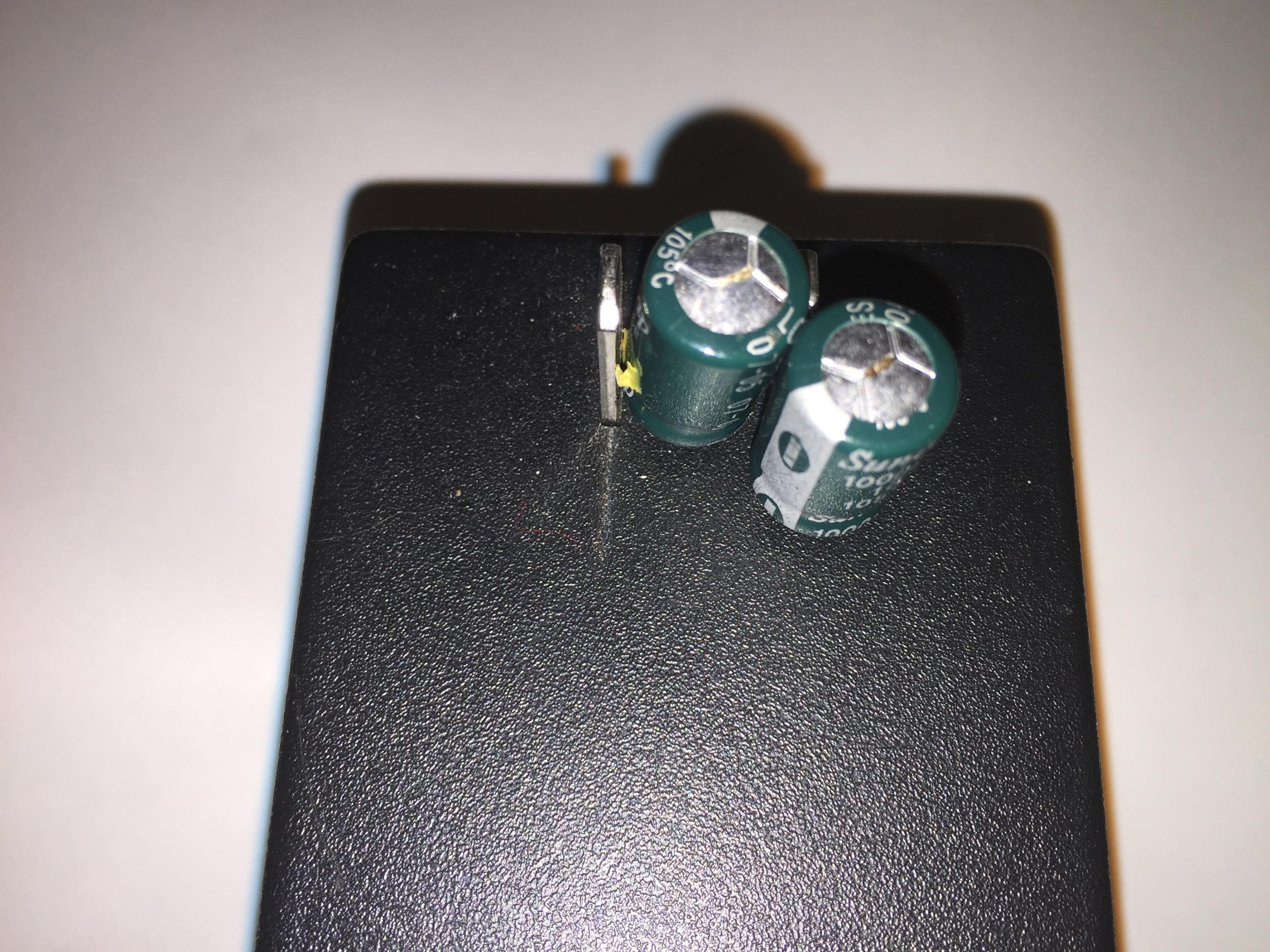

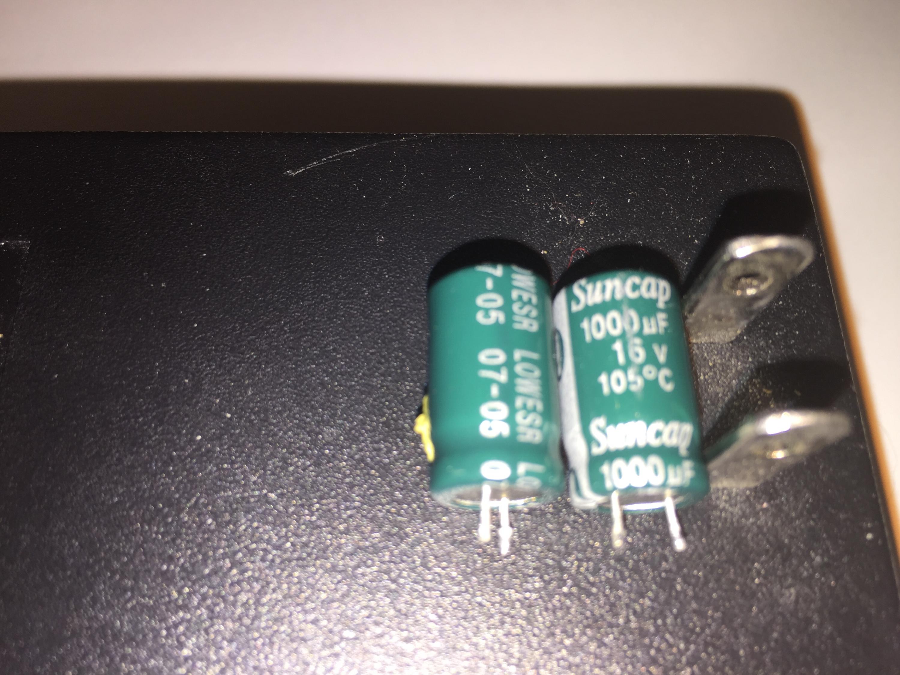

            i got the same caps out of a old power supply and they were dead
            the caps are 1000uf 16v "low ESR"
            #1 is the side view
            #2 is the top of the caps
            I'm not a expert, I'm just doing my best.

              "Suncap" is made by FU KEI ENTERPRISES CO. LTD. They were based in Taiwan. I don't think they're operating anymore. Their website went down sometime in 2011.
                oh at least they won't hurt anymore PSU's
