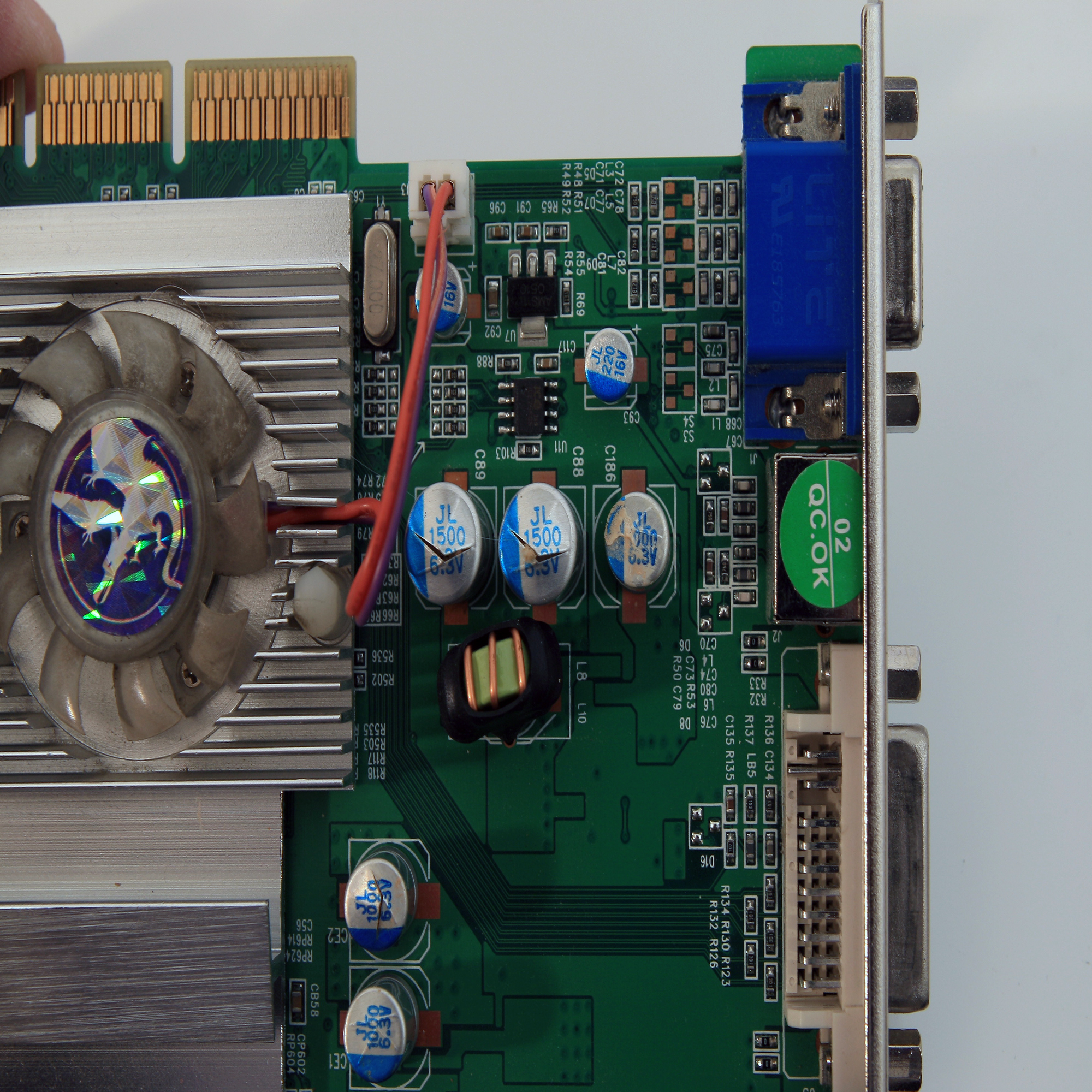

    Hello all
    I have a graphics card I would like to recap are these blown caps polymers or electrolytic caps>I would like to replace them with Panasonic fm,or fr series caps

    Re: Polymers or Electrolytic
    That looks like a cheap/old nvidia video card.
    I don't think it's worth using polymer capacitors on such a card, they're too expensive for this purpose.
    The capacitors used on the card weren't polymer capacitors in the first place.
    I would use Panasonic FM or FR capacitors, but I'd probably go with 10v or 16v rated capacitors instead of 6.3v, the price wouldn't be much higher.
      Yes it is a cheap old nvidia video card that I found in my junk pile
      I am going to us it to test dvi input on repaired monitors
      thanks for your advice will use Panasonic FM or FR capacitors, 10v or 16v
        jl?
        everyone knows fz are junk so lets call em jl?
        yes you could measure voltages and use polys but its a waste on a test card.as stated above fm/fr just fine.
          Well JL is on cap thie'r junk anyway. Will order fm/fr which ever is cheaper
