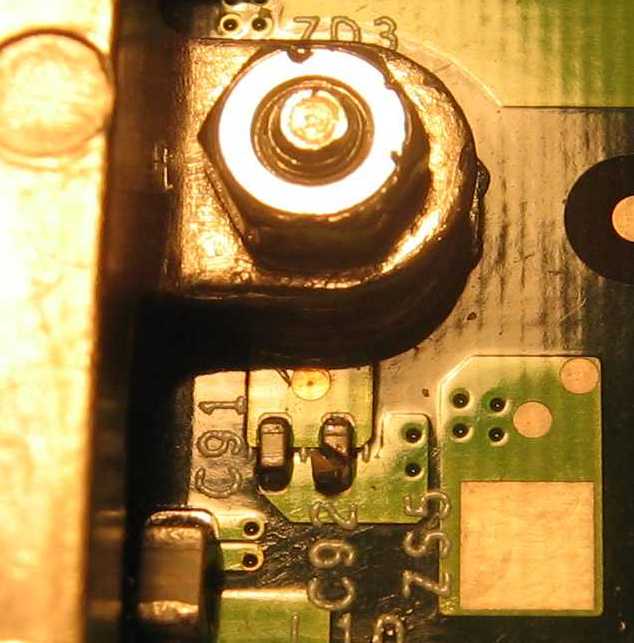

    OMG it's a noob. I asked around at Anandtech's forums if what in the picture below is a bad capacitor and what remedies there are for it. Got some good answers and was also referred here. Figured I'd ask again considering the expertise of this forum.
    Here's the photo:
    https://www.badcaps.net/forum/attach...tid=3889&stc=1
    The diameter of the hex nut thread is 2mm so the C91/92 caps are probably slightly under 1mm in size. My questions are, 1) How difficult would removing and replacing the cracked cap be & 2) What side effects would there be from removing the cracked one and bridging the connectors with solder? I'm pretty sure having no cap there and having a direct connection would be extremely bad for the motherboard, but what could happen from it? There's no markings I can see on any of them so I'm sure finding a replacement would be damned hard, anyone possibly know what ratings they could be?

    Finding a cap like that is remarkabley simple.
    Open up almost any electronic device, anything, if its broken even better.
    You will find a cap just like that, probably 20 of them.
    Yhe value is realy almost inconsequential, as long as looks just like the broken one.
    You would never want to short a cap, never.
    When you open up an old phone, stereo, whatever and see those size caps you will be faced with very small desoldering and resoldering.
    You should also know that the component shown broken is not a critical one, but if you have steady hands, replace it.

      It is probably a decoupling cap, wich shorts the noise to ground. If you short that cap, you would have a nice and havy short wich would burn some component beyond your repair ability. Caps are usually isolators for DC, thus one side is ground the other could be any voltage present in the circuit. As SMD ceramic capazitors are usually not marked, it is impossible to find the exact value. But ususally this is not that critcall on that particular purpose.

        i do agree with gonzo0815: the cap most probably for decoupling, so you'd better leave it as it is. if you really want to replace it you could go for almost any capacitance..if it's 0805 try to get 1nF.

          Thanks for the suggestions guys. Out of curosity I tested whether there was still conductivity through it with my multimeter last night and there is. Took me by surprise actually. Also when I touched one of the leads to the heatsink hex nut and the other to either side of the cap it showed conductivity. I'm thinking I should just leave it alone and not try to replace it.
