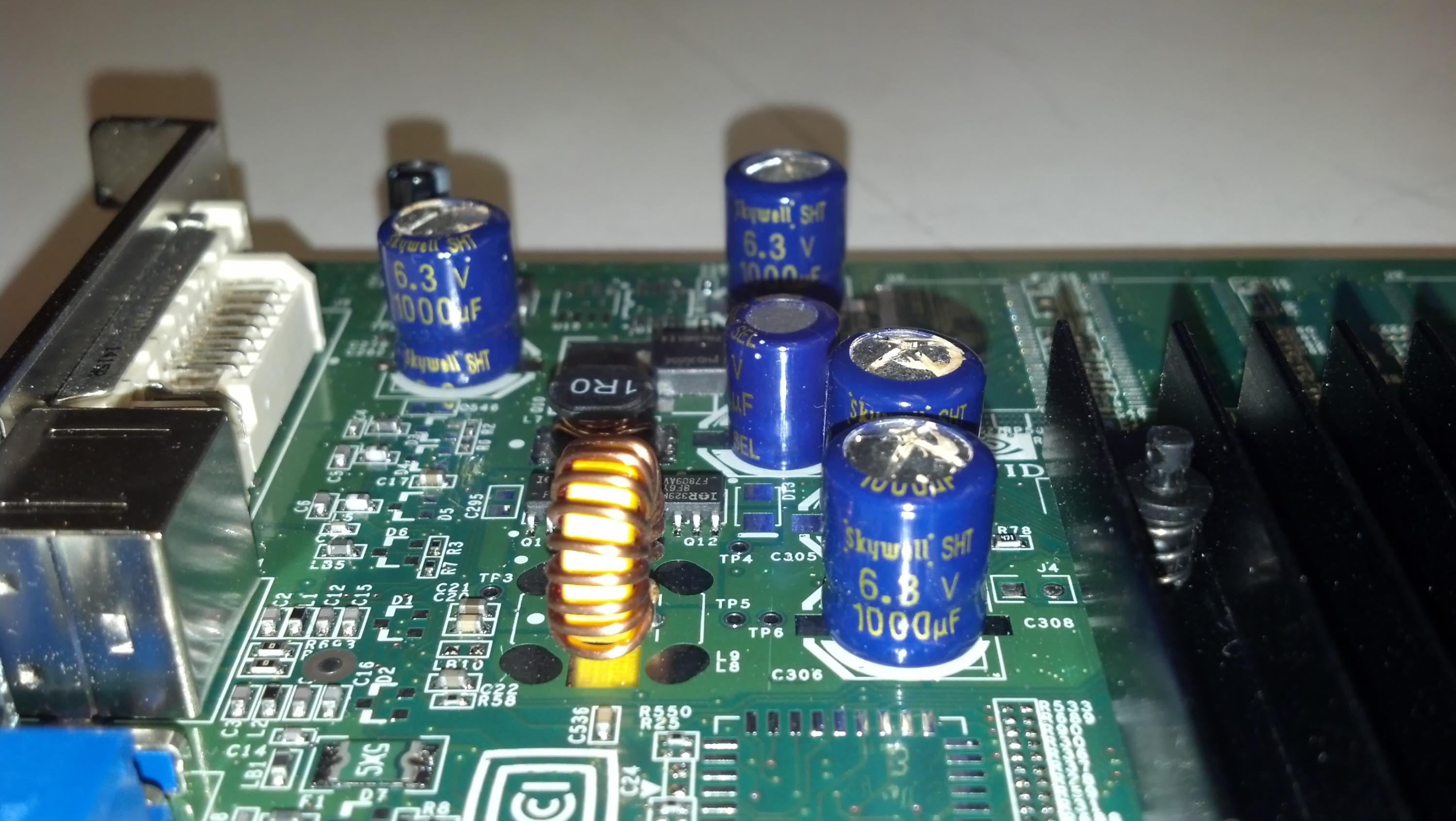

    I have a video card here with crappy Skywell caps, and one of the lytics is a strange value, it's 510uF 4V. I should be able to replace it with a 270uF 4V poly cap right? the polymer reads:
    ULR
    4V
    270
    YZ

    use the 560@4 sepc sanyo in the store.that one may actually be a poly.
    post a pic.most skywell i have seen were series sht.
    used to joke that they saved a fraction of a cent by leaving out the "i"

      There are 5 Skywell caps, 4x 1000uF 6.3V (SHT) and the 510uF 4V cap is SEL (The one with no vent) Yeah I agree, they are shit That one in the back is a lonely nichicon VR...

        I'm with kc8. I'd just go with a 560
