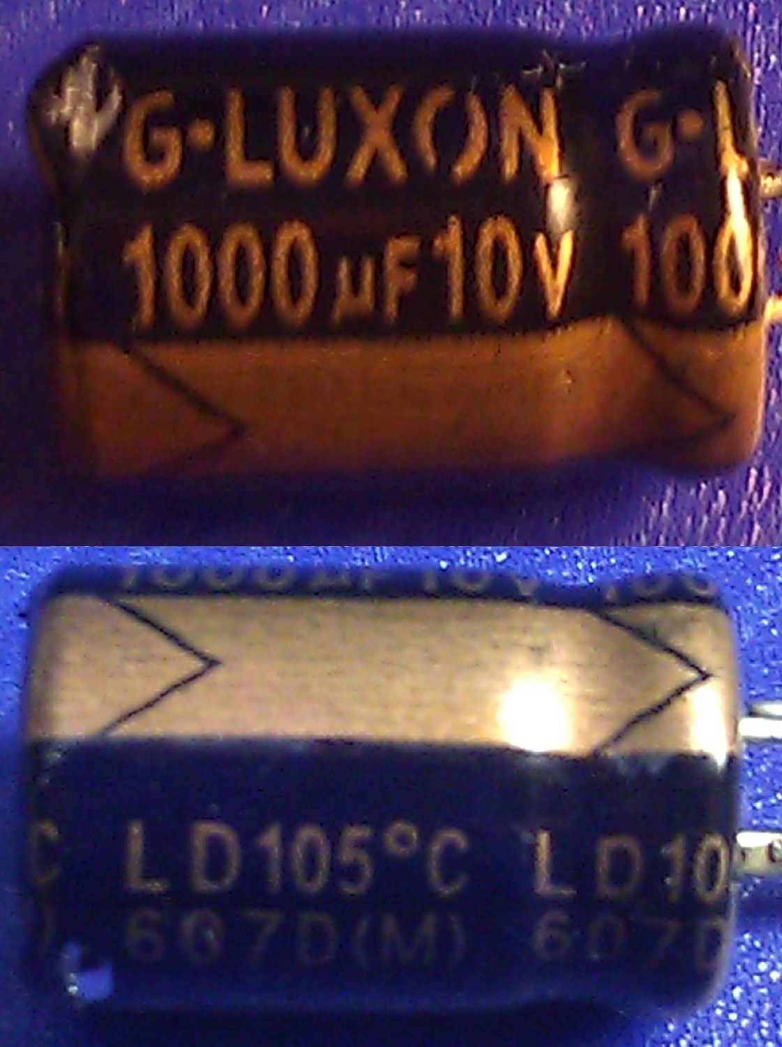

    I have identified a bad capacitor in a power-supply (produced in 2006), and I'm desperate to find the datasheet for this old G-Luxon capacitor. It is claerly marked with "LD105°C" which indicates a capacitor in the LD-series. The problem is that I cannot find any reference to any LD-series of capacitors from G-Luxon.
    Does anyone have an old LD-series datasheet downloaded (or printed)?
    I would very much appreciate if you could share it with me (and others).

    Re: Datasheet for G-Luxon LD-series needed!!
    Nope, unfortunately I don't have it.
    I (and a few other members here) have a large collection of datasheets, mine is available here :
    ftp://helpedia.com/pub/temp/datasheets/capacitors/
    This pdf below suggests what Luxon capacitors should be used to replace capacitors made by other brands:
    LD appears there as ELD often along with ELZ (LZ series). So this may suggest LD is comparable with LZ series from G-Luxon.
    Rubycon JXA , Nichicon PM are among the ones they recommend LD for, and that sounds about right looking at the LZ datasheet.
    Look at LZ series datasheet or Rubycon JXA and replace with something similar.
      I have attempted to attach the Data Sheet for the G-Luxon LD series. (My friend had to go back to a 1997 catalogue to get this.)
