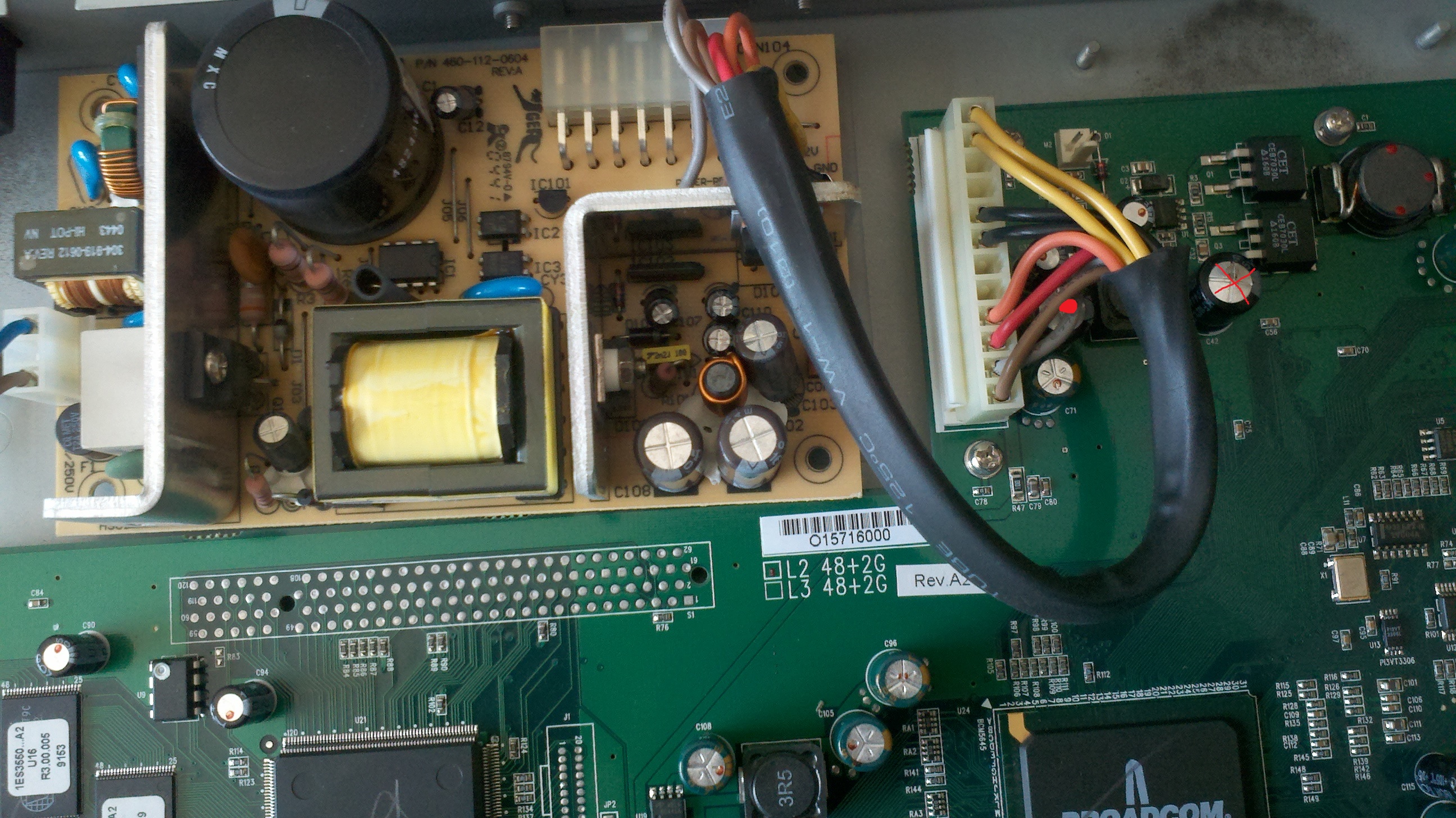

    hi, i have a switch here with a dead cap on the main board. It's a capxon kf series 470uf 25V. i dont have any of those caps but i do have a 330uf 25V KY cap. should that be good enough? the capxon cap has 1200 ripple and the KY has 865 ripple

    No, you don't want to go down in capacitance and ripple. For test purposes, it may be okay to use, but not as a long term fix.

      aren't capxon usually over spec'd though? would it be possible to go up on capacitance and ripple, but down in voltage to like 16V? thanks for the useful link!

        Capxon, no doubt, from all the pictures, stories and my own experience make terrible quality caps. I can't complain too much because all my equipment has come from previous owners discarding them as "not working".
        However, the "good" Capxon ones that I removed all test around their stated capacitance value on various multimeters. I don't have an ESR meter so I don't know about ESR values.
        So based on my own limited experience and sample size, I would say they are not overspecified.

          If the input to the switch is 12v or lower, you can use a 16v cap. If not, you need a 25v one.
            How do I know if the input is 12V or lower? do i look on the specs of the switch's power supply or on the bottom of it? all i can see for input is 100-240VAC?

              It is a wallwart type supply, right? It plugs in the wall socket, and has an output plug that goes to the switch. In that case, check what it says for "Output". Also, it would be wise to crack it open and check it for bad caps as well.

                yeah, it takes a regular power cable like for a desktop computer. the power supply in it says "DC Output: +12V===5.0A" So a 16V cap should work on the mainboard? I can post a pic if you want.
                Although on the power supply, i think i should do a preventative recap by replacing the capxon's on the secondary that are "good"

                  Alright, i get it, it's got an internal power supply not a wall wart. Yes, you can use a 16v cap in this case.

                    Thank you very much for the replies
                    Here's a picture. The red X is the cap that is dead and the one with the red dot is a cap of the same capacitance and voltage that I will also replace. Also gonna replace those brown capxon's cause they probably don't have much life left!
