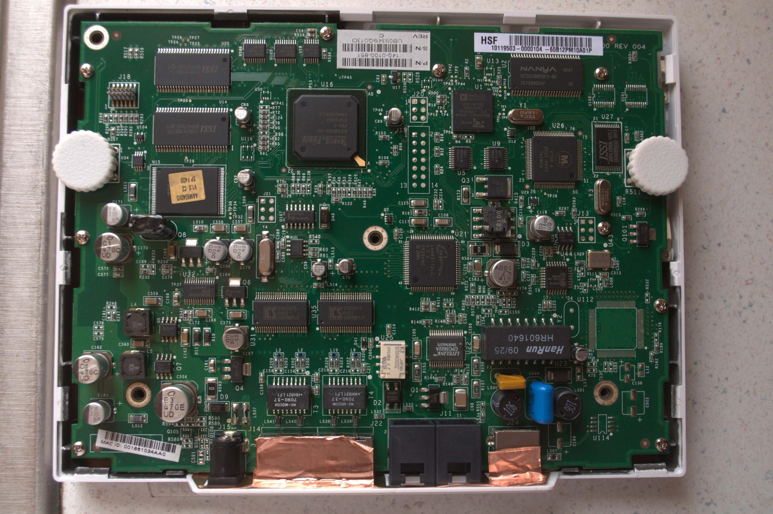

    How to read these CAPS?
    Please have a look at my pic. These are SMD devices and maybe you can confim how to READ the values and rating? For instance is C556 a 470uf? And does the E mean the tolerance? or perhaps voltage rating? This circuit runs at 14V (approx). What doe E3 and UD mean ? Thanks for any insight someone can offer.

    The one you point at is chip type electrolytic capacitor.
    With polymer capacitors, the most common feature is that they don't have those grooves/cuts at the top because there's no electrolyte to cause pressure buildup inside. These ones do have the cuts so it's either electrolytic or functional polymer (a hybrid between el and poly).
    With surface mounted capacitors of this type (square) and polymer capacitors, the general notation is that the largest size number is the capacitance... so in your case for C556, it is 470uF.
    On very small capacitors where space is a premium, the last character in the number is the multiplier by 10 ... 471 = 47 x 10^1 = 470.
    Most brands store above this value the series code or a date code, and below it there's a voltage code or the actual voltage rating. BUT it could be the other way around.
    This brand stores a voltage code or the actual voltage (usually lowercase v, uppercase V can mean a code). You can see to the right C124 I think that's 4.7uF / 100V - that doesn't mean the chip is rated for 100v.

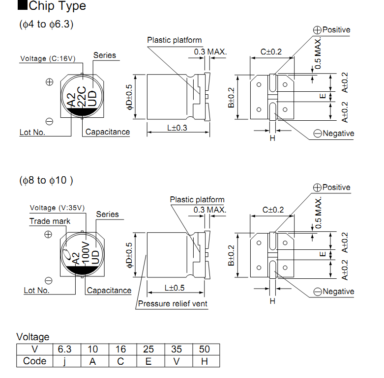

    Going to chip type capacitors here : http://www.nichicon.co.jp/english/pr...hip/pict_f.htm ... I can see about the middle of the page an UD series, so the UD is probably the series code, therefore the E3 could be the voltage rating or something else.
    Click on UD and you get a PDF with the datasheet... look on the first page on the bottom left.
    (click once to zoom it)
    Your capacitor is 8 or larger, so the second layout applies... you can see the digit below 470 is the voltage rating.
    So since your capacitor has an E at the end, that means you capacitor is rated for maximum 25v.
    And now you can go further in the datasheet and get the specs for your 470uF / 25v capacitor:
    10 by 10 mm , 0.09 ohm impedance, 670 mAh ripple.
