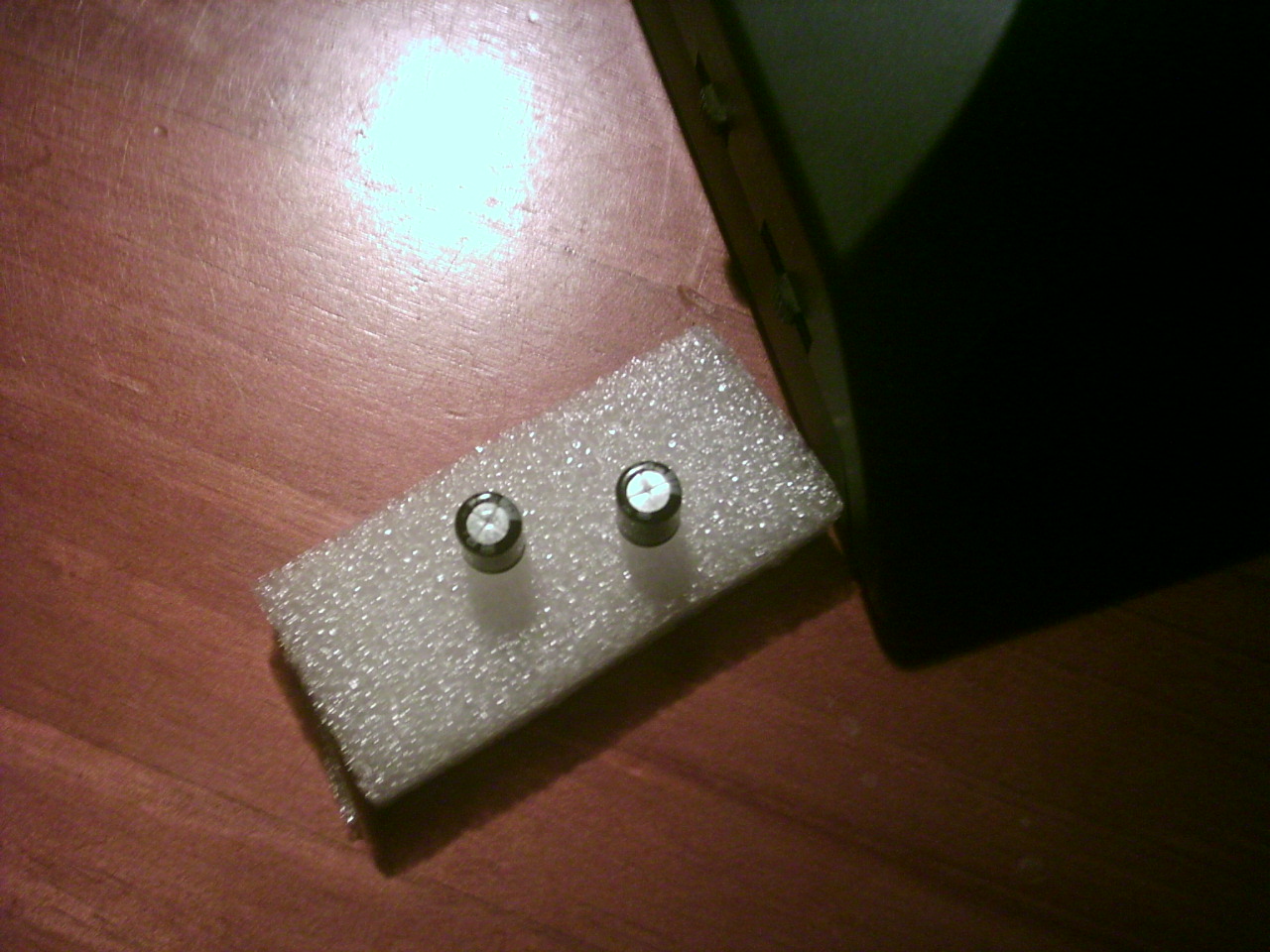

    As many members of these forums have greater experience with Tayeh capacitors than myself, I thought I'd pose this question...
    Is a visable dimple in the 'cross-hairs' of a capacitor a sure sign of venting? no fluid loss was noted (until I pierced it with a utility knife ) but the motherboard had been previously experiencing random but infrequent lockups/freezes...
    BTW the motherboard is an EPOX EP-MVP3C2

    Teyah is definitely a bad brand for failure. Post a pic, that'll tell the tale for sure.

      If the cap has bulged at all (even slight doming in the 'cross hairs', as you put it), the cap is usually bad already. Caps don't have to be spilling their guts out to cause problems on the system - I had a PSU with a very slightly bulged Fuhjyuu cap, and that caused constant reboots.
      You say there is a dimple in the 'cross hairs' - that's odd, as if the cap has collapsed in on itself rather than vented. Perhaps the cap has started to vent from the bottom, and the reduced pressure caused the top vent to start caving in?
      Tayeh are a notoriously bad brand, as bad as GSC. I have a PC with Tayeh caps, two of them are spilling electrolyte everywhere and yet the PC still works without problems! Like Topcat said, post a photo of the cap and then we'll see if it's vented.
      You know there's something wrong when you open your PC and it has vented Rubycons...

        Well, if it were bulging/leaking that'd make the diagnoses too easy!

          they look ok in the pic. time to break out the ESR meter or capacitance meter. Being they're teyah's, just replace them. they're crap.

            Oh... okay, I've already pulled them all
            That dimple effect @ the centre of the 'cross hairs' is not a feature I've seen on any capacitor before, I thought it looked a little suspicious
