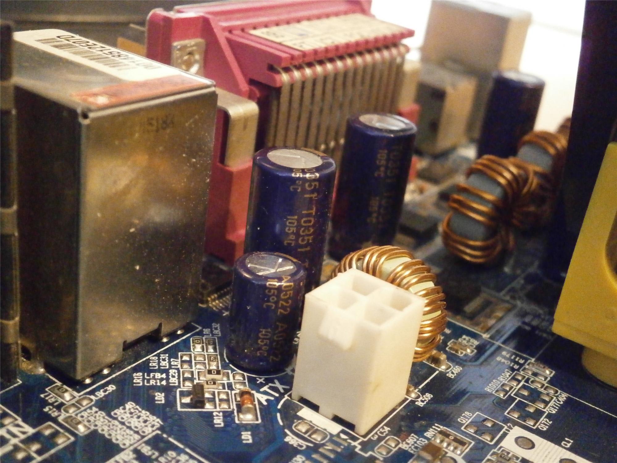

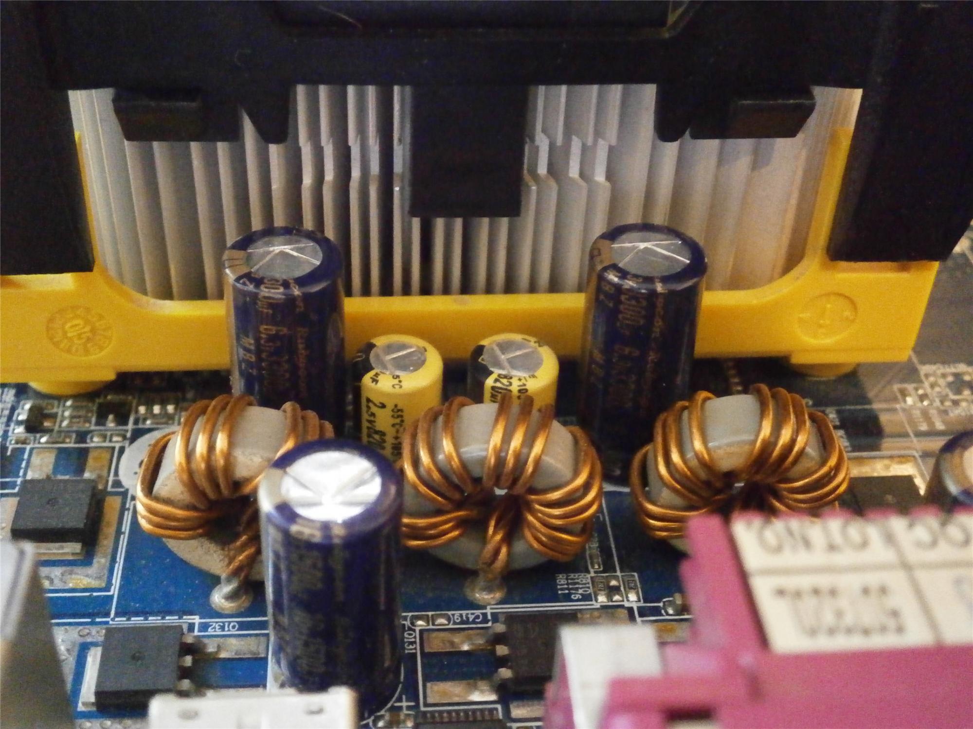

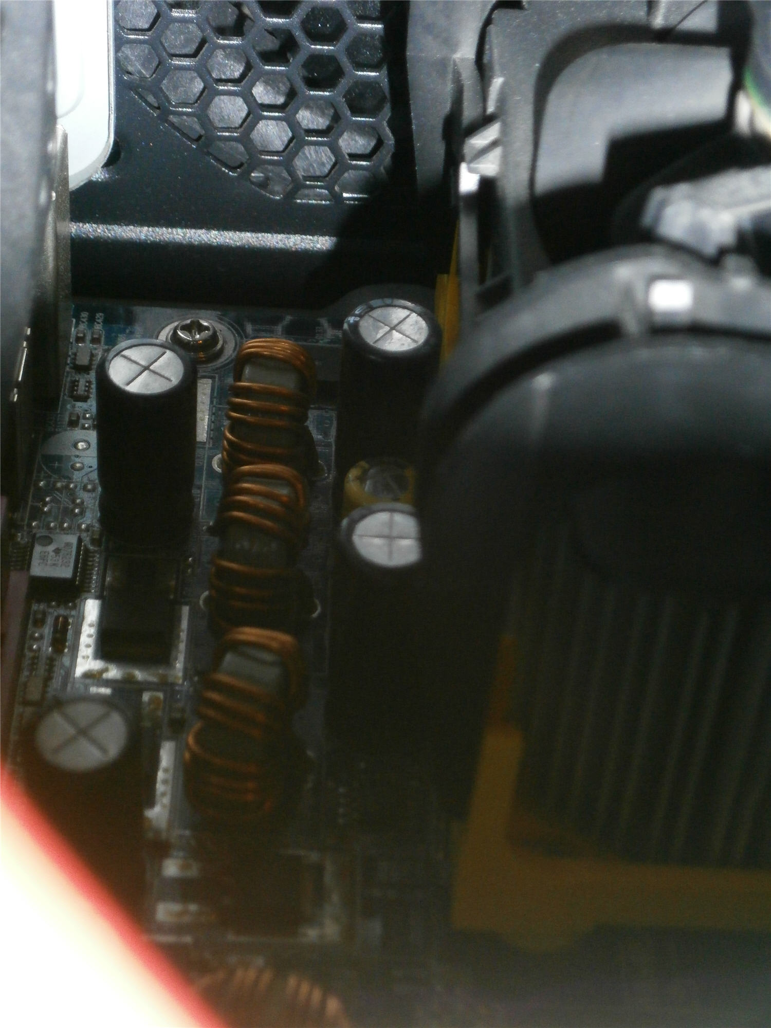

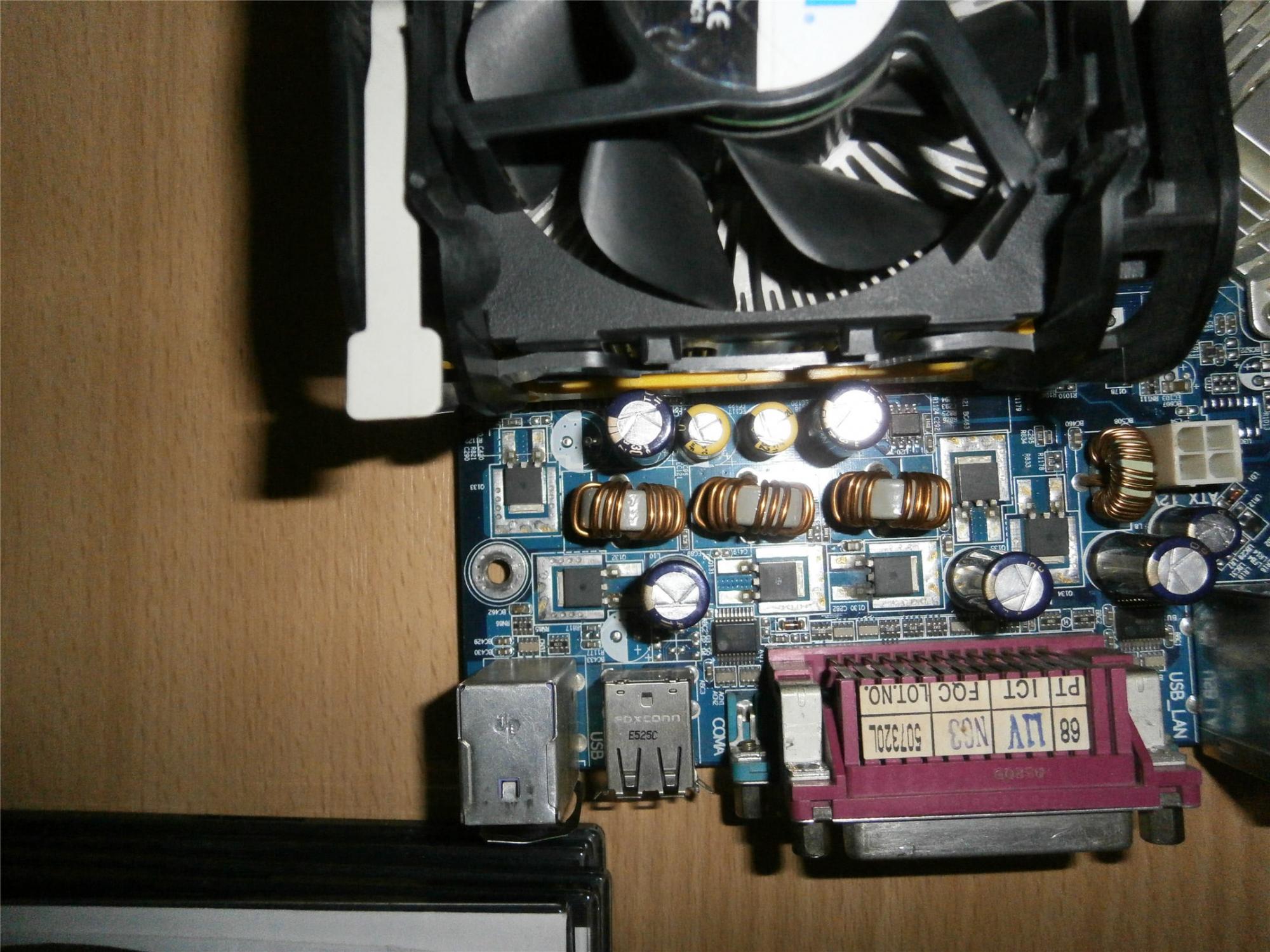

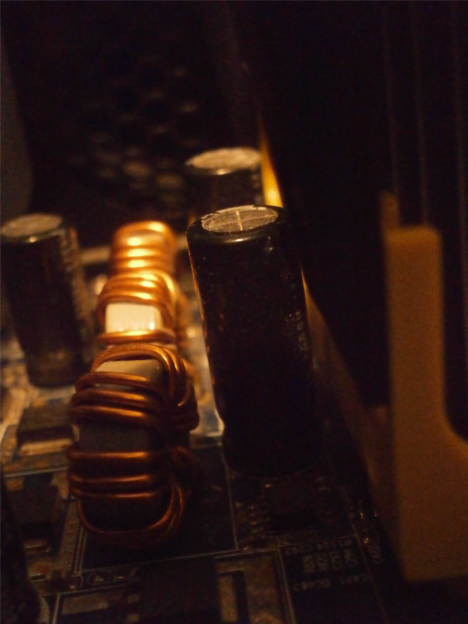

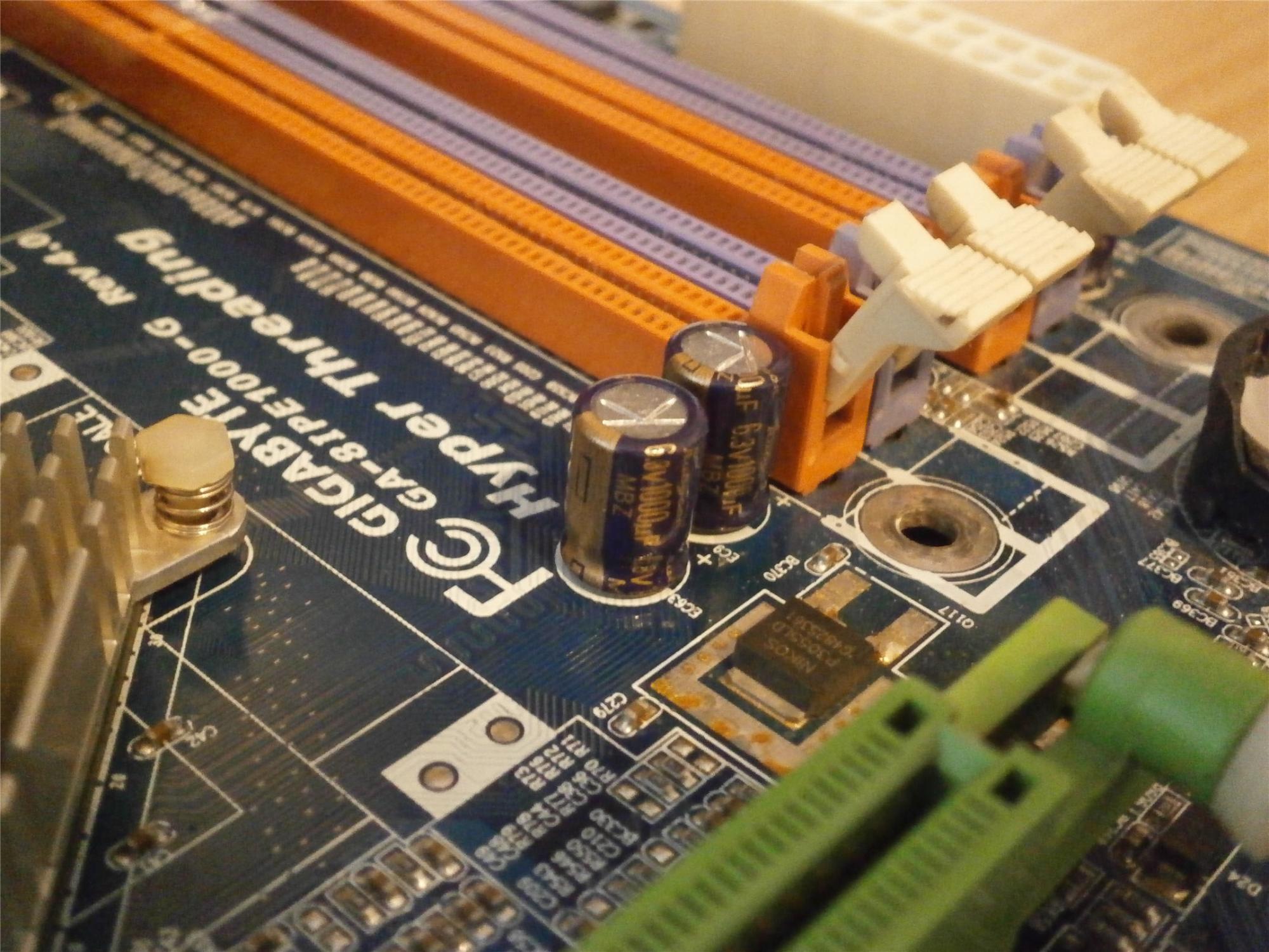

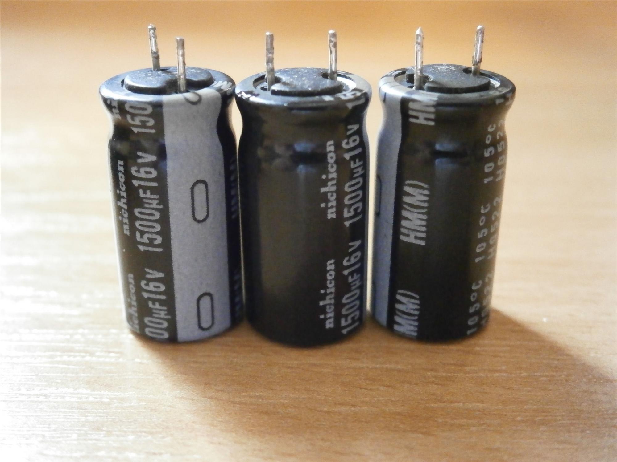

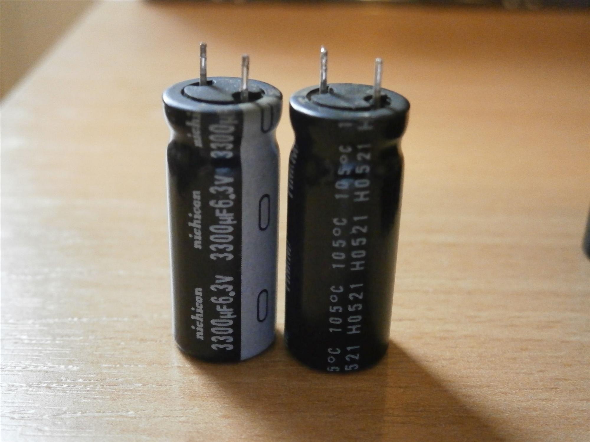

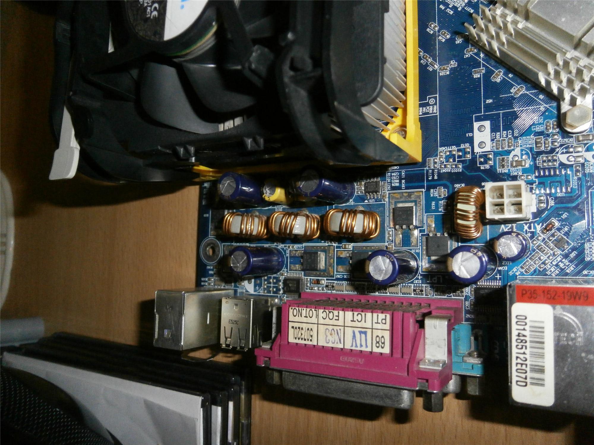

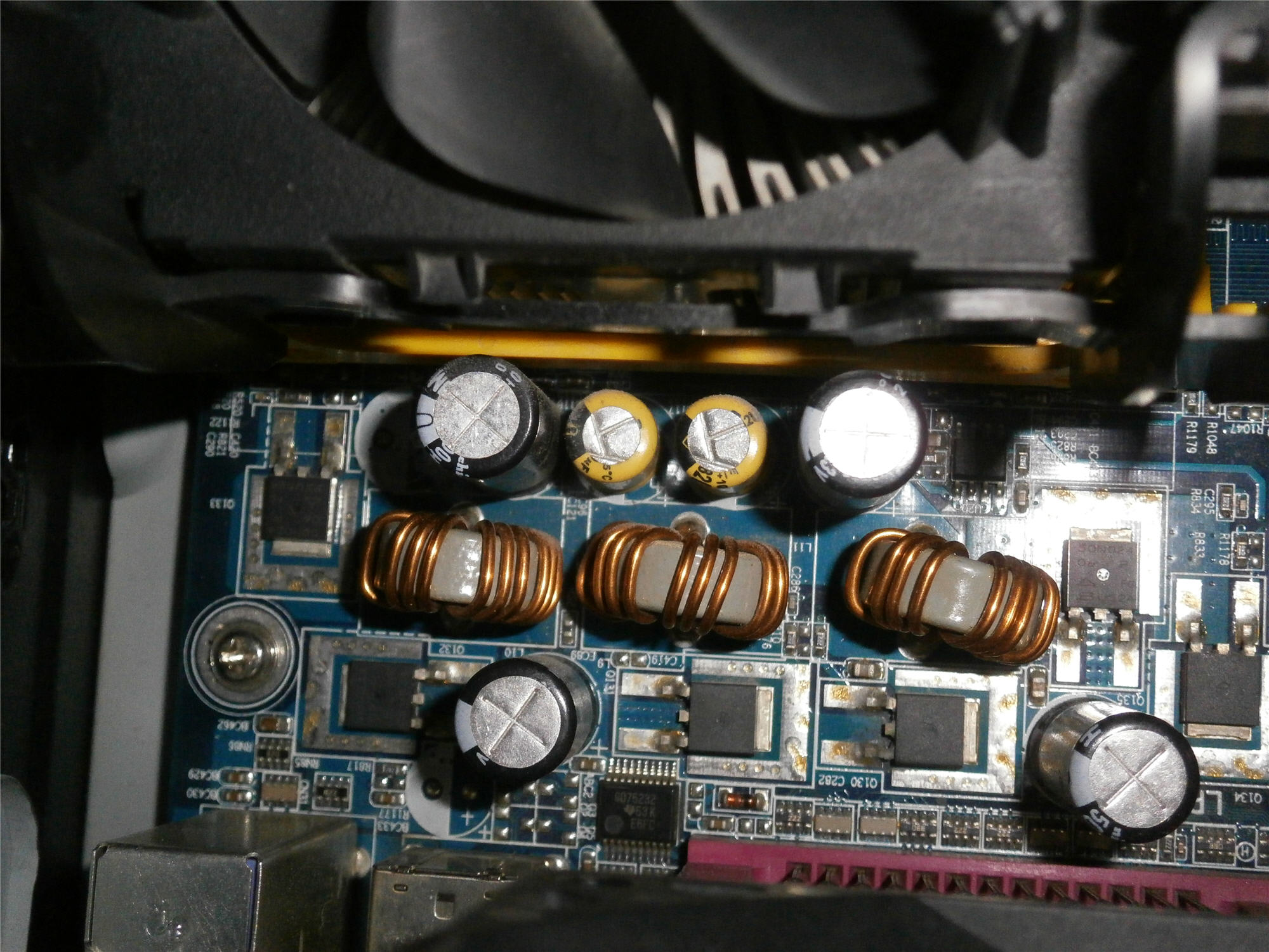

      Hi, guys! Here are some pictures of the motherboard in question. I tried to take my camera in as horizontal position as I could so you could se the caps' tops, but I think you will be able to do that. I didn't have the time to completely take the PC apart, so I took the pictures as they are.
      On the first picture, an area where the whine/squeal noise is coming from is presented.
      All the big black caps are Nichicons HMs. The smallest one is Luxon. So, have a look. I am not a specialist, but I can't say I see any bulging on them. So let's see what do you think.
      On the last picture are shown those little yellow caps near the CPU (the picture represents the caps on this board exactly as they appear).
      An update about the noise: as I said earlier, it is different pitch with different HDs. Yesterday I installed a third hard drive to see what will happen, and the noise level changed, although it apperas in the same situaions regardless of the HD, only the noise sounds different. Weird...
      I have ordered a full package of Rubycon MBZ caps for this board, so we'll see, I will install them when they arrive - I guess it can't be worse than this.

        Guys, one more question here. Is it "normall" for capacitors to MOVE? In the images above, the two large Nichicons next to the heatsink tend to bend away from the sink on their own! Every time I opened my PC casing I noticed that they are tilting to one side. Even though I push them back again at the 90-degree angle, some time later they tilt again away from the sink as long as the distance between them and the PCB is allowing them to.
        On the images they stay up right because I pushed them back in that position, as they were tilted when I opened my case to take the picures. So they were left in the up-right position, but today they were again tilting.
        I am starting to think that maybe those two are not bulging on top because they are actually doing it at the bottom. There isn't any visible liquid around them on the PCB, but I don't think the components should "move" on their own. :-I
        What do you think, is this a telling sign?
        The Rubycon replacement still hasn't arrived, I hope these Nichicons will last a few days more. I have also reduced the PC power-on time in order to "save" them until Rubycons arrive.

          Those caps are from the bad HM series - yes it's entirely possible they could be bulging from the bottom. On the one i had they bulged from the top, but it's not uncommon for them to push the bung out either. It is not normal for caps to move by themselves unless something is pushing on them or the board is slightly warped by the CPU cooler.

            Ummm... well, no, the board is not warped in that area. And anyway, if it did warp, it would do it in a way so the PCB would bend towards the CPU socket and therefore make the caps tilt towards the heatsink. These look like they are doing quite the opposite, as if they are "running away" from the heatsink. I sincerely hope they can last a couple of days.

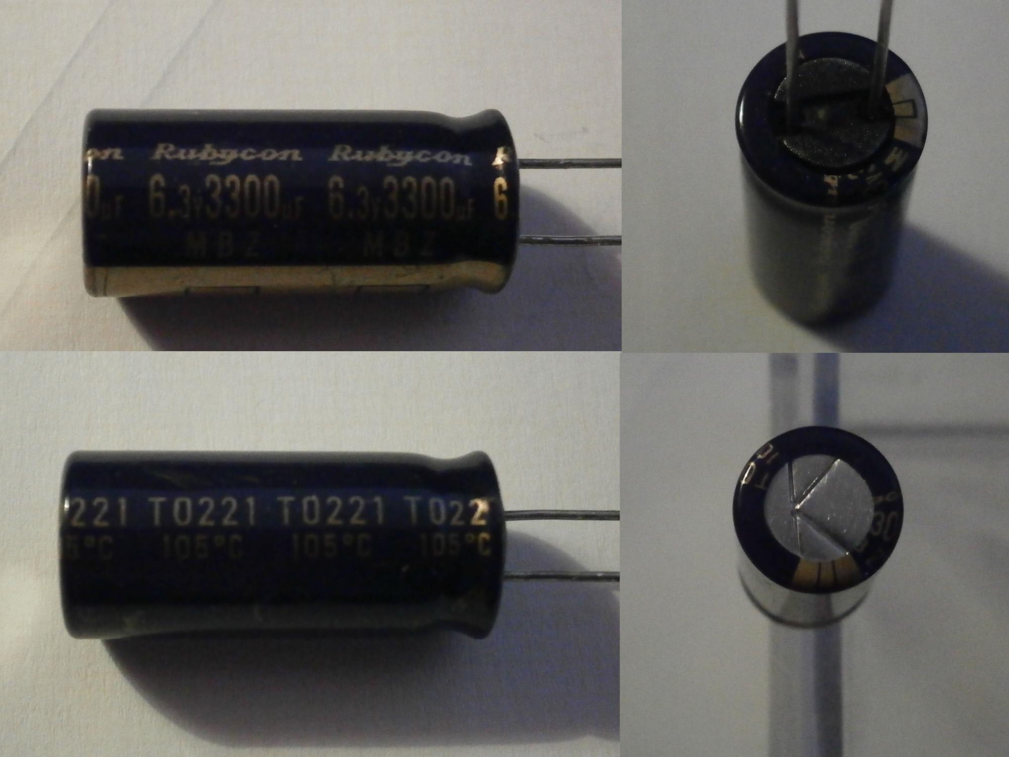

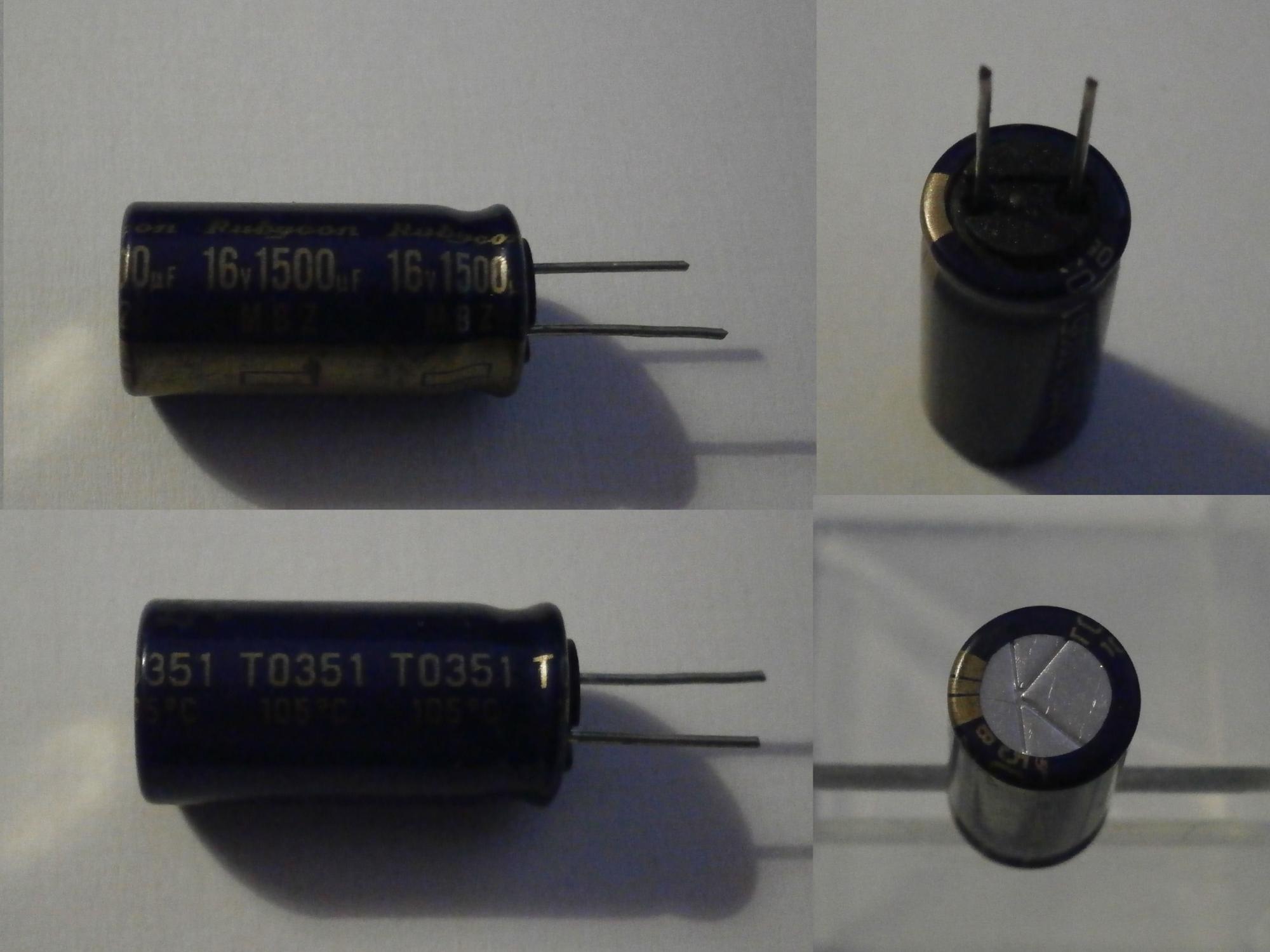

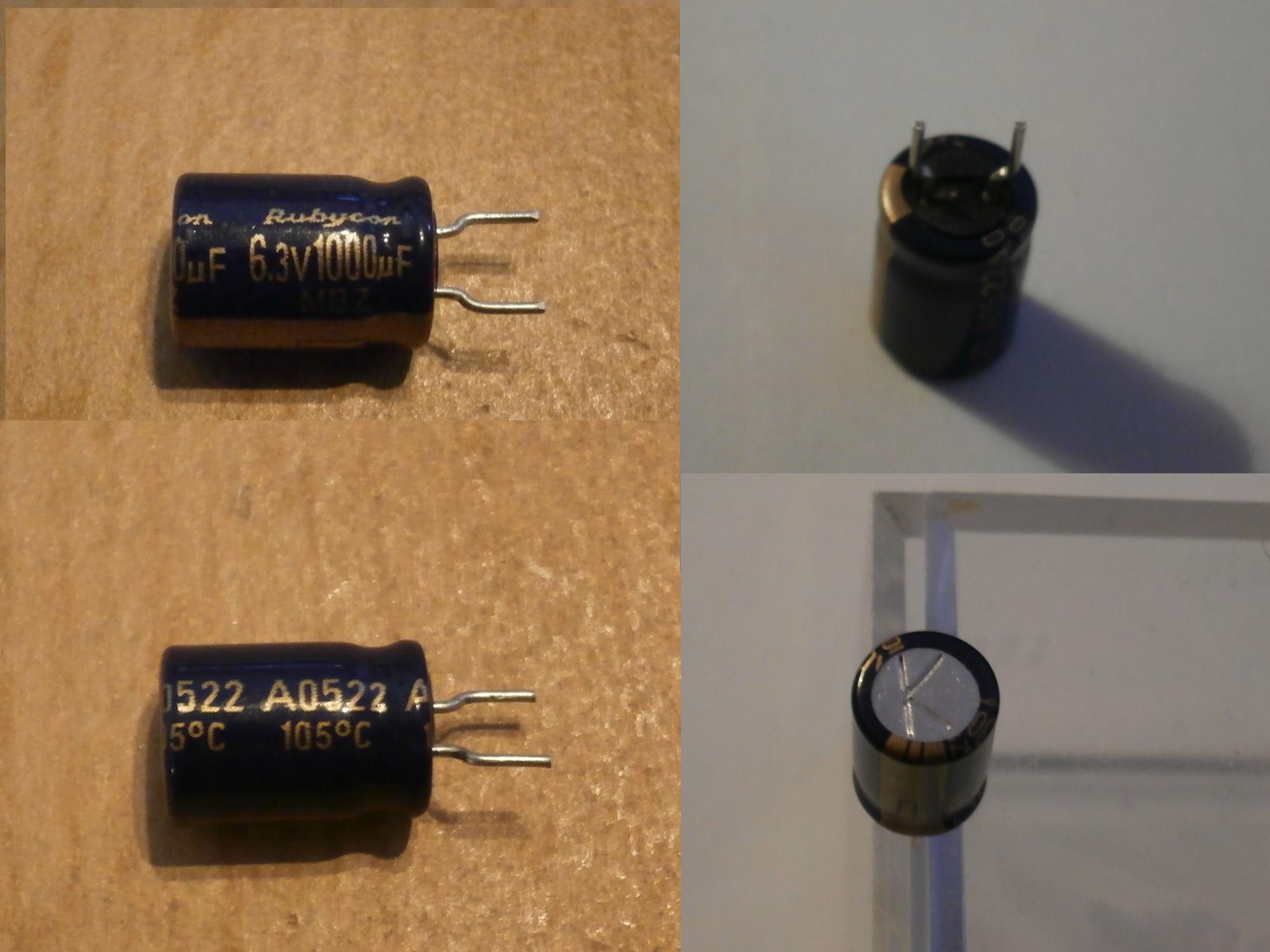

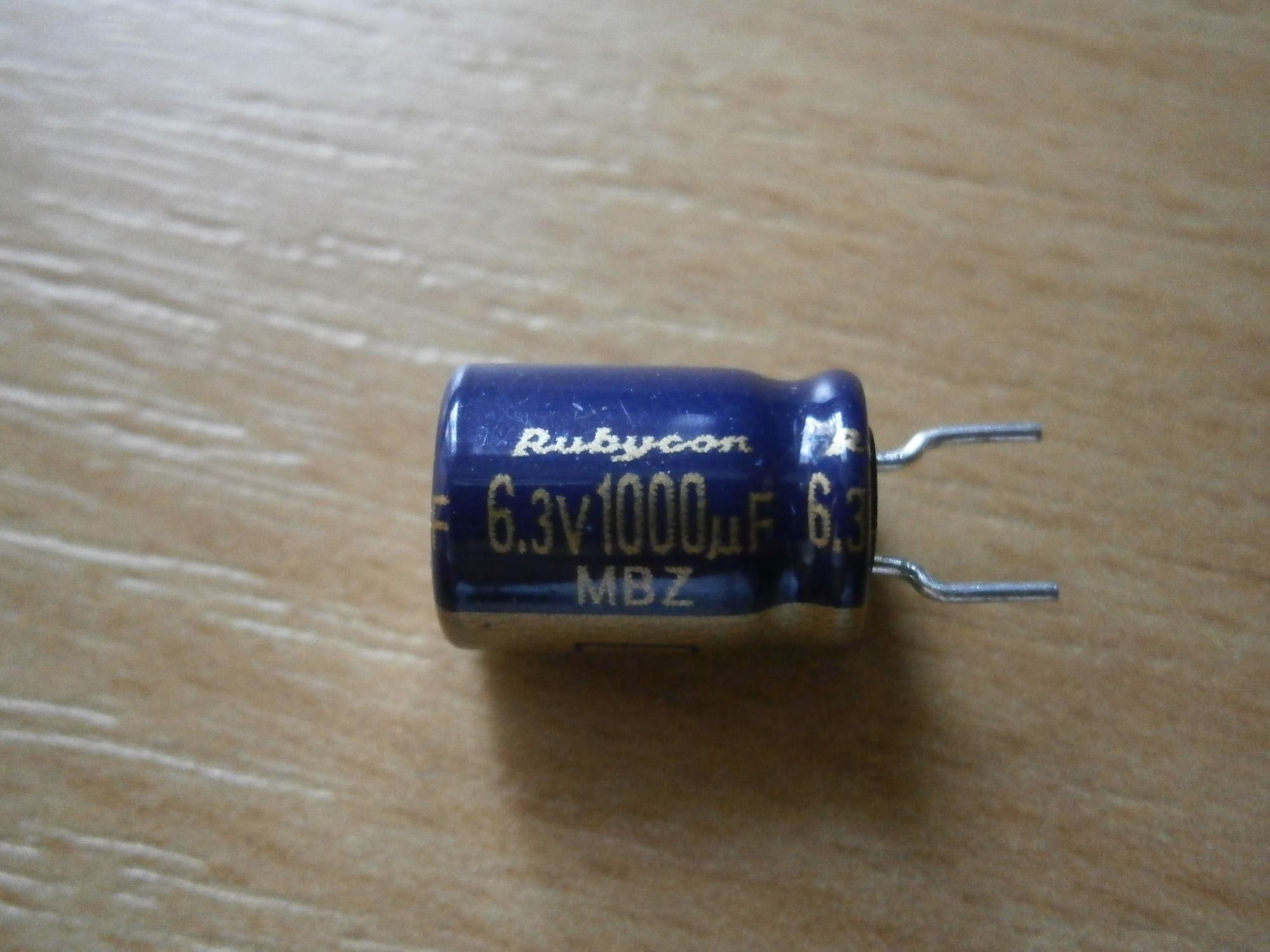

                  Hey, Th3_uN1Qu3, thanks for the input. I was planning to do it this weekend. In the meantime, I have taken pictures of the Rubycons I received. Here are some really close-ups of them, each image represents one type of Rubycon capacitors, taken from all sides. They look OK, and I really hope they are not fake, please have a look and drop your opinion before I start the repairs.

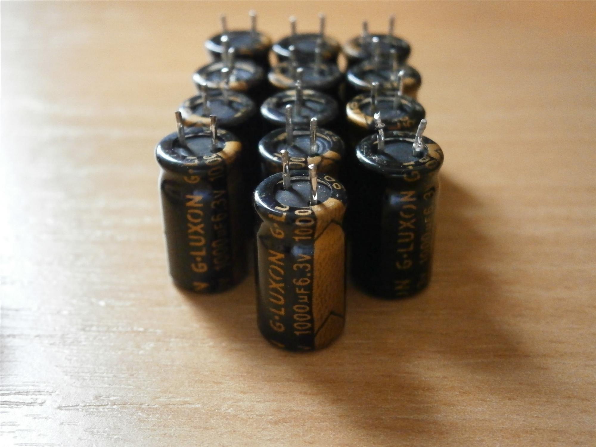

                  The 6.3V, 3300uF Rubucons have a date code T0221, which I suppose is a year 2002, week 21.
                  The 16V, 1500uF Rubycons have a date code T0351, which I suppose is Year 2003, week 51. I am a little concerned that these two types are already almost 10 years old. But, I knew that the MBZ series were out of production so I can't say I didn't know that, I just hope they are fine as they really look unused and new.
                  The 6.3V 1000uF Rubycons have a date code T0522, which I suppose is Year 2005, week 22. What surprised me was the absence of these capacitors in the datasheet for the Rubycon MBZ series caps, though they look genuine like all the rest.
                  I bought all these capacitors on eBay from the seller egekecu, whose store has a logo like a ==(pcMcs) and excellent feedbacks.
                  Please, have a look at these images, I took them as best as I could, also with the "K" vent side up and tell me what you think of them:

                    The first two look genuine. The printing on the third (6.3v 1000u) looks kinda dodgy.

                      Thanks for the quick reply, Th3_uN1Qu3.
                      OK, so the first two are OK. So, the age would not have any performance impact since they were not used (or should I expect "possible" electrolite dry-out)? I suppose they have 0 hours of running time.
                      Here is a bit clearer image of the third type of capacitor. This cap is smaller and I am having trouble making this camera shoot it nicely in super-macro mode, because my hand moves a bit when I press the "shoot" button. Also, here I have selected a cap where the Rubycon word is not warped by the groove near the cap rubber lid, so you can see better:

                        Nah, they'll work just fine. Print is kinda fuzzy on this one indeed, but anyway - you won't be able to find the answer until a couple more years pass by with the caps installed on your board. So go ahead and solder them in.

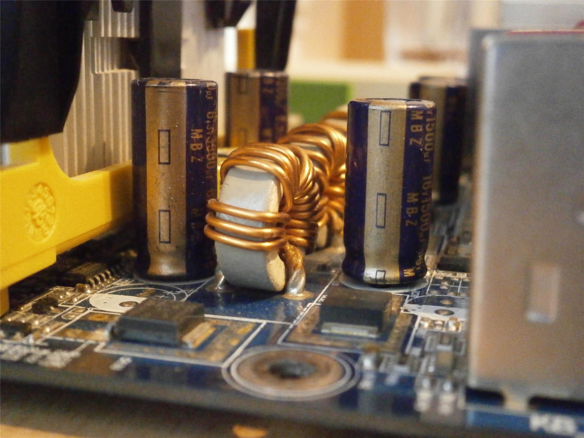

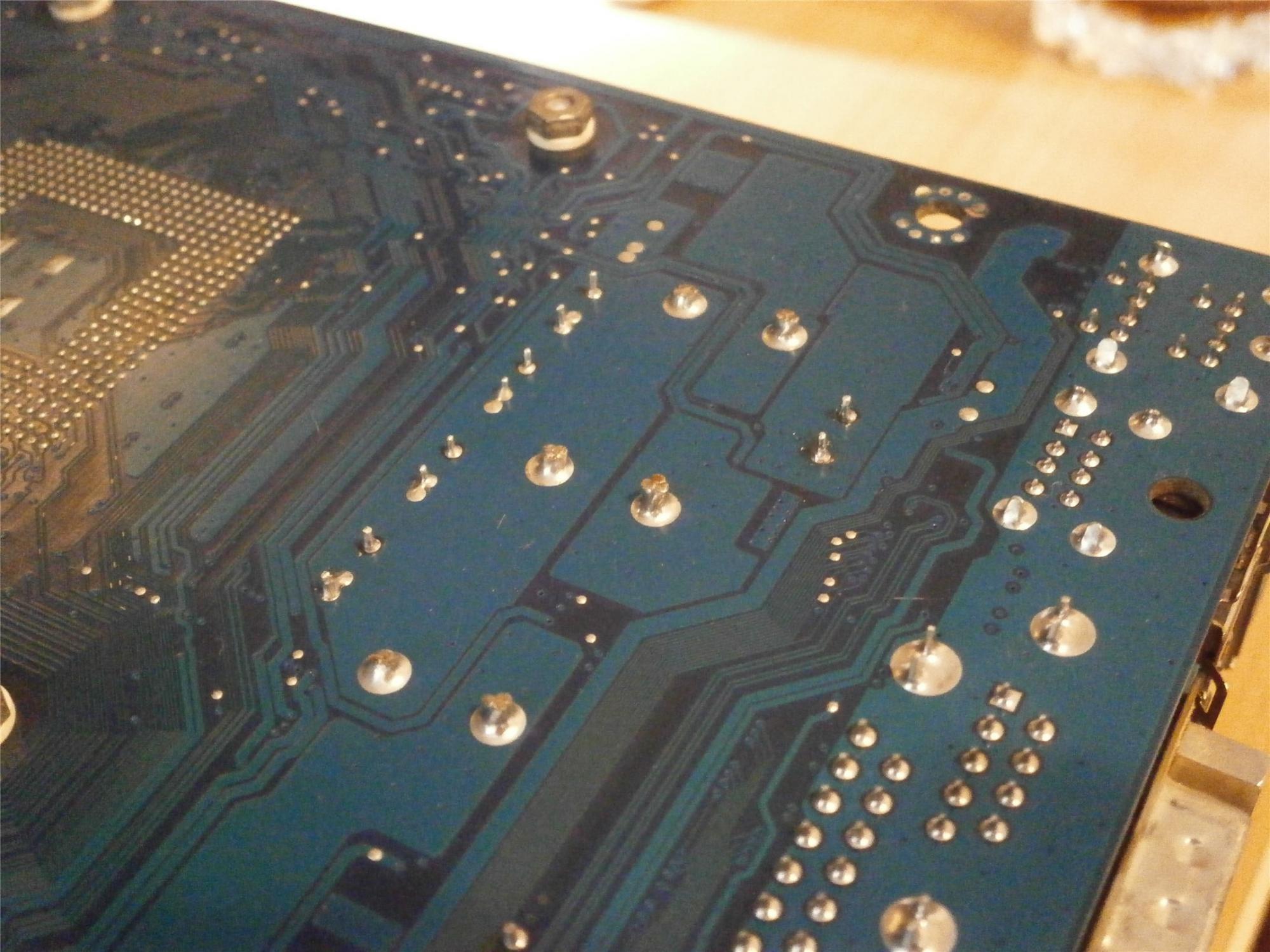

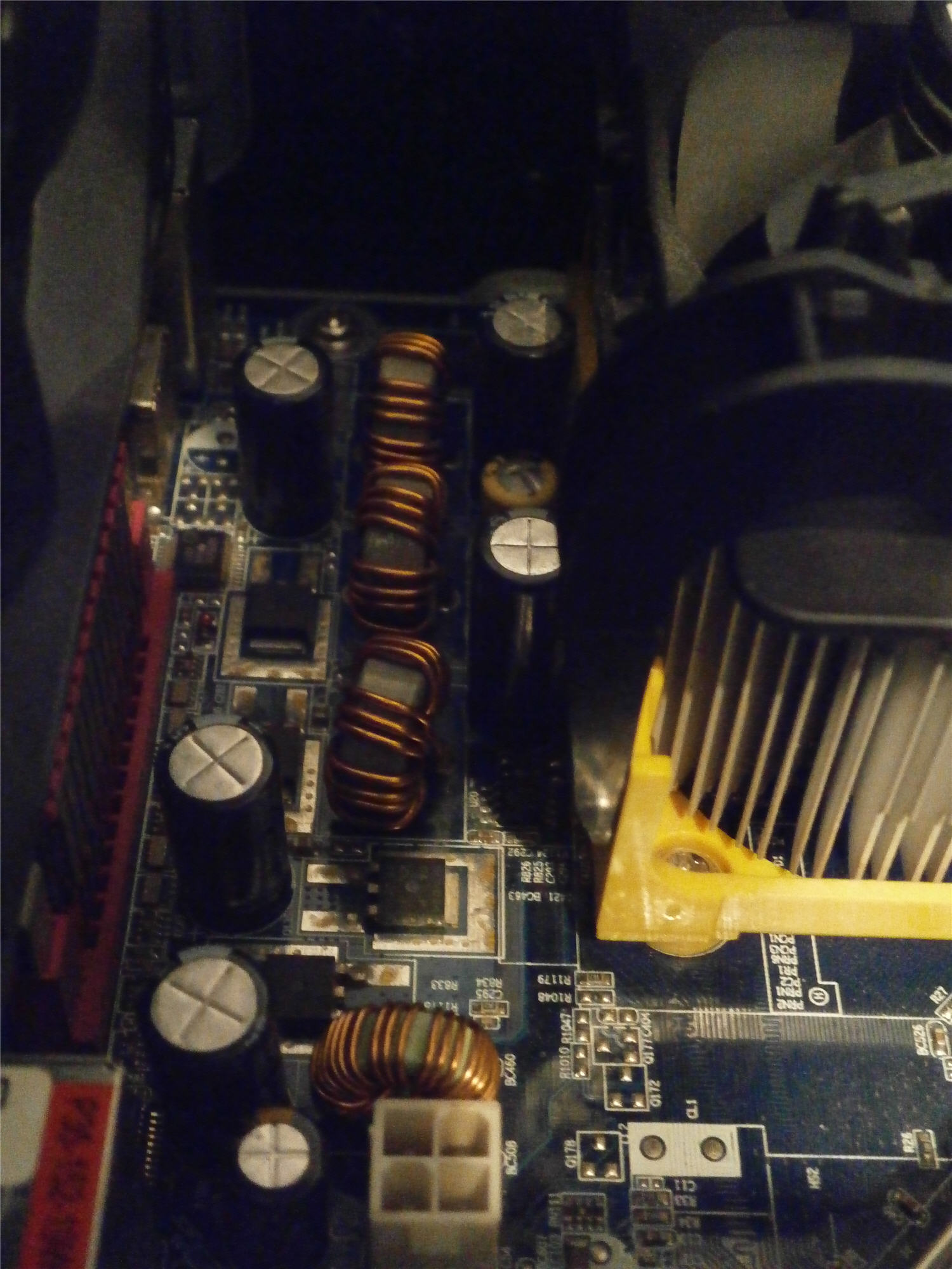

                          Well, guys, here is the repaired board. I have replaced all the capacitors with the Rubycon MBZ ones, respecting the types. The board now only has those two yellow F caps and those little TEAPOs that are not Rubycons, all the rest are.
                          The board works, PC powered up, this is the first day of running it with the replaced caps. The squeal noise is still barely present and heard, but only if I really closely focus on the noise it will be heard at the same stage of power up - so in general the board now runs quieter. I kinda thought that maybe this recapping job didn't do extarodinary difference to the board, but it looks like it's running more quiet now anyway. I hope it will last for a while.
                          None of the removed caps showed any form of leakage or deformation, even the tilting Nichicon ones. They all seem to be in their right shape (exept for some dust on them).
                          I have included some images bellow so you can see how I did. I think I wasn't so bad since this was my first recapping job. The whole work lasted for almost 3 hours (I was slow and careful, but did not do any heat damage or paint burnout in the process of desoldering and resoldering a total of 18 caps). On the last three pictures are the caps that have been removed.

                            Hi, guys! I just remebered this older topic of mine. Well, I'm happy to inform you that now after 6 months of continued use of this board with the replaced caps, everything is still working great! Windows did not even once fail to load, the PC is being used daily for many hours (sometimes with 2 or more separate start-ups). The board is working very stable, and I guess those Rubycons I've put in really do their job good, even though they were bought as an outdated MBZ series line. As you suggested, quality capacitors really do make a difference.
                            So, once again, thanks to all of you for some great advices.
