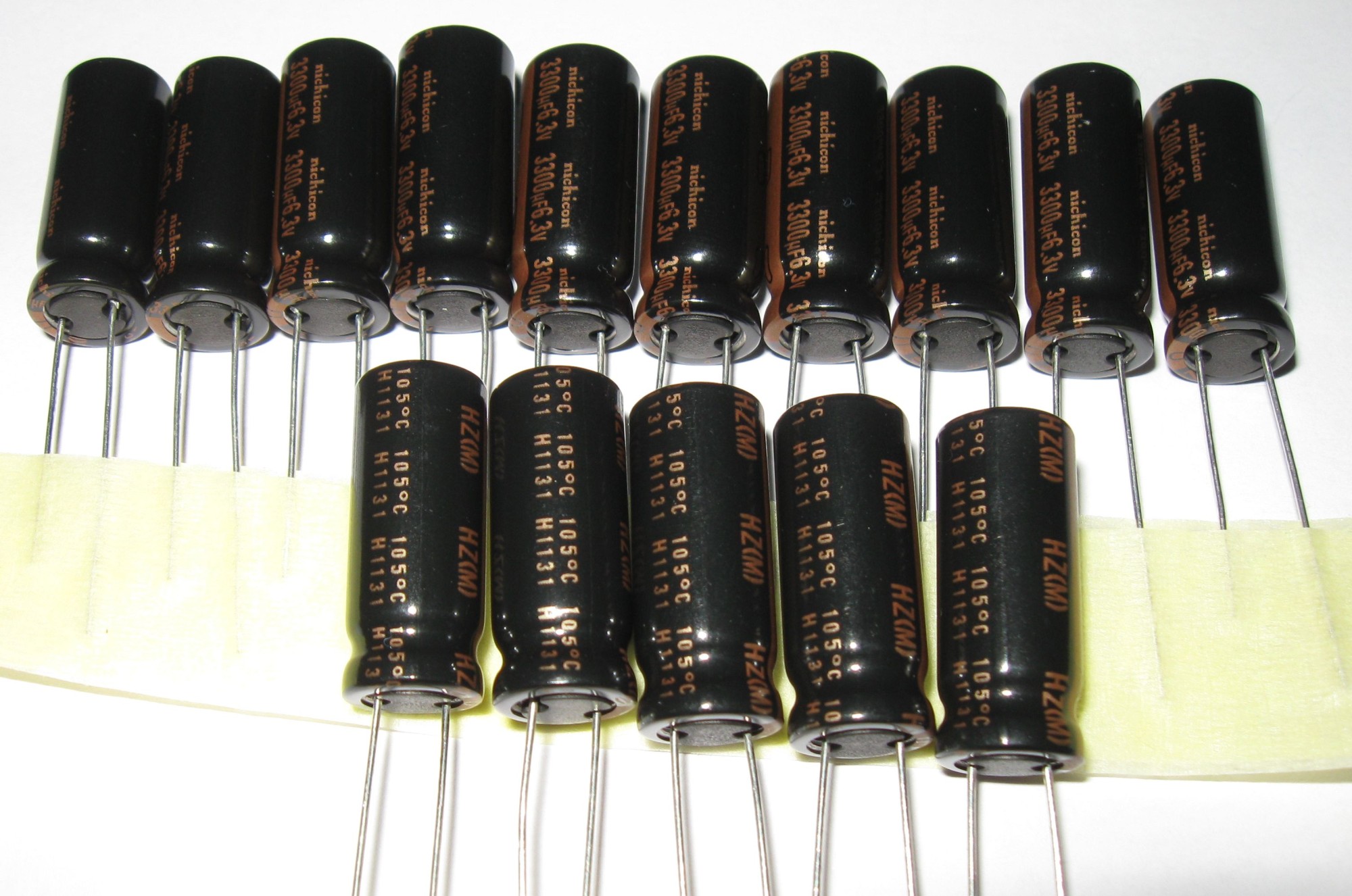

                                RS Online I believe will send to Serbia but what would work for you is 12.5mm or larger on their site: http://int.rsdelivers.com/catalogue/...50|PI-1|PS-25|
                                If you can afford the 8$ international shipping fee, this site actually has Nichicon HZ (3300uF 6.3v) and Rubycon PX and Samxon RS (these 3300uF 10v) but all 10mm diameter and very good
                                https://www.badcaps.net/store/produc...roducts_id=142
                                https://www.badcaps.net/store/produc...roducts_id=162

                                  Wow, thanks for all the help and additional info. Well, after my last two posts, I kind of made my options narrowed down as to which brand to use (based on your very helpful suggestions and what I managed to actually find and read user experiences with each). I am thinking the caps to be either Nichicons or Rubycons. But the problem is the "set". If I choose Nichicons, I would like to buy from the same place (because that way everything would go on the same shipping cost). I watched the BadCap's store, even there there aren't all types of same brand capacitors for my board (at least not at the exact ratings).
                                  You have provided me with the links only for the 3300uF caps, but I would also like to change the 2.5V 820uF (these two are u must because they go right next to the CPU and probably need to be changed the most) and 16V 1500uF caps also,, as well as all the Luxons on the board which are rated 6.3V 1000uF. It would be great if all these four type of capacitors could be bought from the same place, preferably the same maker and series. I have read in the data sheet that Nichicon HZ, as well as Rubycon ZL series all have at least these four ratings type capacitors. The only problem is findig a supplier that has all of them at the same place/store and can ship them to me.
                                  Your offer is also very appriciated, and quite honest. ;-)
                                  Do you happen to have the other three types of capacitors lying around unused, or have a suggestion where to get those genuine quality ones?
                                  • mariushm
                                    • May 2011
                                    • 3799
                                    Re: Gigabyte GA-8IPE1000-G, rev4.0 "problems"
                                    The 2.5v are almost sure polymer capacitors or functional polymer capacitors (a hybrid between electrolytic and polymer) - if it's polymer these rarely go bad, because the most often cause for capacitor failure is due to liquid substance inside drying up or reacting with the poor quality aluminum casing and foils inside.... and polymer capacitors don't have liquid substance inside. The functional polymer do have some electrolytic inside.
                                    As your yellow ones have a vent mechanism on top (the "k"), they're probably functional polymers.
                                    You'll have a bit of a hard time finding those as like i said, because they don't die often people like me don't keep them around and as they're also small diameter you won't find electrolytic replacements for them.
                                    Badcaps, as I do, hand picks the capacitors that have the best specifications for particular diameters and heights. If there's 3 good reliable brands and a brand offers a series of capacitors with better specs and smaller diameter, you obviously pick that brand. It's not really important to have all capacitors from the same manufacturer.
                                    I have Nichicon HM 1500uF 16v and they were about 0.75$
                                    1000uF 6.3v Nichicon HM I have about 20 pieces, bought them at about 0.6$
                                    The 100uF capacitors are not worth replacing, it's unlikely they cause problems but if you insist, i have Panasonic FR 100uF 16v at 0.35$
                                    I checked farnell.com because I have an order pending there and thought maybe I could get those 820uF 2.5v but they don't have in the UK stock any polymer ones - only Rubycon ZLH or Panasonic FM 820uF 6.3v which are not good enough to replace polymer capacitors (don't get me wrong, they're some of the best electrolytic capacitors but polymer capacitors usually have about 2-3 times the specs of electrolytic capacitors)
                                    Ah, Badcaps actually has polymer capacitors in the store, here you go :
                                    https://www.badcaps.net/store/produc...products_id=76
                                    https://www.badcaps.net/store/produc...products_id=77
                                    here's 1500uf 16v:
                                    https://www.badcaps.net/store/produc...roducts_id=139
                                    and 1000uF 6.3v:
                                    https://www.badcaps.net/store/produc...roducts_id=169 (10mm wide)
                                    https://www.badcaps.net/store/produc...roducts_id=154 ( 8mm wide)
                                    https://www.badcaps.net/store/produc...roducts_id=165
                                    https://www.badcaps.net/store/produc...roducts_id=131
                                    • UserXP
                                      • Apr 2012
                                      • 443
                                      • Serbia
                                      Nope, I have removed the smalles ones from the list, only the caps arround the CPU (all three types) and all of the 6.3V/1000uF ones scattered across the board.
                                      OK, there it is, I didn't know that these yellow were polymers. I was looking at the sam capacitance but for electrolitic ones.
                                      So, all 6.3V/3300uF can be Nichicons HZ, all 6.3V/1000uF Nichicons HZ, 16V/1500uF Nichicons HZ series, and 2.5V/820uF should go as polymers.
                                      • UserXP
                                        • Apr 2012
                                        • 443
                                        • Serbia
                                        Originally posted by mariushm
                                        Rubycon MBZ is no longer in production, you have no way of knowing how good they still are.
                                        mariushm, I hear you about this... however, living where I'm living, I have almost no option for good-branded capacitors to choose from, especially for recaping the PC motherboards. Everything must go via internet, and as soon as I find something - payment or shipment turns out to be unsupported for my country.
                                        However, yesterday I have stumbled upon an eBay offering through a friend of mine where MBZ Rubycons could be acquired. By looking at the datasheet for the MBZ series, 6.3V/3300uF has the same specifications as the same Nichicon HM (which the board currently has), 16V/1500uF is also the same with the Nichicon HM counterpart which the board also currently has (all are equal in terms of ESR, Ripple and Size between the two caps respectively)... However, there is no mention of the Rubycon 6.3V/1000uF version in the MBZ datasheet, yet it is also listed in the offering. This cap has an authentic dark blue sleeve with golden letterings like the other two mentioned above, a "K" vent, and it really looks like a genuine Rubycon. Is it possible that maybe the datasheet that I was looking somehow wasn't updated and Rubycon actually added this cap to the MBZ series at some later point?
                                        Or am I looking at some really good "copy" of these Rubycons, because I think they are to be shipped from Hong Kong (the seller, however, has a very high score and 100% positive feedback, so it looks good)?
                                        I am just considering to respect the Gigabytes choise of capacitors and go with Nichicons, or use these MBZ Rubycons which have the same ratings and specifications... I hope I'll get some reply from Tomcat, but in the meantime, I am doing some "homework" and research of my own. If he does reply, than I'll see what he can do, but these MZB are kind of a last (and currently only) result at the moment - considering availability.
                                        Here are the mentioned Rubycon MBZ caps:
                                        6.3V, 3300uF:____16V, 1500uF:____6.3V, 1000uF:
