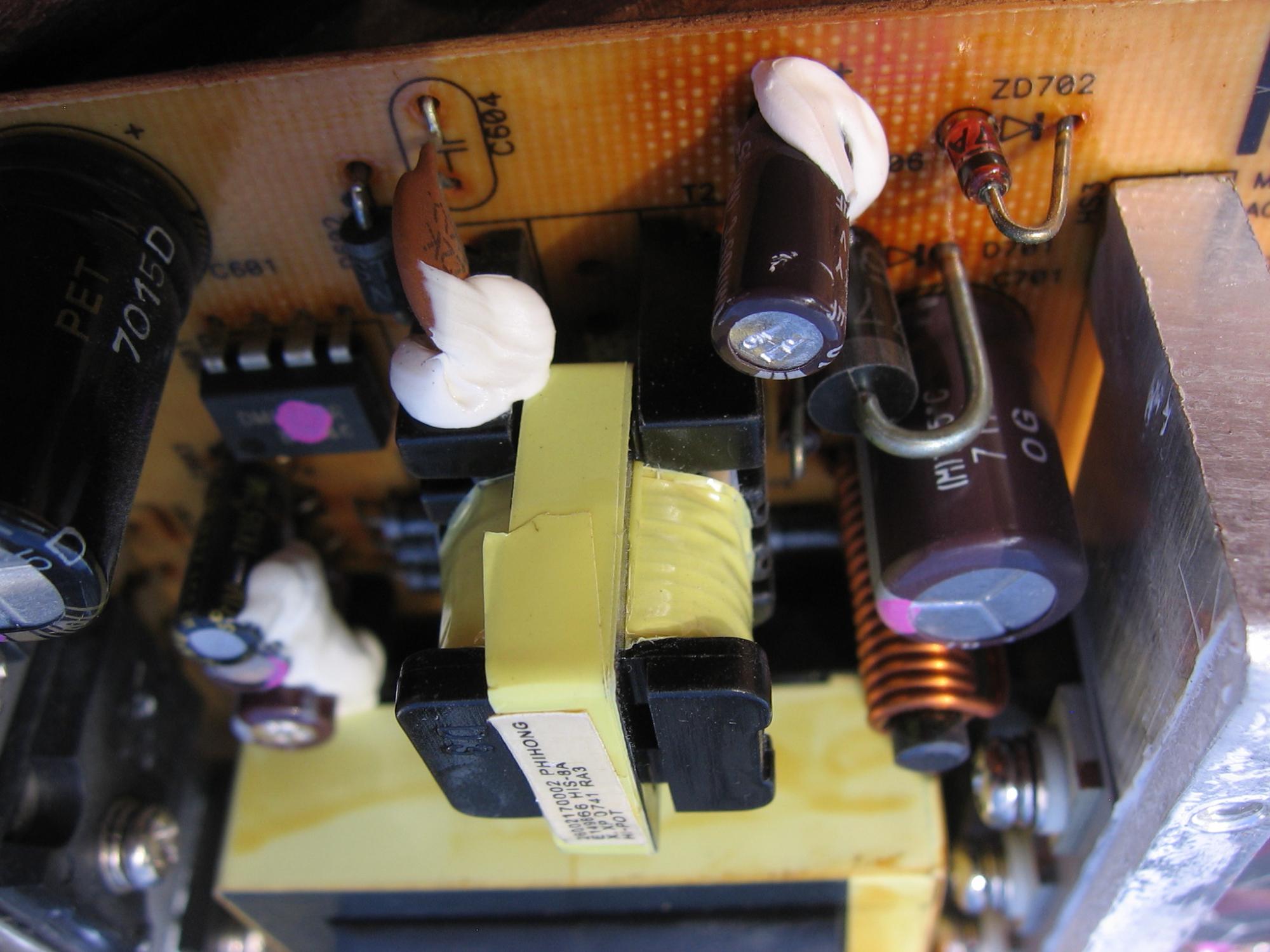

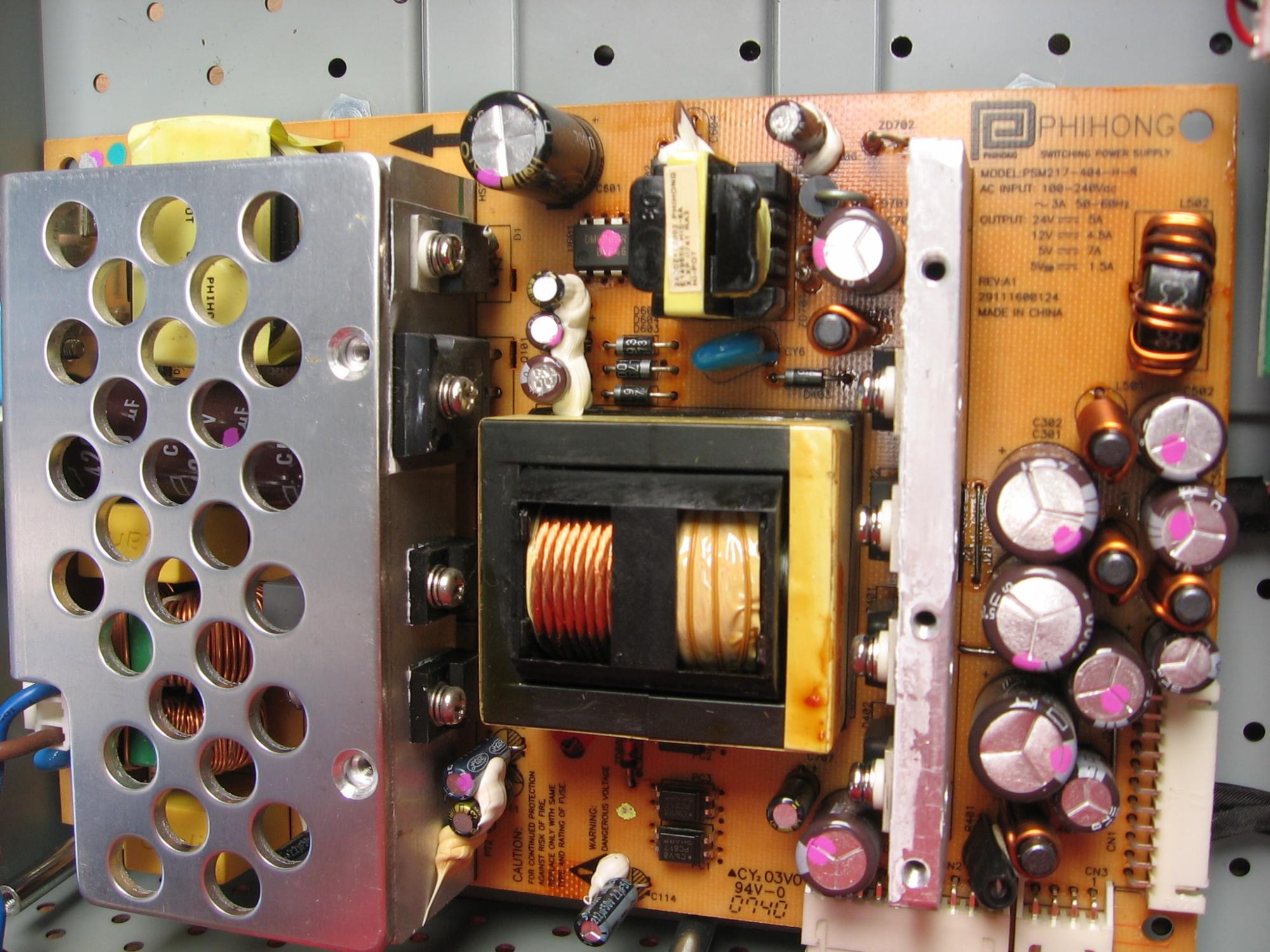

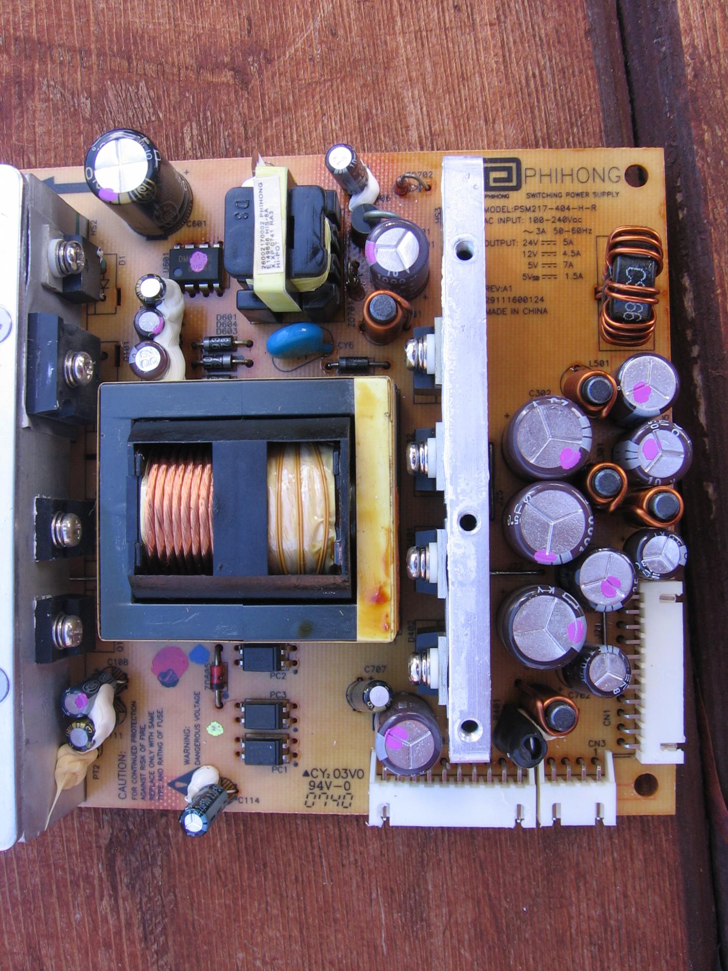

    Have dismantled the beast thanks to the service manual and have examined boards and taken photo's.
    The Power Board (PB) is definitely "browned off" with signs of heat damage on RHS of board particularly on the surface mount component side of the board with brown patches showing through onto the hardware side. Heat concentration appears to be around component ID's ZD702 top-middle front, ZD406 top-middle rear and C114 bottom-middle front and Q601 bottom-middle rear of PB.
    Caps look OK to me (but what do I know) no sign of Cap Poop, bulging etc unless I missed something.
    Could be general PB fried/blown fuse rather than caps perhaps (but what do I know).
    Over to the guru's with thanks for any feedback.

    Hi - welcome to the forum. Pics are good - can you do one of the whole of the back of the board and if the connectors have any descriptive text (24v 12v 3.3v 5v gnd etc) close ups would be useful.
    The other thing is you dont seem to actually say what is wrong? - did it go wrong suddenly or has it been flickering for a while, not alway coming on, starts dim and brightens, starts bright and dims etc.
    You need to tell us exactly what happens when you switch on. Lights, sounds anything, nothing, flashing, continous.

      The power board is probably the same as the problematic Hanns-G HG281D. There are not too many 28 inch monitors around and they all seem to utilize the same power board.
      https://www.badcaps.net/forum/showthread.php?t=11329
      If you search for this monitor and see a lot of threads on it. In one of those threads, I came to the conclusion that this monitor runs temperature hot and warrants a complete recap of the power and logic board.
      And yes, tell us what is actually wrong with the monitor.

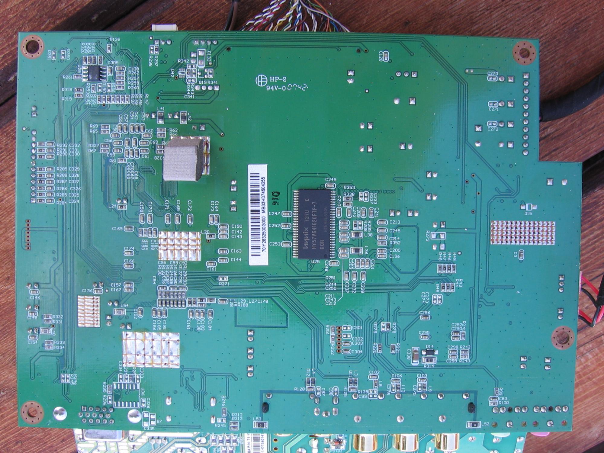

        The logic board looks perfect, no signs of problem components or "browned off" patches or tracks. I'll post pics of it tomorrow also.

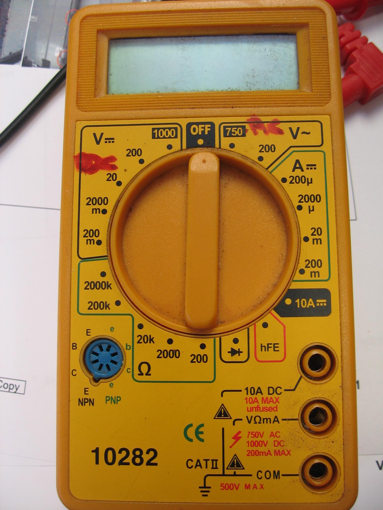

          sound? - I have looked at the manual linked in the other post - doesnt have
          much about the power supply - does yours? Can you post a close up pic of your
          multimeter and advise the model number if its not clear in the pic.

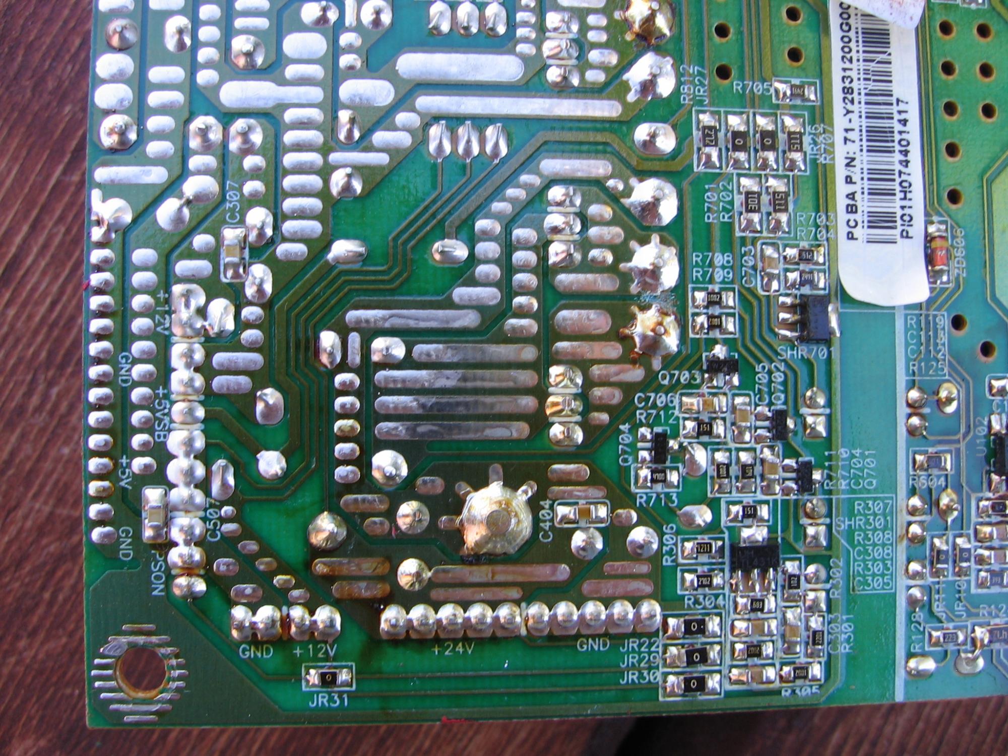

          Hmm much later edit surprised it let me- Have been looking at your pics and
          As I believe you have already noticed part of the trace on U801 looks burnt.
          Same goes for Q601 and U102 , resistor R119 looks dead. You should try and get the part numbers off these- may be the same as in other posts
          Also around the burnt bits there is some glue type gunge this is mentioned in the following link
          and you will need some rubbing alcohol to get it off.

              Multimeter is DT830 3 1/2.

                1) Set your multimeter to 20V DC. Plug in lcd and turn it on.
                2) The most important voltage to look for right now is 5V SB.
                3) Put your black probe on a ground screw that is closest to the 5V SB pin.
                4) Put your red probe on the 5V SB pin.
                5) Report your reading.

                  Reading 4.95. I guess this is good news so far.
                  This is with PB disassembled from everything else, just screwed into the metal tray with the earth lead connected to the tray and the mains plug in.
                  Have to say I'm crapping myself as I'm not sure if I'm heading for an electric shock.

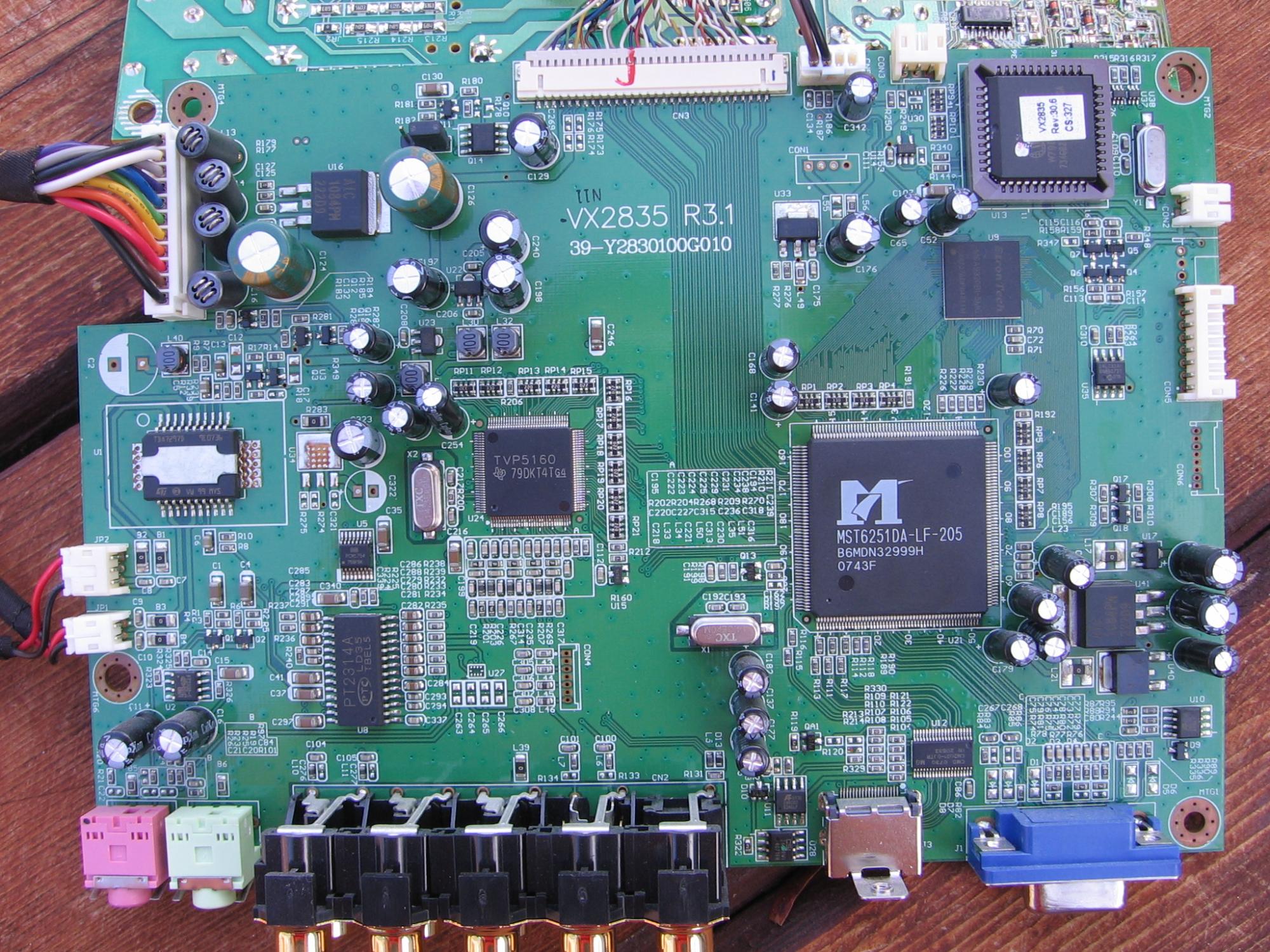

                    Now plug in the main board (board with all the A/V inputs).
                    Recheck to make sure 5V SB is present and steady.
                    Post a picture of your main board so we can give more test points. If you are getting no power LED light, the problem likely lies in the main board.

                        PB in main board interconnected + small led switch panel board.
                        Reading at 5V SB is 3.6.
                        No light at switch board LED after pressing switch.
                        • retiredcaps
                          • Apr 2010
                          • 9271
                          Re: MrFlibbles' Viewsonic VX2835WM Problem
                          C126 looks bloated and needs to be replaced. C124, while not bloated, is probably a Capxon and due to guilt be association should also be replaced.
                          Replace with Panasonic FM caps from digikey.com or Australian distributor and see if 5V SB is 5.0V DC.
                          Power LED will never come on with 5V SB at 3.6V DC.

                            Can we get a couple of different angle shots of C126 to verify it is bloated? It looks domed to me in the picture, but it could be a light trick and it is 1AM here so I might be seeing things.

                              C126 is indeed domed. They are indeed Capxon's.....

                                Have removed C124 & C126, first 1 took 20 minutes, second one 40 seconds.
                                Have solder wicked the mounting holes and cleared solder out with wooden cocktail stick (been watching soldering video's) and Cap pins do go through so ready to solder replacements. It's a public holiday here so shops are shut.
                                Will get replacement caps tomorrow (Panasonics as recommended if available).
