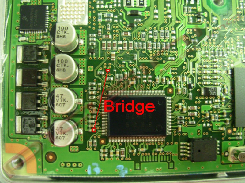

    Help identifying ceramic cap in ECU
    due to some bad soldering, the capacitor circled in the lower half of the picture needs replacing. No chance of getting a schematic etc of this car ECU. The only thing I can think of is desoldering the capacitor above, and measuring it's value? Then hope it is the same?
    Thanks!

    Re: Help identifying ceramic cap in ECU
    Sounds like de-soldering and measuring would be the best way.
    Just try not to overheat it or lose it.
    Of course if it's not in parallel with any other capacitor you might be able to measure in-circuit...
      Possibly the one above it is the same, but what's the part number of that big chip? Getting a datasheet/pinout would help ID what pin that is and thus what kind of cap would fit there.
