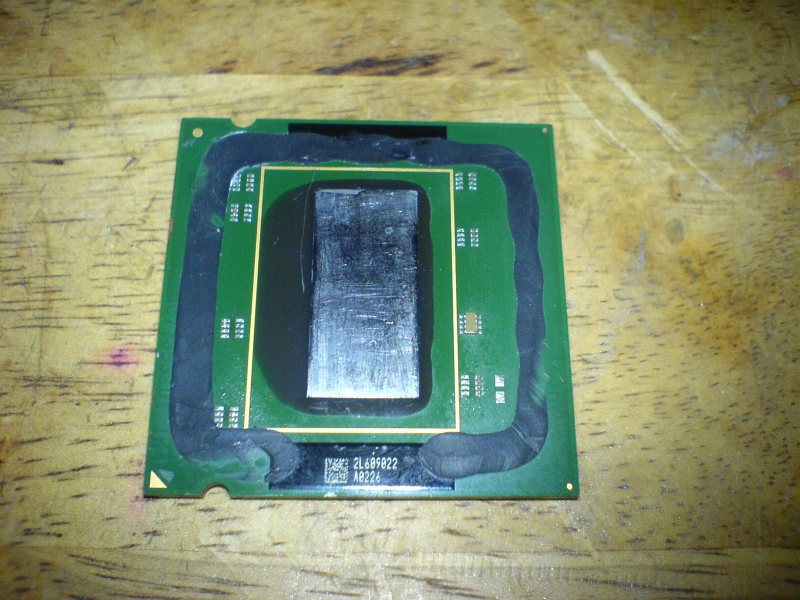

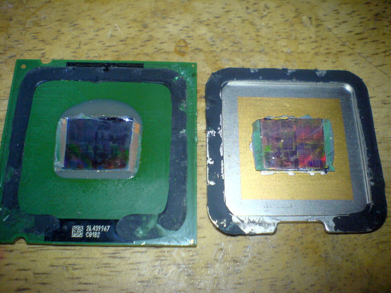

                          Intel has been soldering the IHS to the Die since Socket 775.
                          Found that out after I killed a S775 Pentium 4 620 (2.8GHz). Ripped the Die straight off of the substrate
                          No big loss though..
                          Managed to get the IHS off of a Pentium D 805 (2.66GHz .. HUGE Die!) but ripped off and damaged some SMD components and a corner of the Die.

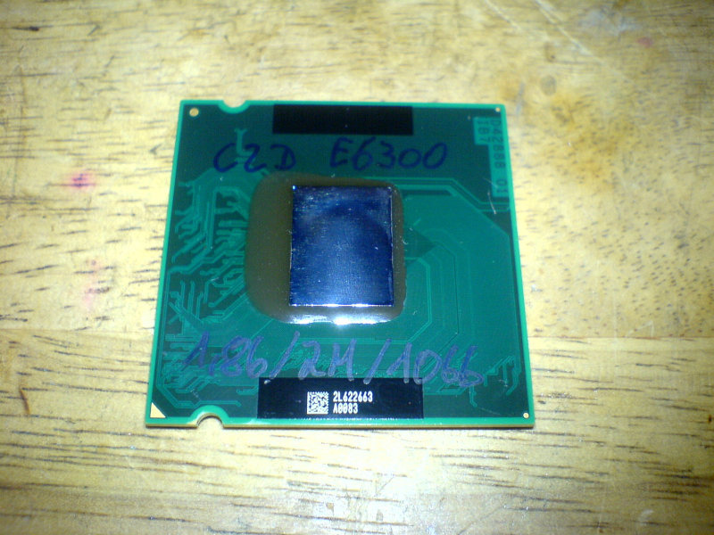

                          Next ultra-careful attempt on a Core 2 Duo E6300 (1.86GHz) was successful (no damage ; CPU still works).
                          I'm using a Thermalright XP-120 cooler with S775 mounting brackets and rubber pads around the die to keep the CPU firmly in the socket (outer pins not losing contact). You have to remove the "pressure plate" (the part that you open up when inserting a CPU) from the socket though.
                          I didn't throw away the P4 as the Die looks so cool. Need to find someone with a microscope some day for that one. Kept the Pentium D just to show off the gigantic Die.. The keychain idea I had was scrapped.. corners and edges of the die are sharp enough to cut through the cloth I used to clean it up and subsequently the skin on my finger.. *ouch*
