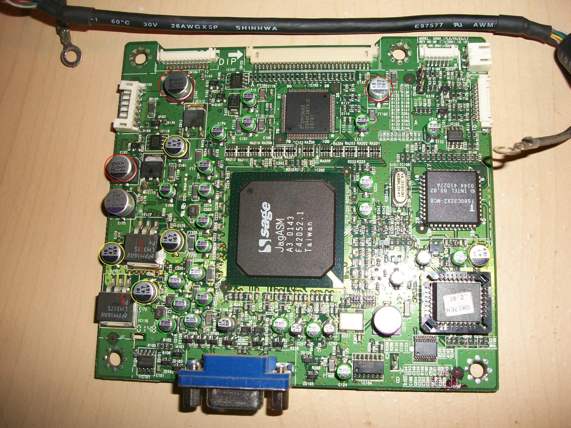

    Poly markings
    Looking at this board and wondering. Do we add a zero so that;
    10=100uF (green)
    47=470uF (yellow)
    100=1000uF (red)

    Re: Poly markings
    The 25V 100uF look like they have the UCC Logo with a dot in the middle. Some of the other ones look like they have the Fujitsu logo, but I can't be sure...
    Upload a more detailed picture somewhere.

      Re: Poly markings
      Am I right in thinking you add a zero to the right of the number to get the capacitance?
      Open the attached thumbnail and click on the picture, click again to zoom. Its at 3472X2604.
      The 25V 100uF look like they have the UCC Logo with a dot in the middle. Yes they do.
      Some of the other ones look like they have the Fujitsu logo... is that the super imposed S's? Looks like maybe?

        Re: Poly markings
        Ah yes, now I see it.
        No - the capacitance is there, right on the cap. I thought you were inquiring about the series...
        10=10uF (green)
        47=47uF (yellow)
        100=100uF (red)
        I'll go look at http://capacitor.web.fc2.com and see if I can find anything.

          Re: Poly markings
          Well you've already answered my question, thank you mockingbird.

            Re: Poly markings
            Those are not necessarily polymer.
            They make both kinds in that can.

              Re: Poly markings
              A UCC logo with a center dot used to be used by Sam Young.
              The uF and volts markings are also consistent with them.
              Maybe they brought the old logo back.
              [Edit]
              Actually the date on the board is year 2001.
              They may have still been using the old logo back then.
              Here:
              http://capacitor.web.fc2.com/s.html#samyoung
