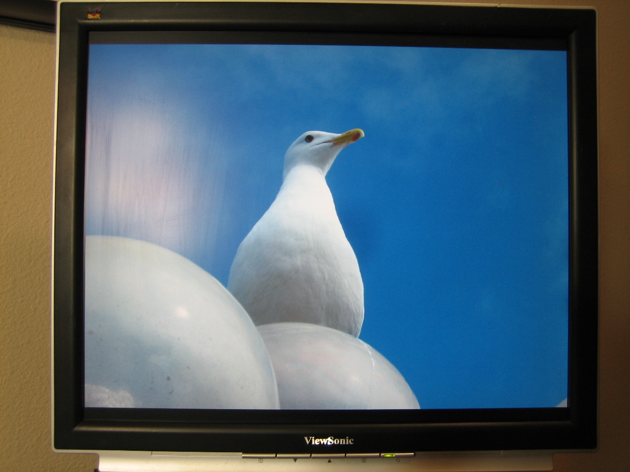

    This is my first post on this forum, so here it goes. I have a VX910 monitor that has an issue with the first backlight inverter circuit. When connected via DVI and turned on, the screen lights up with a good picture for ~2 seconds and then goes black. I have verified using a flashlight on the screen that the logic board is working. The power light remains a steady green, and the screen does not reappear if the monitor is left on.

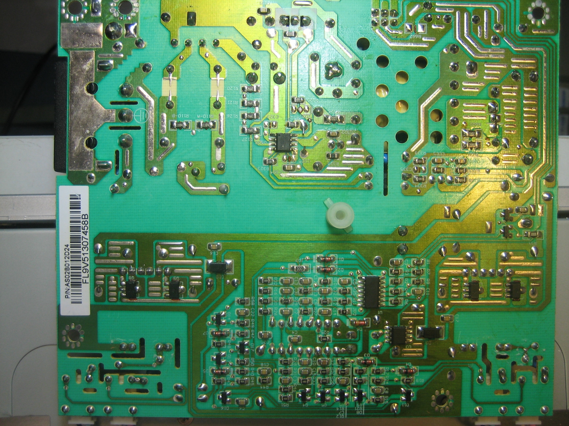

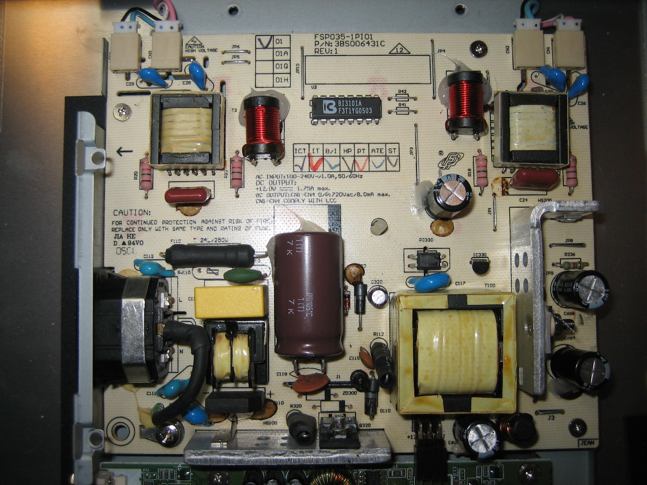

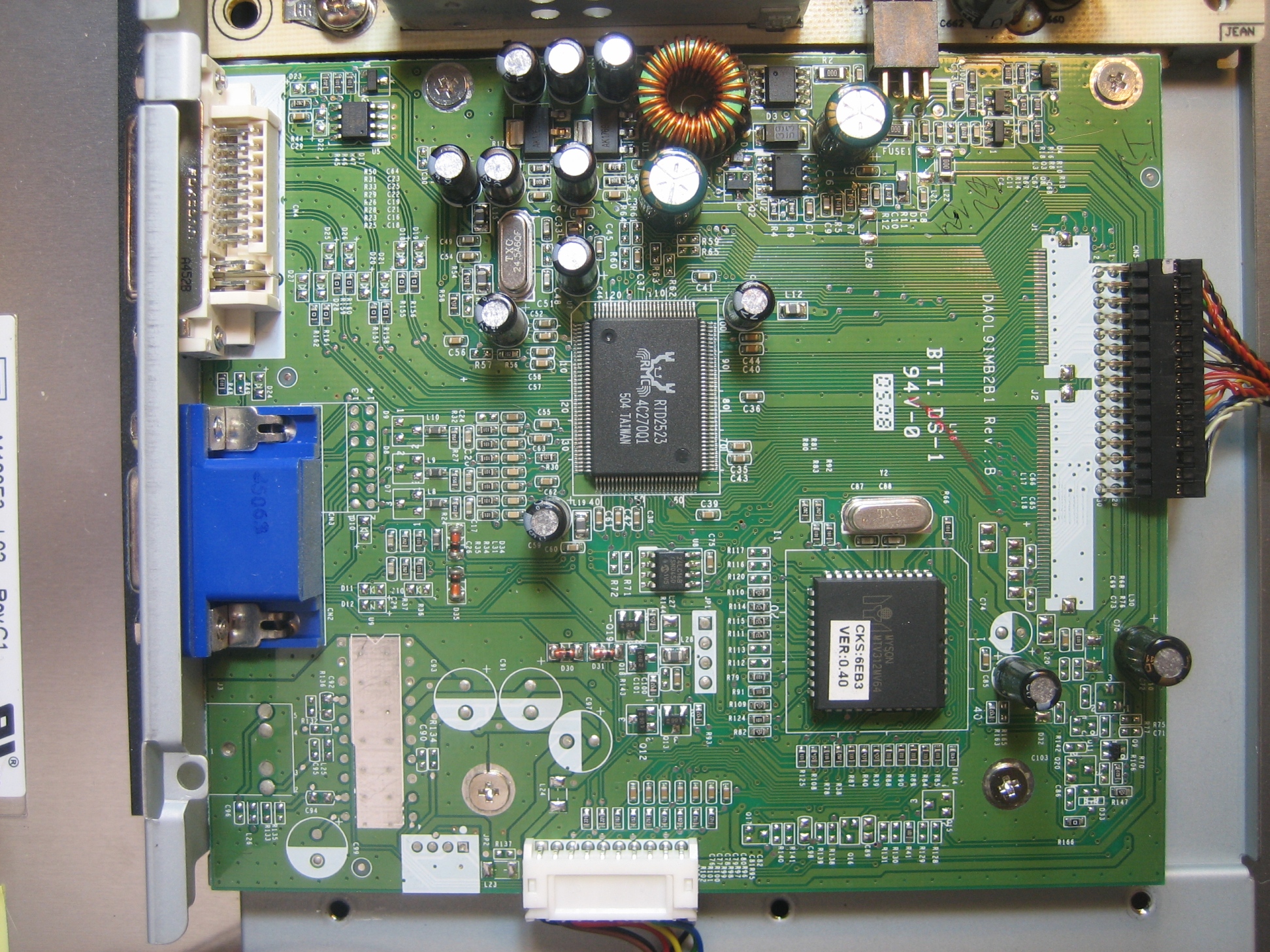

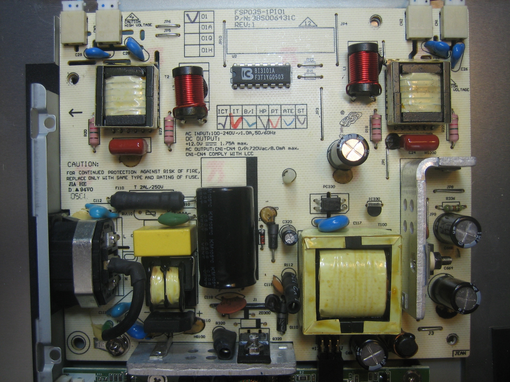

    Photos uploaded: These photos were taken prior to any components being replaced.

    First, excellent clear focused photos!
    It is rare that the blue and red high voltage caps are bad. If it is a cap problem, 99% of the time it is the electrolytic caps that are bad.
    On the secondary side I noticed a difference between the pins. T1 read 283 ohms between pins 2 & 4, while T2 read 426 ohms. While this doesn't appear that the transformer is shorted or open, would it be sufficient to shut down the inverter circuits if the power supply detects a difference between the two sides?
    Yes that difference is enough to shutdown the backlights. The transformer readings should be within 3% of each other.

            I received the new power supply this afternoon from Hong Kong. It is a used board which looked like it had gotten hot around the T1 inverter transformer and none of the caps appeared to have been been replaced, some were even rated at 85°C. I installed the board into the monitor for a comparison and the backlights came on and remained, now I know that the CCFL lamps are ok.
            For the next test, I installed the good T2 transformer from my original board into the T1 socket where the shorted transformer had been. I left the T2 socket empty and powered up the monitor and original board. The back lights came on for 2 seconds, showing that the T1 side circuit appears to be functioning.
            Finally, I removed the best looking transformer (T2) from the replacement board, checked the primary and secondary resistance (which were very close to my good T2 values) and installed it into the T2 socket on my original board and reassembled the monitor. Success!
            With all new caps, transistors, and two good transformers, I hope to see many more years out of this monitor.
              I wonder if the glue turned black on C24 had anything to do with T1 going bad?
              You might also consider removing the brown/yellow glue at the other red cap at T2, C320, PC33D, and HS100.
