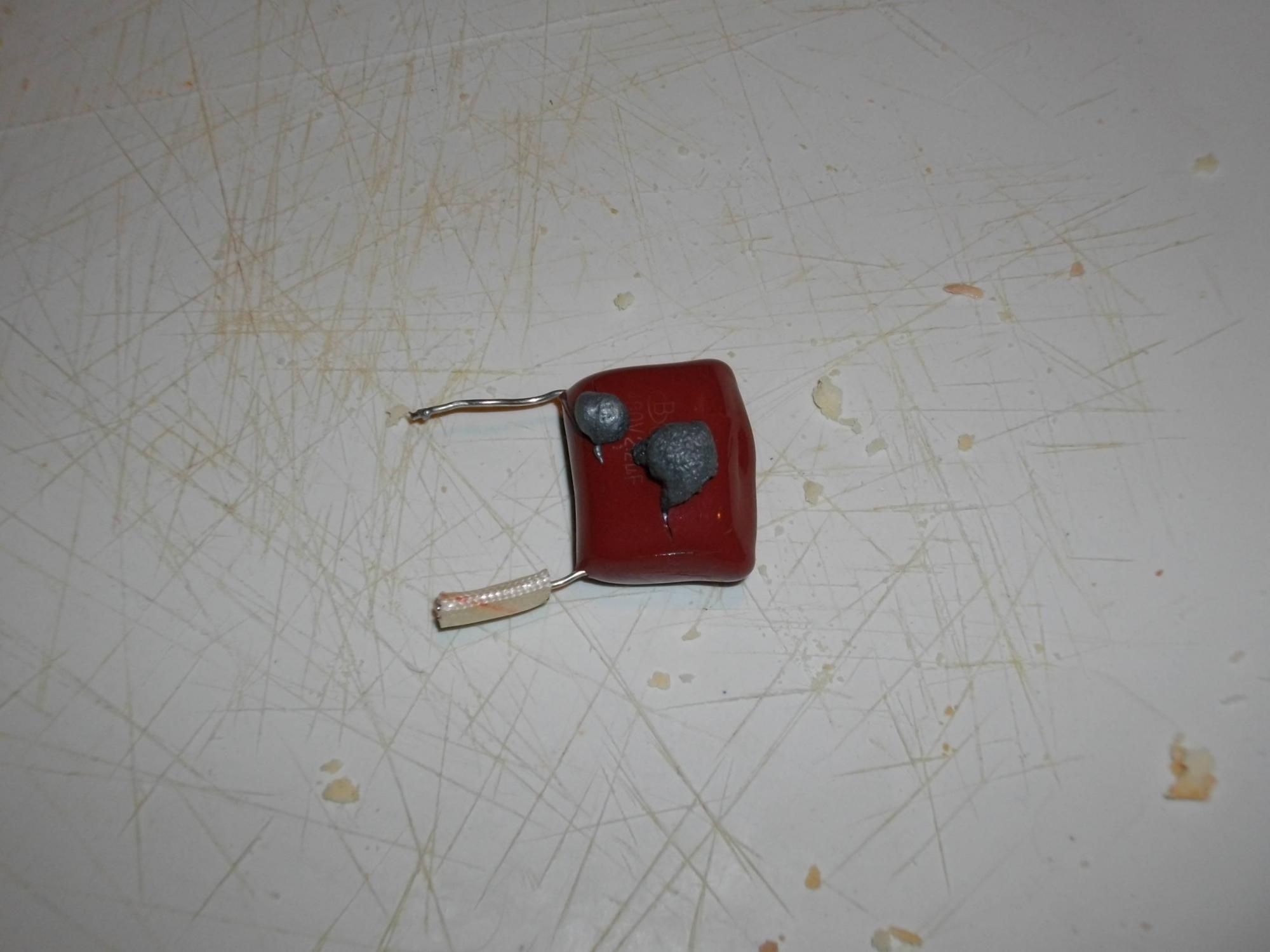

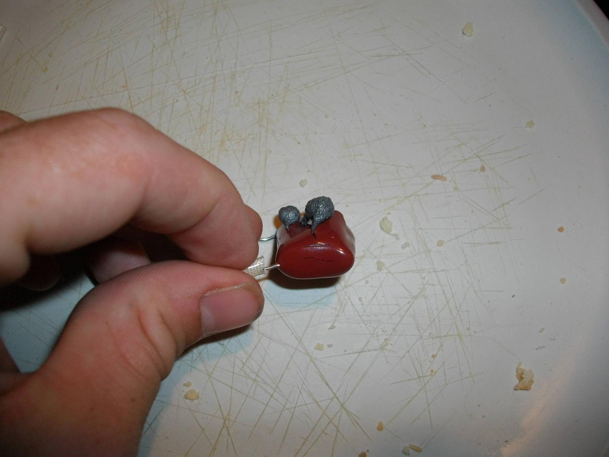

    Now THIS is a bad cap!
    Pulled from a Holmes "Blizzard" fan (Model HAPF622R). Fan would not power on whatsoever. Replaced this one cap and it's runnin nicely now.
    Never seen a cap of this type fail in THIS way before
  • Toasty
    • Jul 2007
    • 4171
    Re: Now THIS is a bad cap!
    See those type of failures in wall light dimmers when "standard" CFL's are used instead of incandescent. Or when used for any inductive load such as a fan. Probably caused by poor circuit design with that models "Breeze Modes". Install a 600 volt cap if you can.
      Will do, have a similar cap in there for now, ordered some 630V caps though.
          What's the glob of stuff coming out? Melted aluminium?
          • Toasty
            • Jul 2007
            • 4171
            Yes. Metallized polyester/polypropylene film capacitor. Difficult to tell but polypropylene is generally suggested for high current AC work.
                  new 630V caps arrived today (5 of them), one installed into the fan, all's well now, even runs off my inverters nicely, so I can use this little fella in my van when needed
