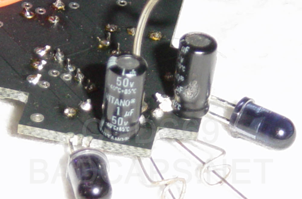

Reason the small caps don't need to be replaced?
  • incapacitance
    • Jan 2006
    • 29
    What was the reasoning for why the small caps don't need to be replaced? Will even the 100uf "Junkcon" caps stay good for a long time?
  • Topcat
    The Boss Stooge
    • Oct 2003
    • 16956
    Re: Reason the small caps don't need to be replaced?
    I've read they use a different electrolyte forumla. I don't know how true that really is, but in all my years, I've never seen the smaller ones fail. Rarely, I've seen 470uF caps fail, usually CHHSI's on MSI boards. On gigabyte boards, I've seen those 330uF 25v choyo's fail, which I always replace with 1000uF caps. If anyone else has some more insight on those little ones, I'd be all ears.
      The thing that I saw on various boards: low ESR caps are often all bad but general purpose ones are all OK. The small caps are almost always general purpose.
        Smaller caps are usually for local decoupling or timing circuits. They aren't subjected to the kind of ripple current stress the low Z types used in VRMs are.
          I've been wanting to post this picture for a while....this thread seemed a good enough reason.
          I damaged the cap when assembling this 'Solar Cybug' kit with the iron, but it worked fine for years.
          A few months ago (when discovering capacitor problems in my mobo) I noticed the bug had a leaky 1uF cap and it no longer behaved (steering circuit).
          Even though the leak was obviouly initially caused by my mistake, the hole in the side of the cap where touched with the iron is far worse now than when it happened. There has been much deterioration over about 5 years and that is quite a leak of white stuff from the bung!
              Originally posted by dood
              Can't really blame that on the cap, though
              Originally posted by cods69
              I damaged the cap
              I think I covered that.
              In answer to the OP's question, this small cap requires replacing.
