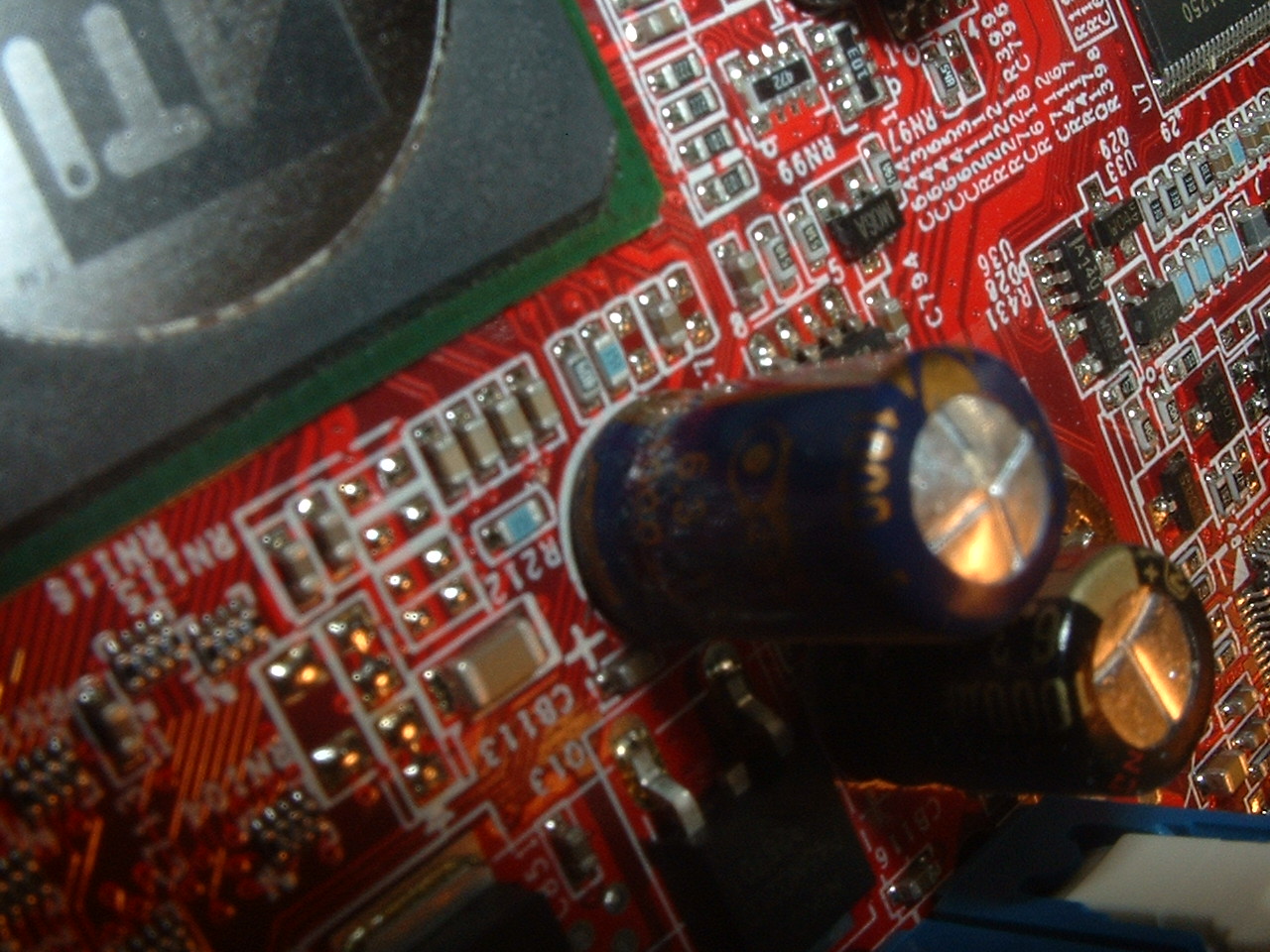

    I am working on an older E-Machine T6212 with a MS_7093 MB.
    It has at least one swollen cap. right next to the on board video.
    I would like to identify the manufacturer and replace it with a better quality part.
    Identifying markings:
    OST
    6.3v
    1000uF
    RLX
    O503
    105 C
    I posted an image. I will post better images when the board is out of the machine tomorrow. The colors are blue with gold print.
    Requesting any additional information on this issue.

    http://www.ost.com.tw/products_ec_competitive.asp has rubycon mbz and panasonic fj as replacements for the RLX series. The are more, but I only checked the rubys and pannys.

      You should replace at least all the OST that are 6mm and over in diameter.
      OST have a habit of going bad without bloating and as one has obviously gone south the rest aren't far behind [or have in stealth already].

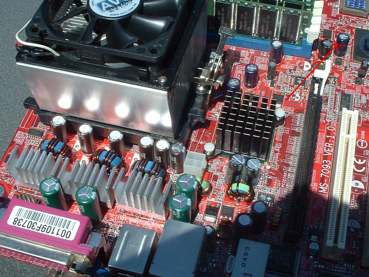

        Here are the additional photos. I hope these are much clearer.

            It looks like you have Chemicon KZG in the VRM/Vcore.
            Those [and KZJ] have the same issues as OST and should be handled the same way.
            [The other series of Chemicon are fine. Only KZG & KZJ have problems.]

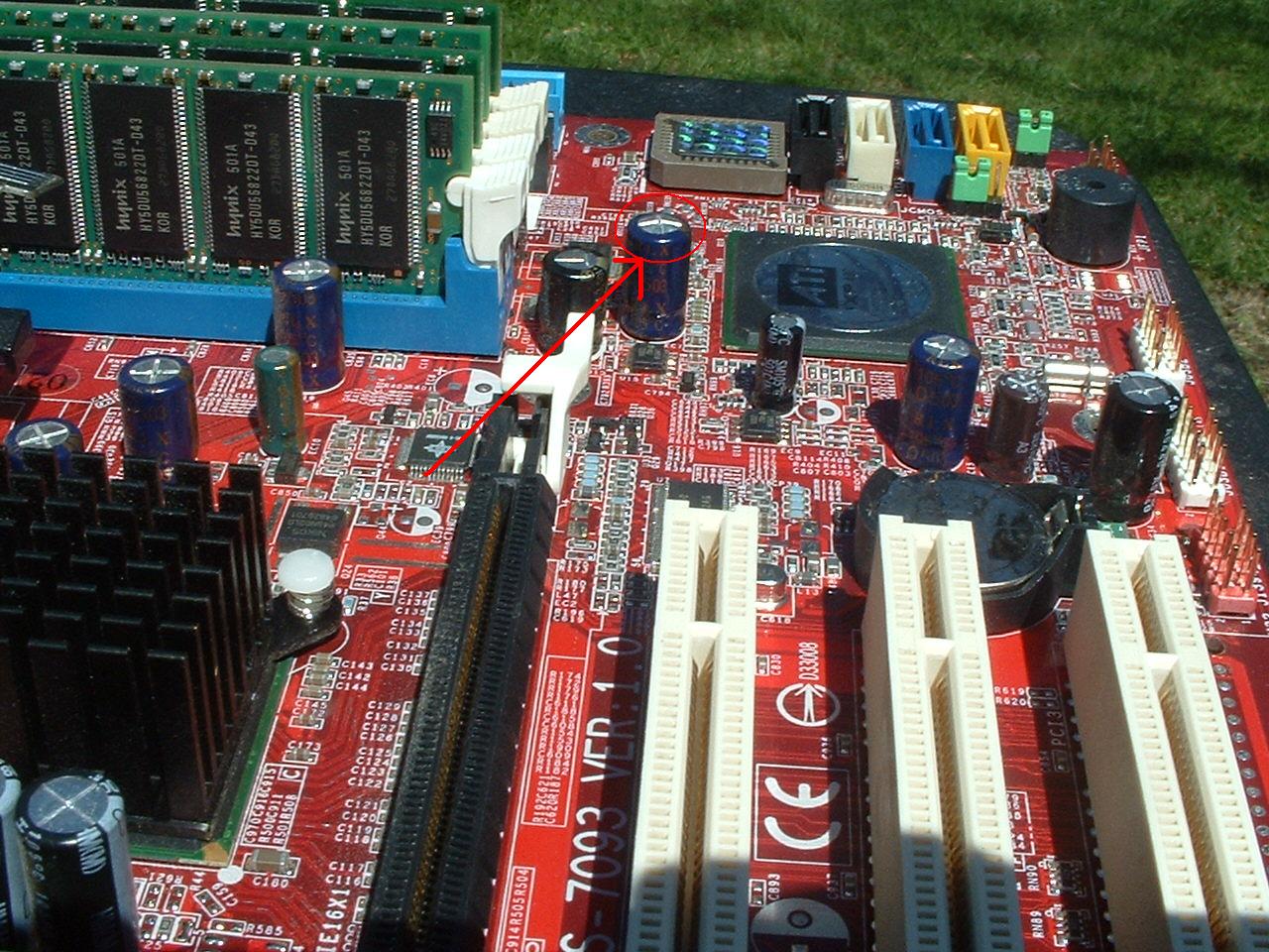

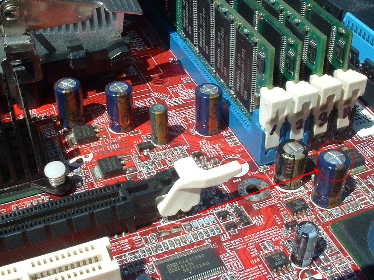

              You got the full treatment on that one!
              I see a Nichicon HM and on another Nichicon I see a 2004 date code.
              Nichicon HN and HM series were defective from 2001-2004 due to a manufacturing error.
              As with the Chemicon those are the only 2 bad series with that brand.
              [And only those with 2001-2004 date codes are bad.]
              You also have some Teapo scattered about but they appear to be smaller than 8mm and the small ones don't fail that often.
              RLX, HM, and KZG have comparable specs.
              They can be replaced with:
              MBZ [rubycon], GD [samxon], WG [sanyo/suncon], FL [panasonic], FJ panasonic, HM w/good dates [nichicon].
              Or these which are one grade better:
              MCZ [rubycon], HN w/good dates [nichicon], GC [samxon]
              If you would like walked through HOW to figure that out, I can do that too.
