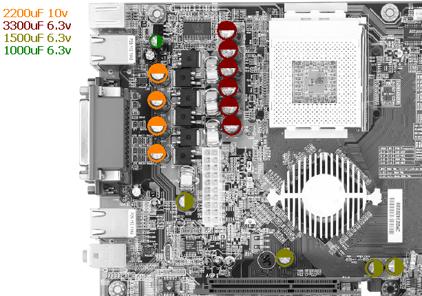

                About the lead of the caps, i dont think you should "hang" the caps even for 5mm above the PCB. I know because i've tried it & it just make overclocking worse. The caps need to be as close as possible to the circuit/PCB or it will negate the low esr/impedance value.
                About the board, this is yours...
                That's not many caps arround the VRM, compared to my 8RDA (NF2)
                pic is taken from Epox diagram
                So I'm now convinced that your caps need to be very high ripple curent and lower ESR ones. Probably you should replace all KZG there with some sanyo WG or MBZ/MCZ for the possibility of other deffect caps.

                      Last Viking suggested this:
                      He added the caps from back of the mobo in parallel to the existing ones. Sure it could help the mediocre Chemi-con KZG ones, however it is not a perfect (nor a usable) solution. I believe he could gain much better results by using Samxon GA caps, witch are far, far better the the KZG ones (see the table) and also maybe adding caps where they aren't anymore.
                      So, when I finally (3 weeks!!!) get my Panasonic FM caps from customs (help!) I started my project. Basicaly, I use the Last Viking recommendations and come up with this:
                      So, as you can see, I added a lot's of caps there. It looked amazing. However the mobo refused to post, always ending at diagnostic LED3 only on, witch is "Testing memory presence". So, since not even long cleaning of CMOS helping there, I pulled out the 470uF cap 11. It passed now the testing memory presence and end up at LED4, witch is "Early program chipset register before POST". In short - VGA is not present/inicialized. So, I pulled out caps 16, 17, 18 and 10 and it finally posted! Hoooray! Everything seems working well, untill I inserted Audigy and FX5600 card. Then 4LOD and nothing more - time for another 30min cleaning procedure
                      So, I keep pulling out caps that I added there, but nothing improved. I ended up in mobo w/o any extra caps, but I still cannot insert any more power hungry deviced to the PCI / AGP Looks like the mosfets there or something get damaged as well?
                      The 12V support power connector get a bit yellow from the power that goes there when things failed and since my PNY 6800GT and Audigy2zs working well (I'm using them right now) then I have to suspect something wrong up there into the powering part...
                      Other than that - the mobo is EXTREMLY stable and working well right now folding for me - with very poor oldie Barton witch has "wall" at 2200Mhz that not even 2.00Vcore can break - so the mobo running right now at 200x10.5 - 11-2-2-2-9-12-0-0-3-3-2-0-3-E-E-F-E ultra DFI timings and entierly stable. I installed WinXP on it and folding 100% CPU load and no crash or problem are there.
                      So - sucesfully recaped.
                      However there is still a large problem with powering of the slots, so any suggestions where to look and what to measure, yet, I'm affraid I have first remove the heatsinsks from the mosfets that powering the slots:

                                          At the moment most VRm and PSU circuits are using powdered iron cores. The main reason ist due to their slow and well controllable saturation point and the distributed air gap.If frequencies will futher increase well beyound the current 300khz, the ferit cores kick in. At those low frequencies there is no way to use ferite.
                                          i think trodas, you can belive what there is stated, noting wrong.
                                          If anyone will see, what mobo manufacturer has done with the VRM circuit, lock at the controler chip an google for the datasheet. I `ve read the datasheet of st`s L6917D, as for locking which replacement caps are suited for my k7s8xe+.
                                          It showed me klearely, that Asrock saved some buck on caps, regardles they are using good ones. In that datasheet are al things explained with only the needed equations.
