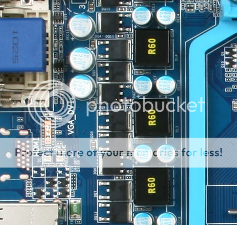

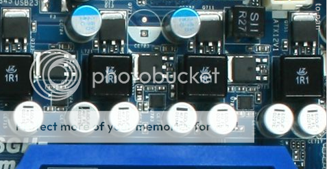

    Anyway. A friend and I are looking to start up a small computer building business to sell to a niche market. (Senior Citizens). We are going to be running a heavily modded version of Ubuntu to help accomplish that.
    However, we are looking into possible motherboards for our PCs and we really are trying to get the cost of the computer down...quite a bit. These have to be affordable. We also need lots of features on the board so cards etc. are not needed. The rear I/O panel has to be as simple as possible and free of any thing that might confuse them. (Ex. Trying to plug a monitor into a serial port etc).
    Question:
    So, after some research, using Newegg as our search engine, we came up with these two boards.
    BIOSTAR A880G+ Link
    ASRock 880GM-LE Link
    Unfortunately, these boards are using some lovely :sarcasm: OST electrolytics. I know OSTs aren't regarded as very good, but to what degree do they suck? Our next viable option is about $15 more, which would have all Sanyo/Os-con solids, but $15 is quite a bit when you are actually trying to make profit.
    Dell/HP/Acer get away with tons of electrolytics on their boards. I doubt they are all using Chemi-cons...though I don't know that for a fact.
    Two more questions:
    The dark blue solid polymer caps on the Biostar board; What brand are they?
    The silver and black solid caps on the ASRock board (not the turquoise ones); What brand are they?
    Any insight?

    The first board has so-called "Elite" polys. I think kc8adu has seen a few of them fail shorted before. The caps on that ASRock motherboard are not polys (solid caps). They are Panasonic FL, which are generally very reliable series of electrolytic cap.
    To answer the title of the thread, OST stands for Only Some Trash. They are junk and often fail without showing any visible signs.

        Shoot. Yeah I was just assuming those were solids but they didn't have the same traditional polarity color marking...
        Wow, so it appears that I have a board full of junk in exclusion of the maybe alright Panasonics. Well, I guess we'll go for a little bit more....I don't want old people to have to deal with exploding caps...
        But if you had to choose. Would you go for the so-so Elites or the Panasonic electrolytics as far as quality and stability goes?
        And the turquoise once are like FZ or something?
              FZ's, replace those ASAP!! Search 'sacon FZ' here and see the horrible results you'll come up with. Those caps are the cause of a lot of dead hardware, especially video cards.

                Look like UCC poly. Don't see the K vent like usual on FZ.

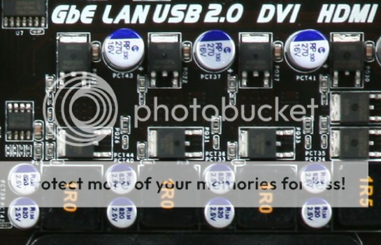

                        Get a Gigabyte board with all-solid capacitors.

                          That Gigabyte board looks good. The caps in the picture are Chemi-con PSC polys, which are very reliable. Gigabyte is also one of my favourite brands. They don't often use bad caps, usually either Nichicon HM, Sanyo WG and/or Chemi-con and Sanyo Polys
