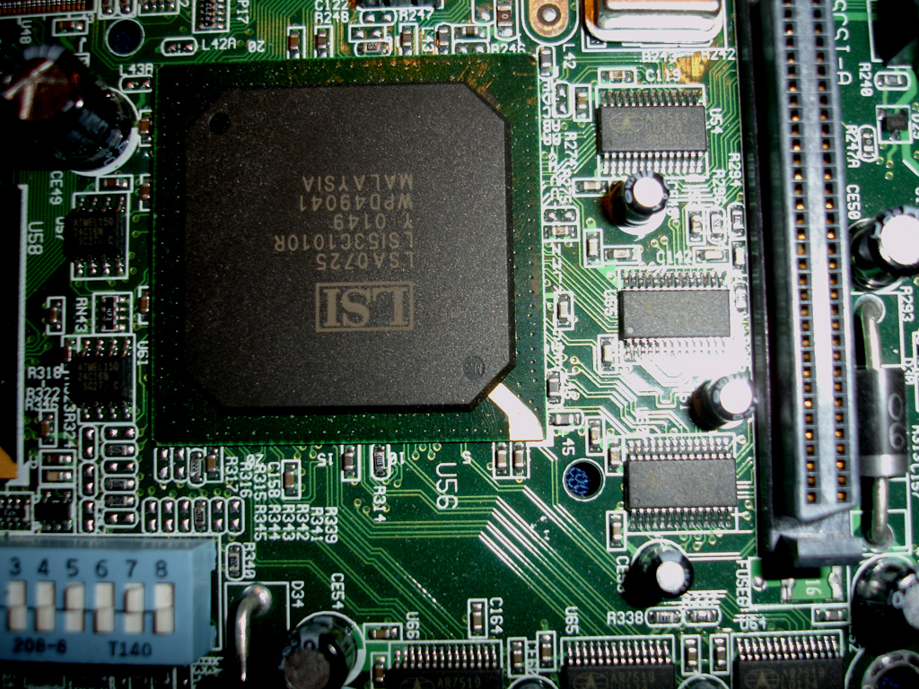

    Little Caps can be BAD
    Here's a Pic of my Asus TR-DLS motherboard with onboard SCSI that is misbehaving. The little caps I believe are 10uf 25v and a grouped near the SCSI chip. I measured their ESR. It was 8(!!), I'll be recapping as the board works great other than this issue.

    Thats certainly possible, just not very common. On the SX280, theres a 22uF @ 25v by the CMOS battery that fails all the time. Strange one to fail, and many times fails without showing any physical signs. It will usually just go open, and make the board exhibit all kinds of odd behavior.

        Since these caps are right beside the 68-pin onboard SCSI connector, I am assuming they are in this circuit.

            So I replaced those little stinkers. When I got them off the board they all measured around 4
            ESR value. Replaced them with Nichicon PY 10uf 25v. There were 6 scattered among the SCSI chips. A real swine to remove and clean out the holes. Made extensive use of the "add fresh solder" to remove the caps and also to melt the solder in the hole for the pin-method. All went according to plan. I noted that the previous owner had set the onboard scsi jumper to disabled. Changed that and attempted to boot from the harddrive. Realized that the HDD had Adaptec drivers loaded and the on-board is LSI, so that didn't work. Did a fresh install of Ubuntu, crossed my fingers, and voila! Success, boots and runs fine.
            The board still needs a recap though. It's responsive, plays video etc, but I got it to freeze by loading a CD into the tray while a youtube video was playing. Locked up the video, lost the mouse. Had to restart. A little later lost the mouse again. After that I got a lock when I tried to change the Desktop background. This is over the course of three evenings.
            I figure server boards should just automatically be recapped, the caps are just "tired".
            I'll start with the 6 Nichicon HD(M) 1220uf 16V from 2002.
