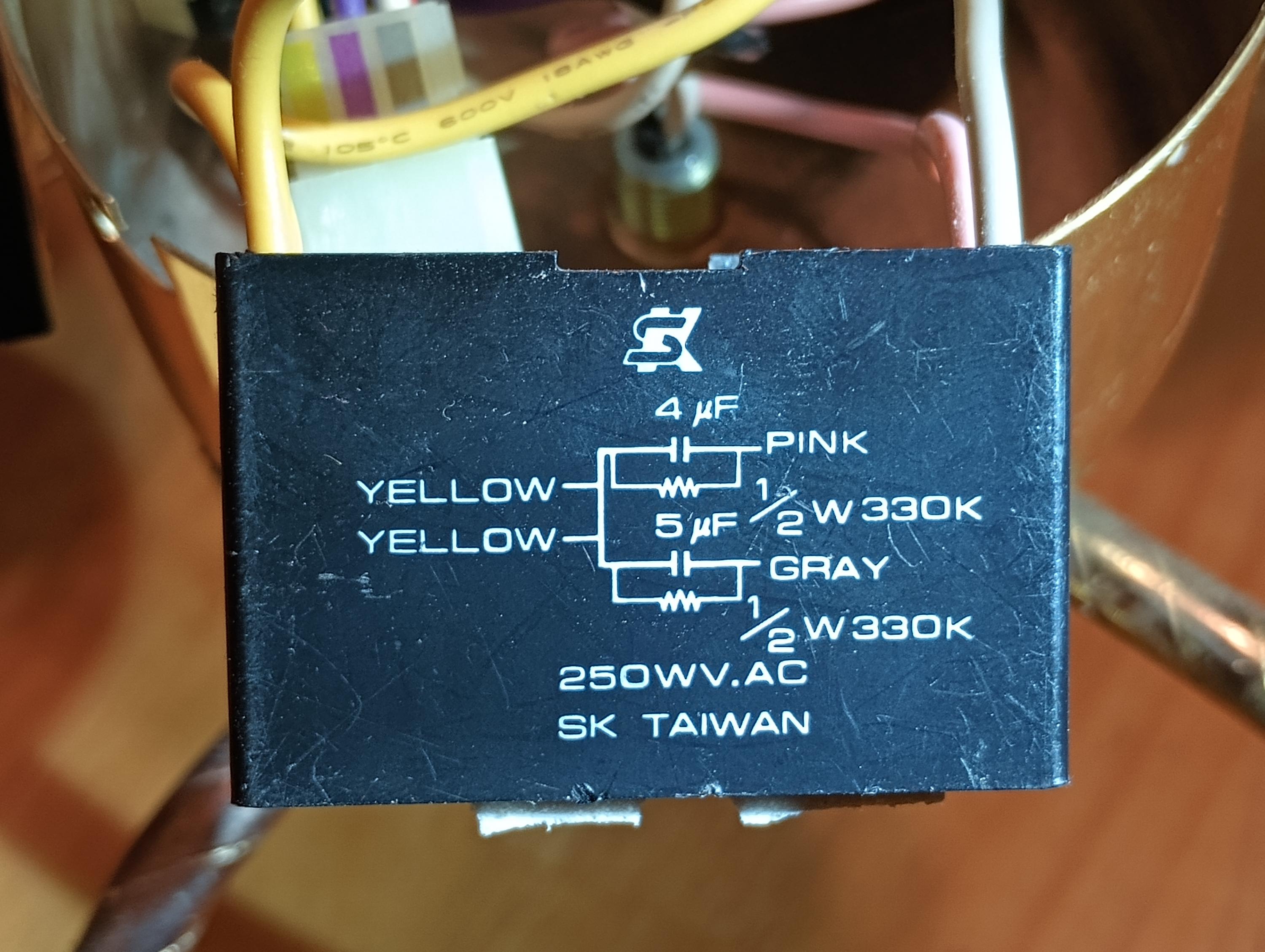

    Perhaps someone could provide some direction.
    - Ceiling fan, 25 years old, used 2/3 of every year but very clean.
    - Temps dropping so I shut it off one night.
    - The next day, after starting it the motor area began producing a subtle but strange noise that I can only describe as imagine two Phillips head screwdrivers and occasionally one of the screwdriver shafts slides down the other (a clean metallic scraping). The repetition is random. Only happens wen the motor is running (the bearings are fine). I tightened all mechanical components.
    - Then the medium speed (the speed it is mostly run on) started slowing.
    I'm glad to replace the capacitor (image attached). But for the life of me I can't reason out what I'm hearing or why. Can a failing capacitor cause such a strange noise as this?
    Thank you for any input.
    • 31288
    Re: Ceiling Fan Capacitor
    if you turn it by hand is there any friction or wobble?
    the thing in the picture looks like it's for interference suppression

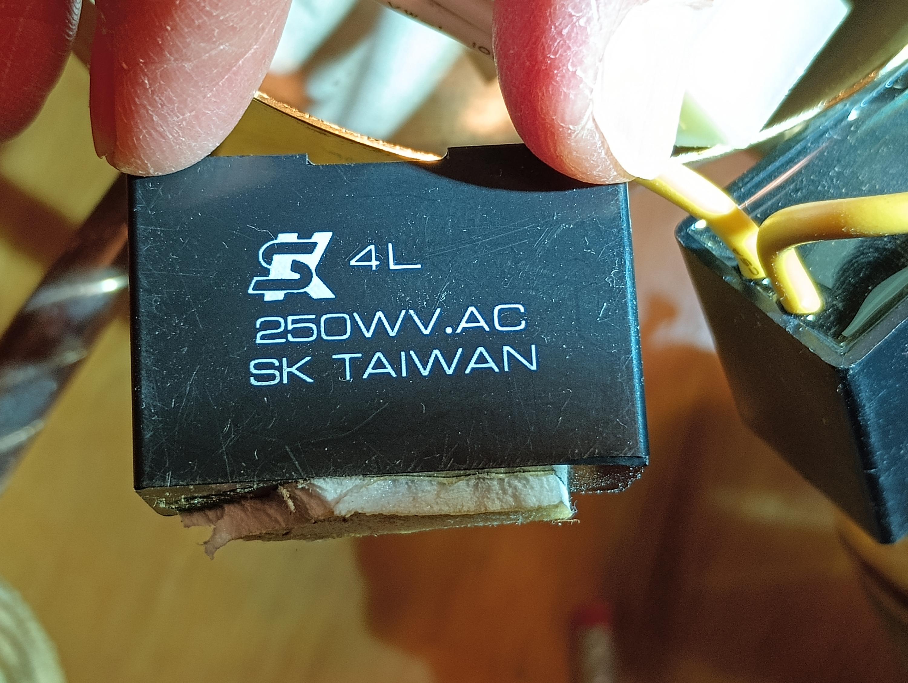

      Thank you. Sorry, I was not aware of inclusion of interference protection.
      There is a second block labeled 4L (photo attached). Would that be a run capacitor? Do you know what 4L indicates?
      The subtle noise seems to me to be excited by motor magnetism as far as I can tell. It spins very free by hand and has no wobble.
        It is likely 4µf 250vac, they are listed everywhere as fan capacitor
