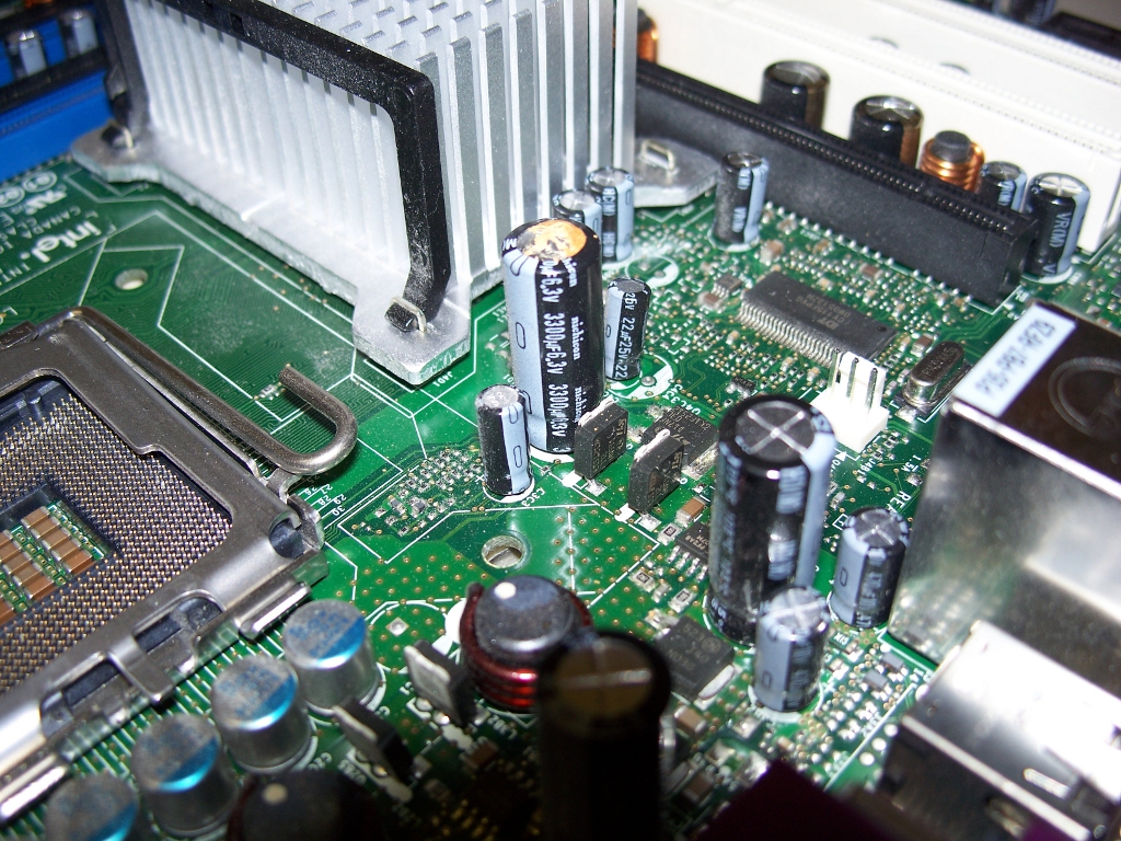

    Spotted this on an Intel 775 board. It's the only one that has popped.
    I thought Nichicon were ok caps? Just a random bad one?

    Whats the date code on it?

      Lol yeah my intel 955 chipset voard has nichi hm with an 04 datecodes. But they never got a chance to fail cuz my lousy psu fried it.

        If it's still on the bench tomorrow morning I'll get back to you.
        Where should I find the date code? Other side of the cap?

          It usually look something like H0422 (2004, Week 22). Nichicon HM and HN had manufacturing defects which they fixed on 2005, so if the date code is 2005 or older, then that might explain why it failed

            That looks just like the blown Nichicon HMs that i have right here, i'm 90% sure it's the same cap. So it's from the faulty series.

              The board also has Nichicon VR series which are 85C and can be a problem in poorly cooled systems.

                The cap is marked for "H0510", or 2005, week 10.

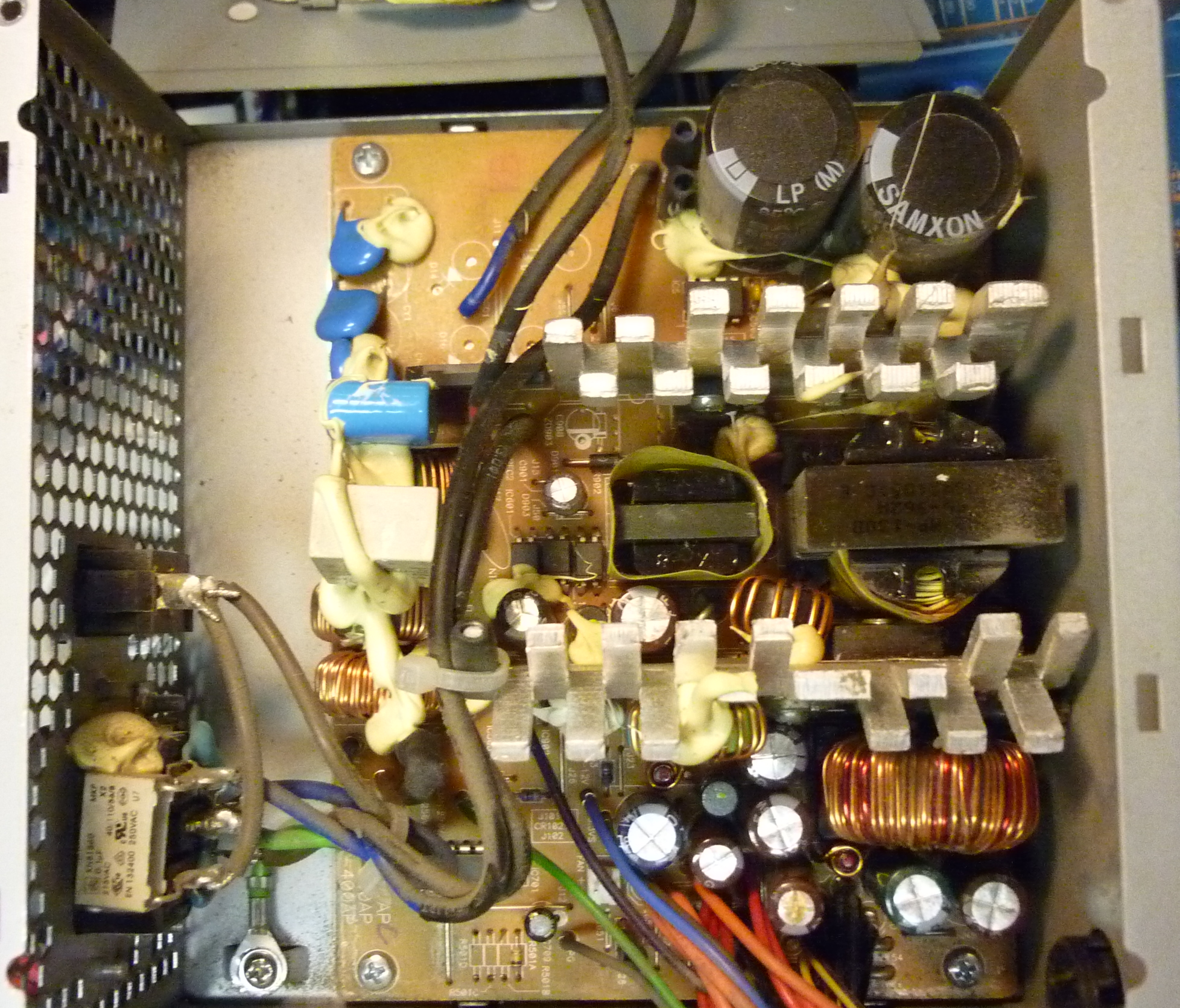

                  It's next to a mosfet, which may get very hot. Checked the PSU?
                  I have a slew of ASUS 945 boards being "destroyed" by bad ASUS branded Delta PSUs. There's one particular KZG cap that cooks next to a mosfet - meaning the SATA controller stops working
                  I'm pretty sure the faulty PSU caps causes the mosfet to get very hot, cooking the KZG cap.
                  Maybe something similar has happened to you?

                    You had a fault asus psu? I need to know about that. Bexuase i have one. And i consider it high end becuae its really heavy and has good 12v ratings for 300w. Is the 300w asua the one you had tha was faulty?

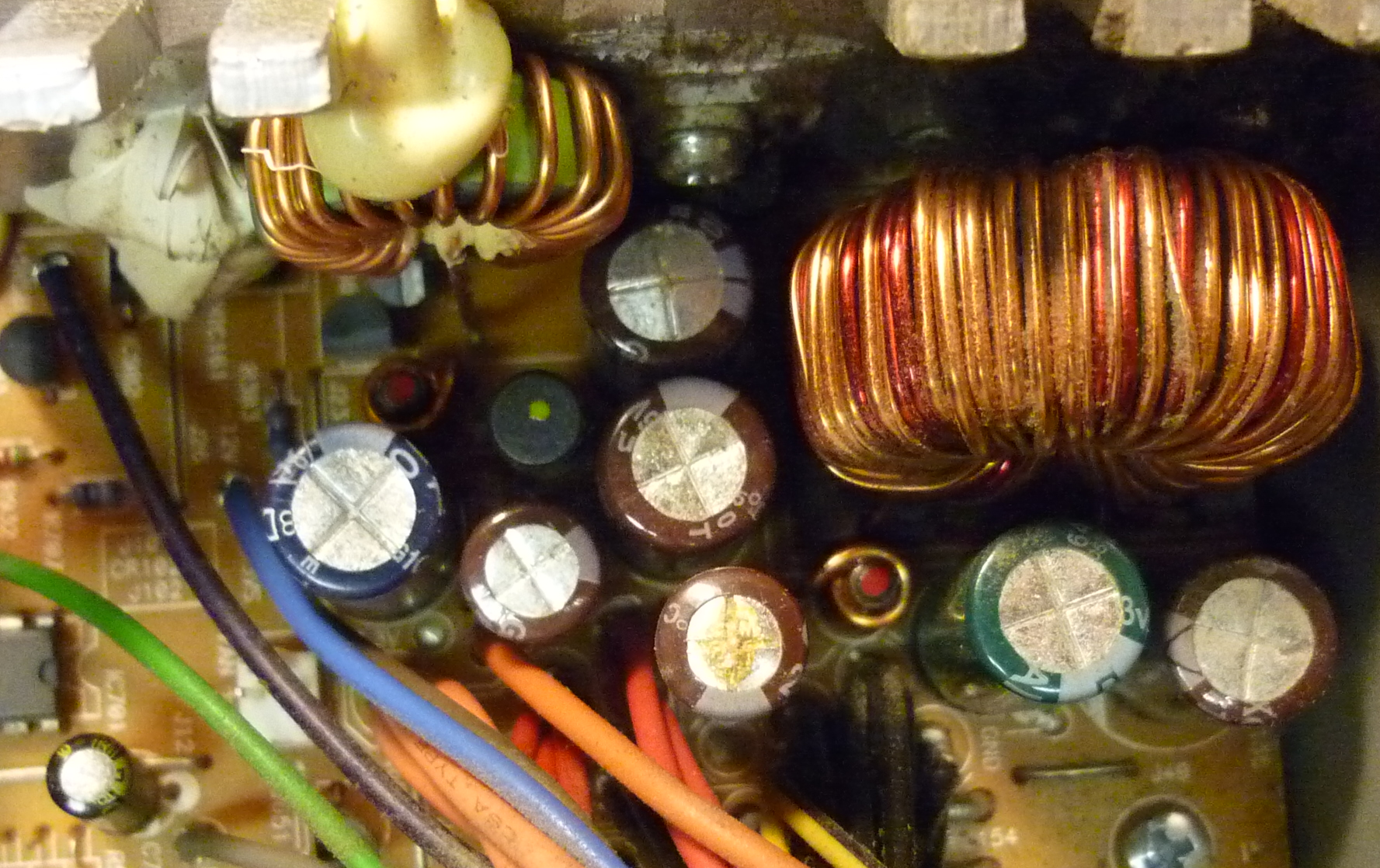

                      I don't have one, I have four. Five, if you count the first one I threw out, thinking it was a one-off dud.
                      Open it up and check!!
                      There is a very tall, slim Capxon 2200uf 6.3v cap that usually failed.
                      There is also another one that has failed in some, think it may be a 2200uf 16v - can't remember exactly.

                                Mine actually says asus in big letters imprinted on Its casing. And it has bigger heatsinks. And it has an 80mmfan on the end not the 120mm on the "bottom"???

                                  I have verified that my psu is different. It has jamicon secondaries, bigger heatsinks, more density, etc. It also said bestec on of the transformers. So its really a decent psu. Asus s-30fp.
