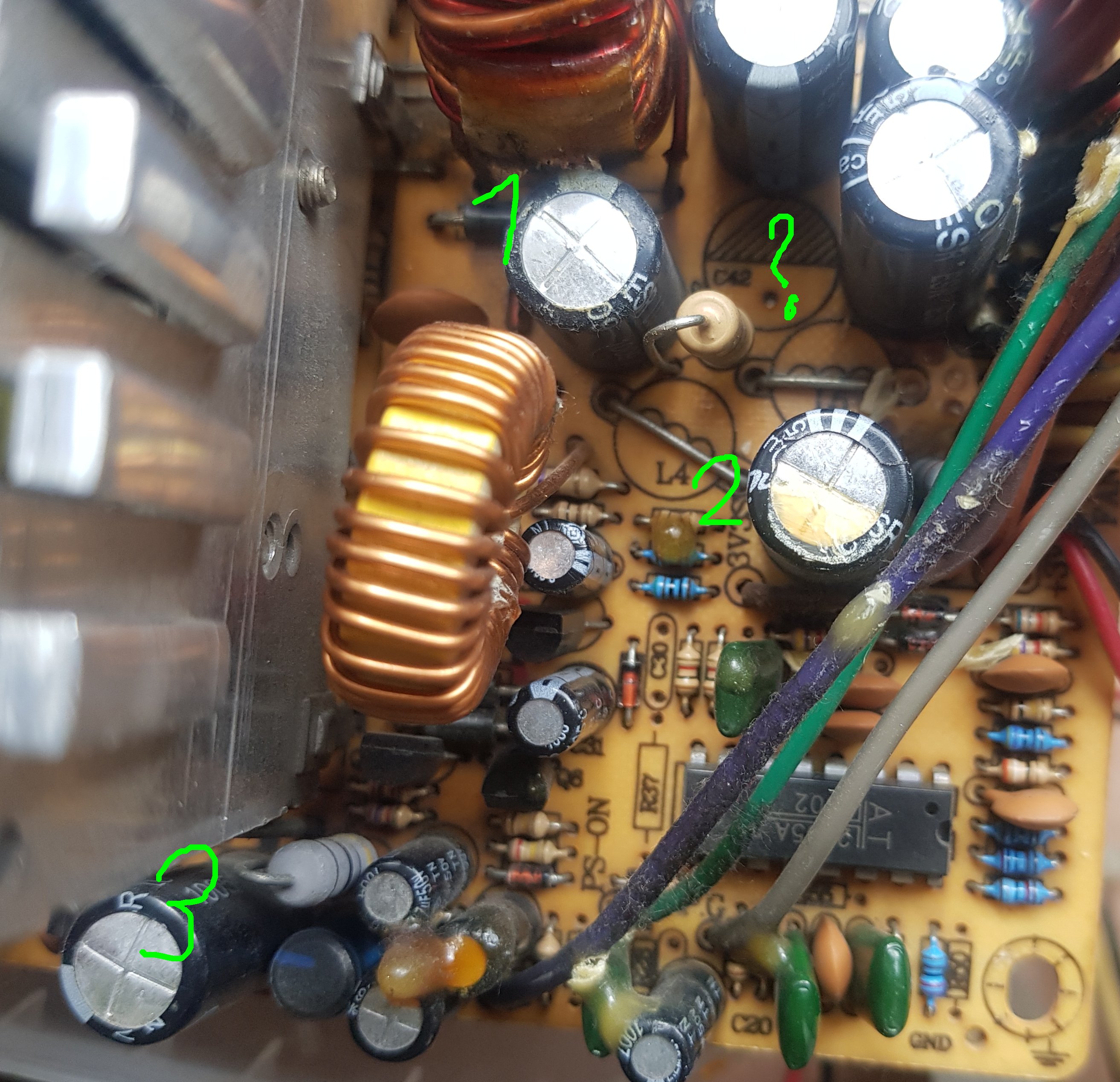

    hi. psu works, but it was loud and filthy so I opened the case to dust it.
    2 caps in the picture has a transparent yellow stuff on top of them but I'm not sure if they leaked or it's some kind of glue.
  • R_J
    • Jun 2012
    • 9609
    Re: leak or glue?
    That is glue, remove the glue from the one next to the coil to see if it is bulged under the glue, if the top is flat it is likely ok but you can not tell just by looking.

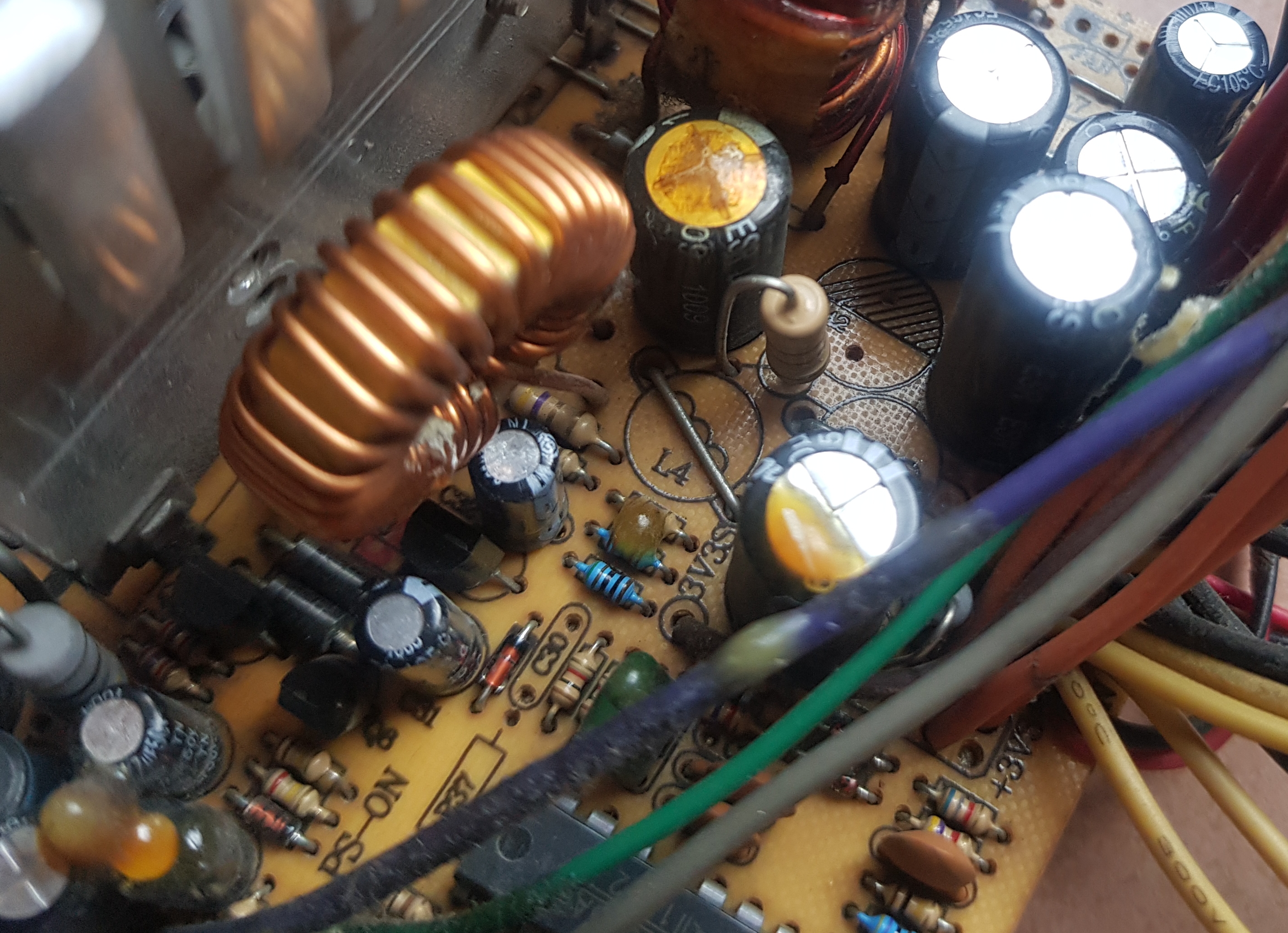

      Re: leak or glue?
      1, 2: Conicon 1009 - 1000uf 10V Low ESR
      3: Conicon 1005 - 1000uf 10V
      (1) and (3) looks slightly bulged, 2 isn't.
      I bought 2 no-name 1000uf25V caps from local store but I'm not sure they'd be fit as low esr replacements.
      Also wondering if I can install something in place of C42 which was left empty in factory.

          Re: leak or glue?
          Yes those two caps are bulged, and are bad, that is usually due to being close to the inductor that will run fairly warm, The cap at location C42 is likely parallel to one of the other caps, and not required. You may want to replace those two small electrolytics next to the coil as well, they won't bulge like the others but will just dry out from the heat.

            Re: leak or glue?
            The cap you labeled #1 is next to an inductor that could get hot and a pre-load resistor that is also dissipating heat. I suggest leaning the resistor a bit farther away from the cap.

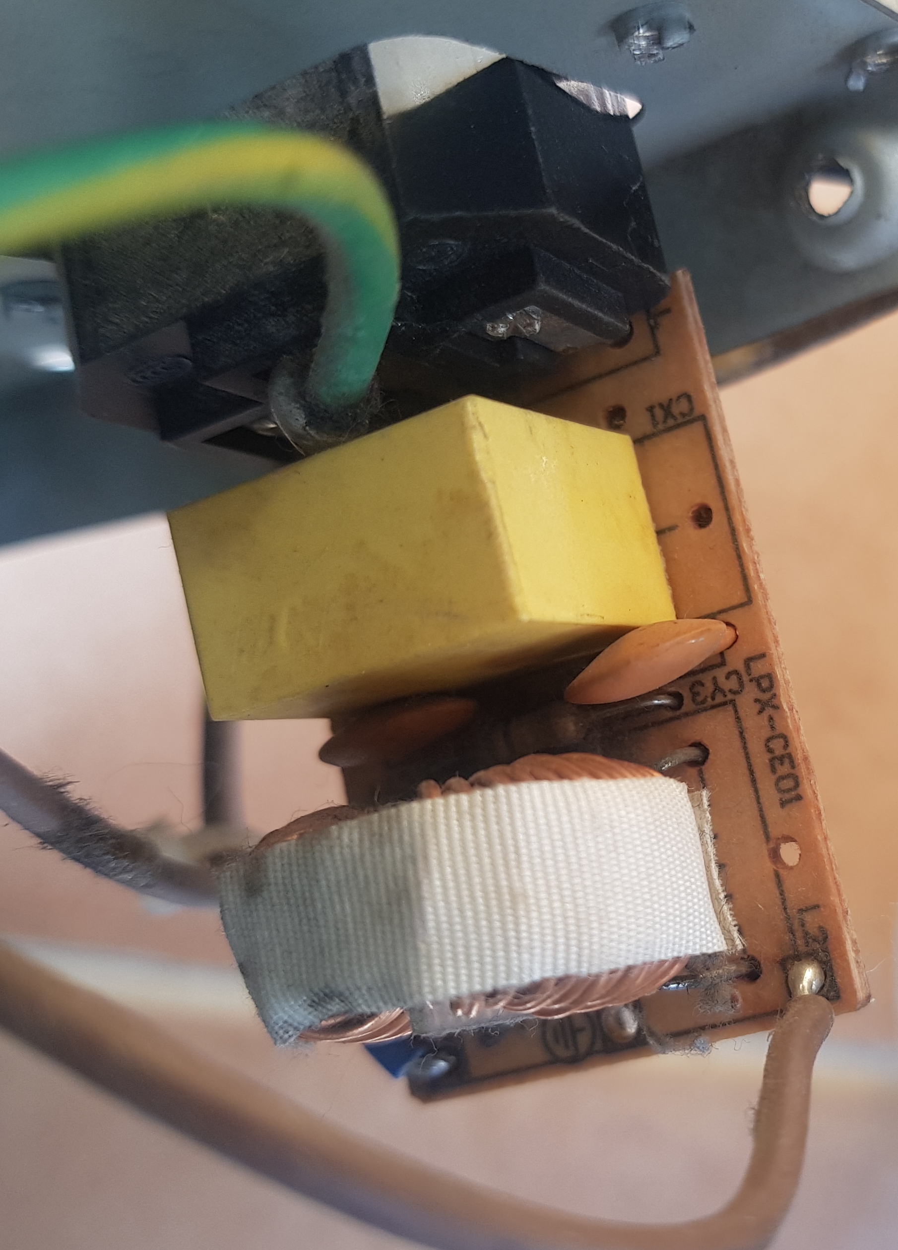

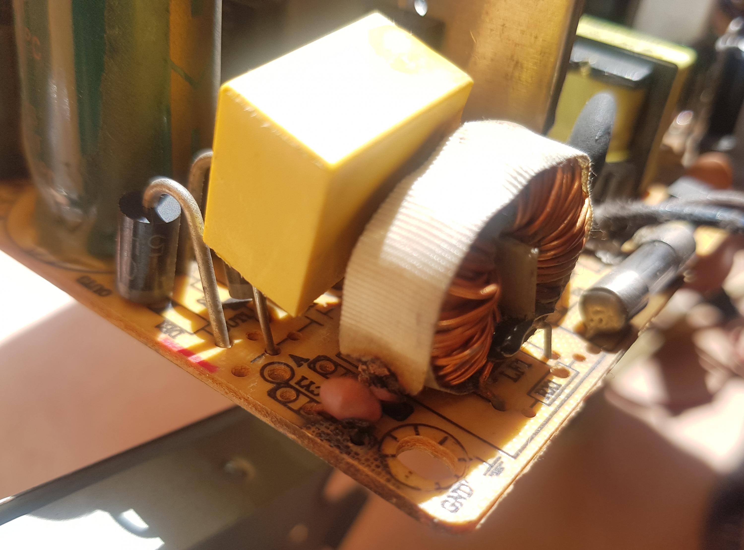

                Re: leak or glue?
                Here I present CY1
                I'm starting to think maybe it's better if I'd re-assembled this without any recap and only use it as power source for the tire inflator from now on

                  Re: leak or glue?
                  Originally posted by hinisa
                  Here I present CY1
                  What happened, is it corrosive glue or has the capacitor shorted?
                  Using ceramic caps for this type of circuit is just insane!

                    Re: leak or glue?
                    it has only 1 leg left other one looks burnt. psu still works splendidly, though.

                      Re: leak or glue?
                      Yea now I see it, there is one behind it that appears to have exploded too.
                      This is a prefect example why safety rated capacitors are required here.
                      But also why it is so idiotic to put regular ceramics: they can just be left out and the thing will work fine anyway!
