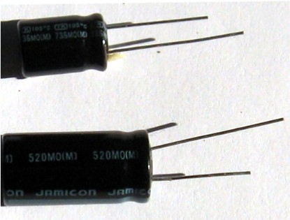

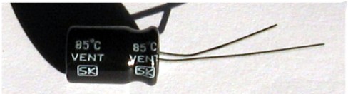

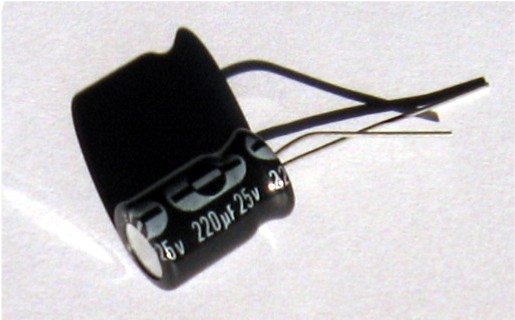

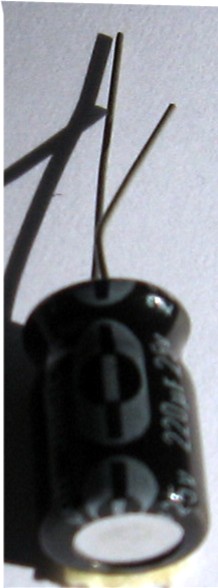

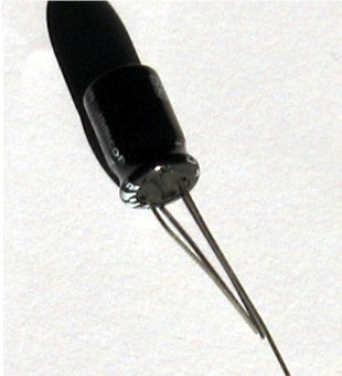

    Suspected black light grey Jamicon
    I can't test ESR, so please read below or take a look:
    Jamicon
    85°C
    VENT
    SK
    As you can see in pic 1 & 4 the pressure valve got no "typical Jamicon vent style".
    SK series aren't for motherboard, probably neither PSU.
    I bought it in december 2008 from a reseller (that solds new, old and very old caps), unfortunately there's no date code.
    My intention is to use this in a 1990 tv, of course only if it's a real Jamicon.
    Is this SK real Jamicon or not?

    Re: Suspected black light grey Jamicon
    That caps probably ancient if it doesn't have a vent on it at that value.
    I have some old removed Panasonics at 1000uf without a vent they make good firecrackers. When I reverse polarity overvolt them on a variac.
    Only if it's a real Jamicon you do know that Jamicon's are crap right? Doesn't look like the negative band on any Jamicon caps I've seen. Based on the design and print on caps that I've seen in older equipment I've opened that cap looks like it was manufactured in the 80s.
    Jamicon SK series looks like this:
    Use a real cap brand like Panasonic, Chemicon, Nichicon, or Rubycon and stop playing with these no name crap caps. Do the repair once and do it right.
    Chemicon KMG series for example is a good General Purpose 105C rated cap that would work for your situation.

      Pretty sure Jamicon OEM's their caps. [Outsources manufacturing.]
      I agree with Krankshaft: Those look old.

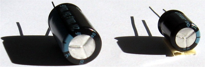

          Thanks to everybody, this confirm that my reseller sold me very old caps.
          I have some Rubycon with and without a vent and they're marked with date code:
          8319 without vent
          8940 with K vent
          both are CE W series.
          I bought them two years ago. I will not buy caps anymore from this reseller.

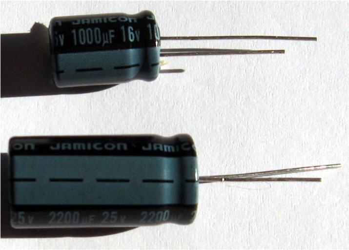

            all the jamishit i see is a vivid blue colour with black print.
            • alessioblaupunkt
              • Aug 2010
              • 50

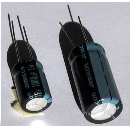

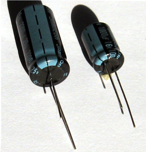

              Hi stj, I also have the black / vivid blue colour Jami.
              I will upload some pic of the latest Jami TK series.
              They are modern Jami.
              • alessioblaupunkt
                • Aug 2010
                • 50

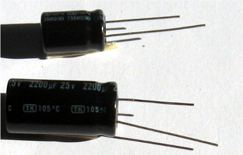

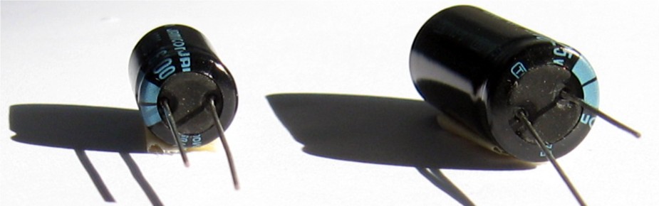

                Here are the vivid blue / black TK series.
                I bought them two years ago from another reseller and I don't know how to decode the date code.
                      Don't worry about the date code, at least for the black ones. I have 16v 2200uF ones that i use in a class A headphone amp of my own design, which feeds on 18 volts. They don't mind the overvoltage, no heating, bulging or anything.
                      BTW you will see Jamicon caps sold in many electronics stores as "general purpose". They aren't excellent, but they will do the job.
