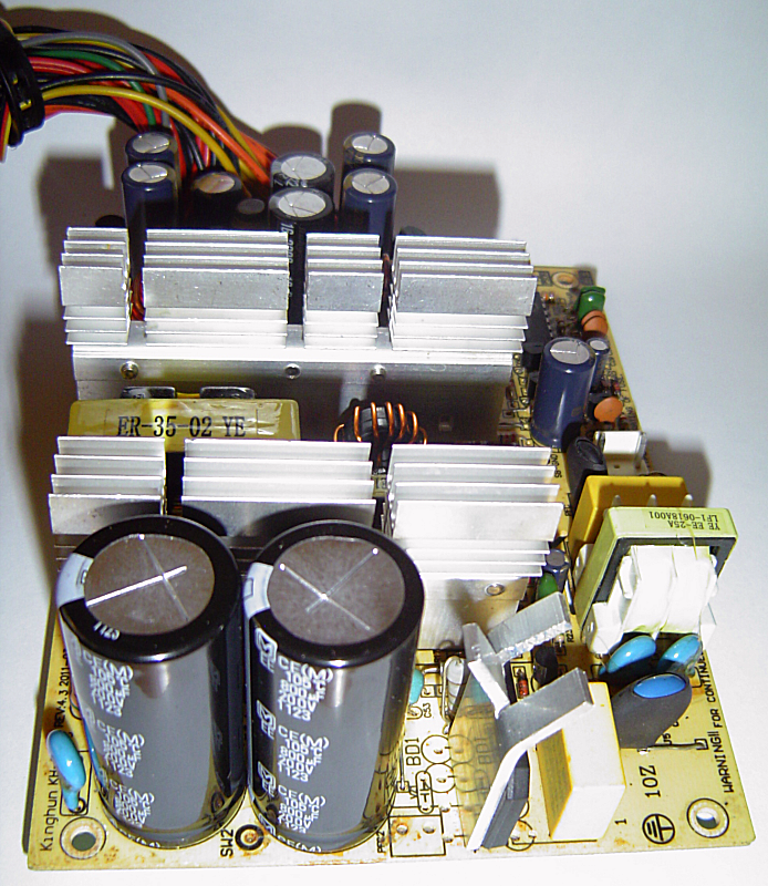

                Just a small footnote here. You may have noticed that large capacitors, especially in PSUs, have a plastic cover on the top. At first I thought this was foolish, as it was covering the vents and could lead to violent failure.
                In fact, the plastic is there to provide electrical insulation. Big caps like these are frequently fed with mains voltage or higher, and the top of the cap will be at this high voltage. If you touch the top, or if something conductive comes into contact with a high-voltage cap like that, you'll get a severe electric shock!
                You know there's something wrong when you open your PC and it has vented Rubycons...
