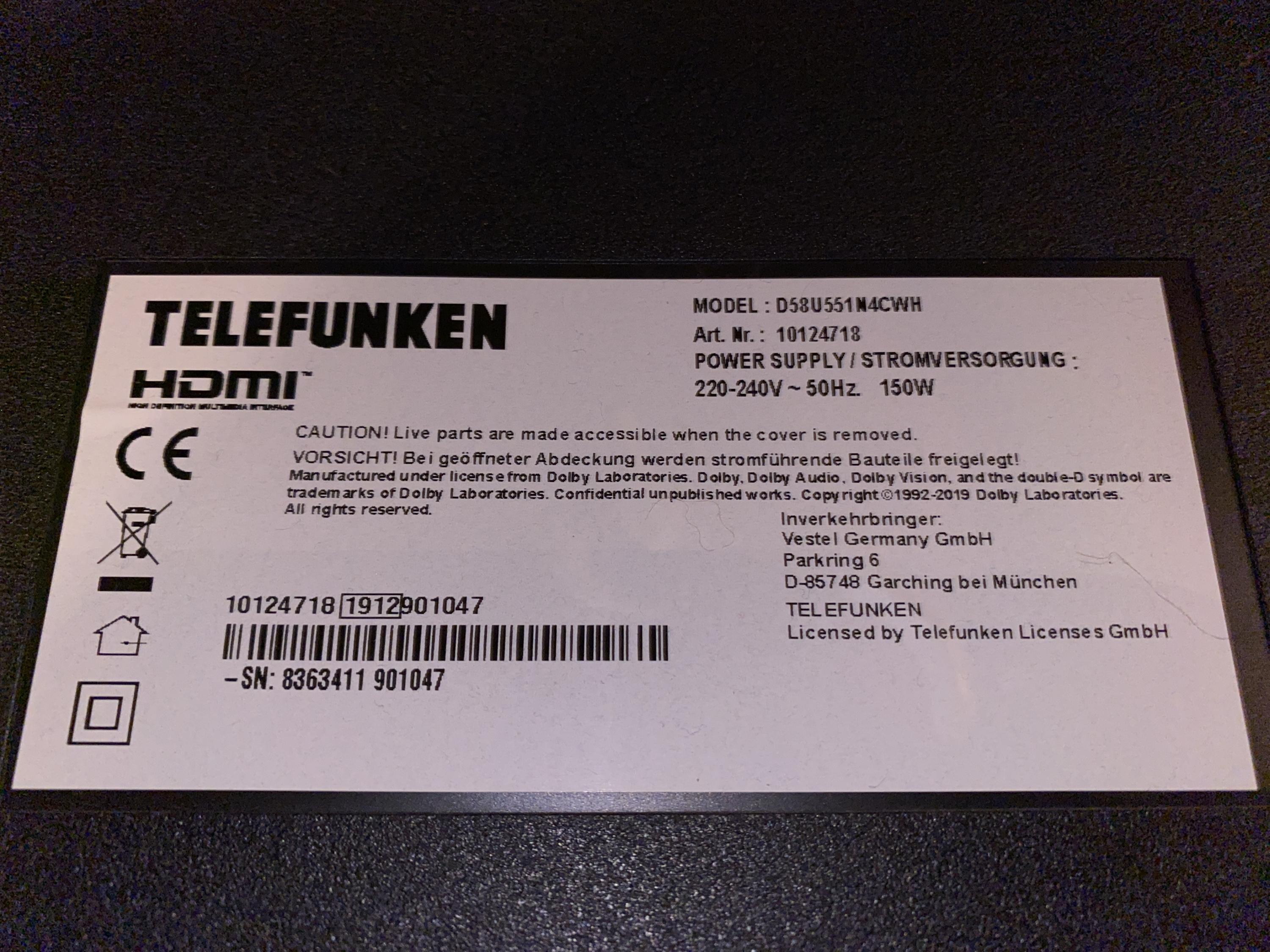

    after my TV didn't turn on anymore I decided to find the problem.
    I took my DMM and checked the power board - ok.

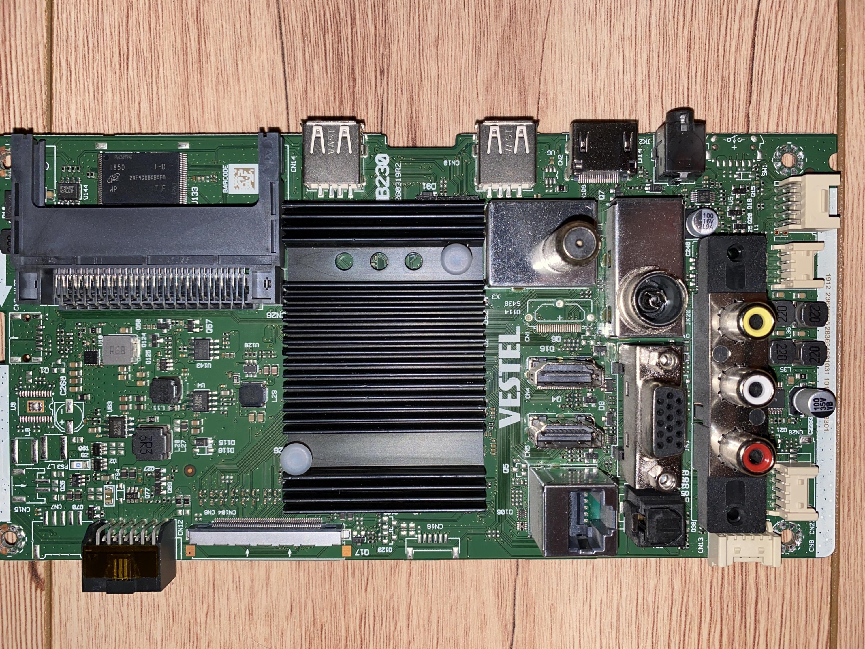

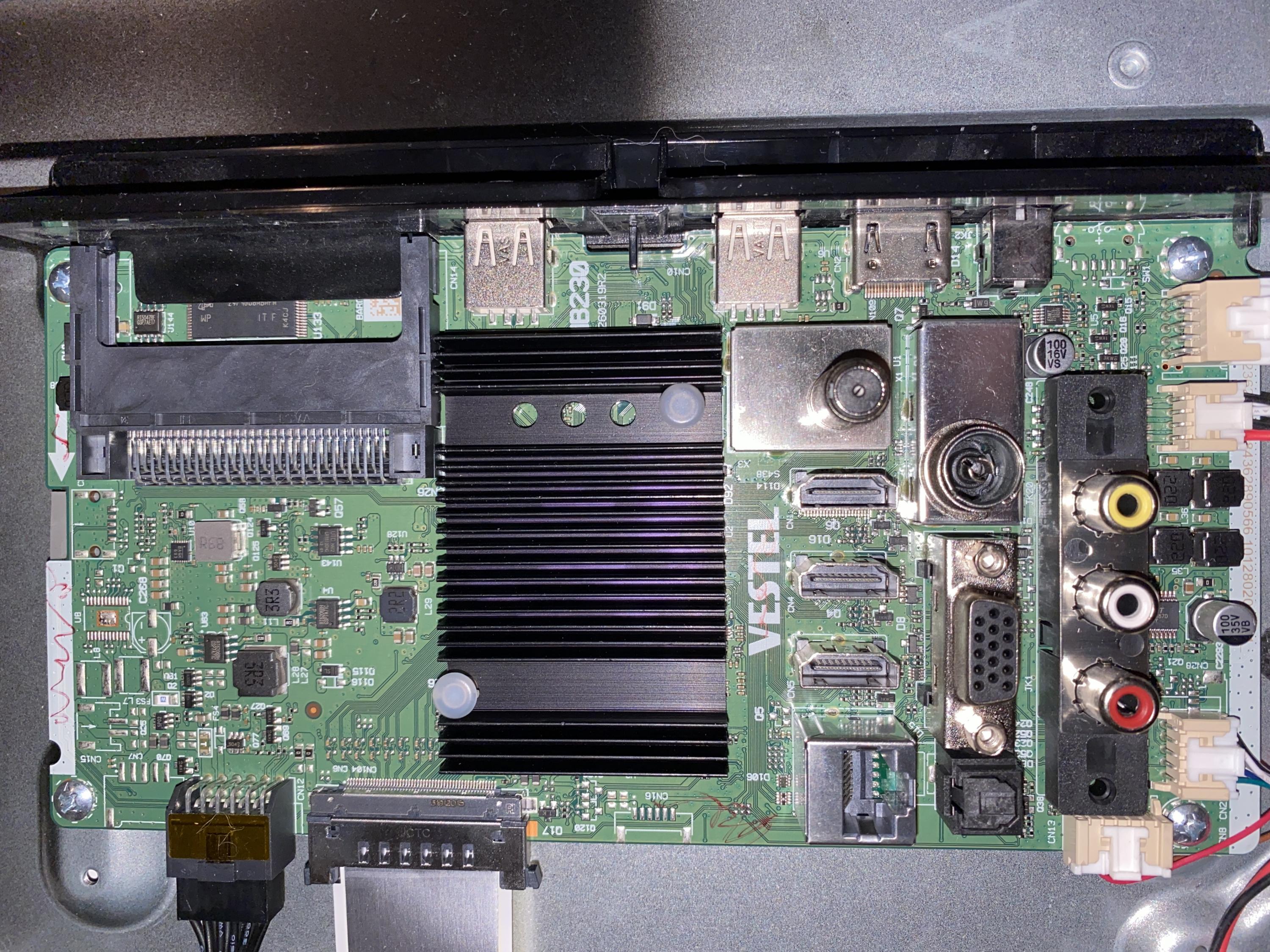

    Then I decided to swap the mainboard for a few bucks. (Vestel 17MB230)

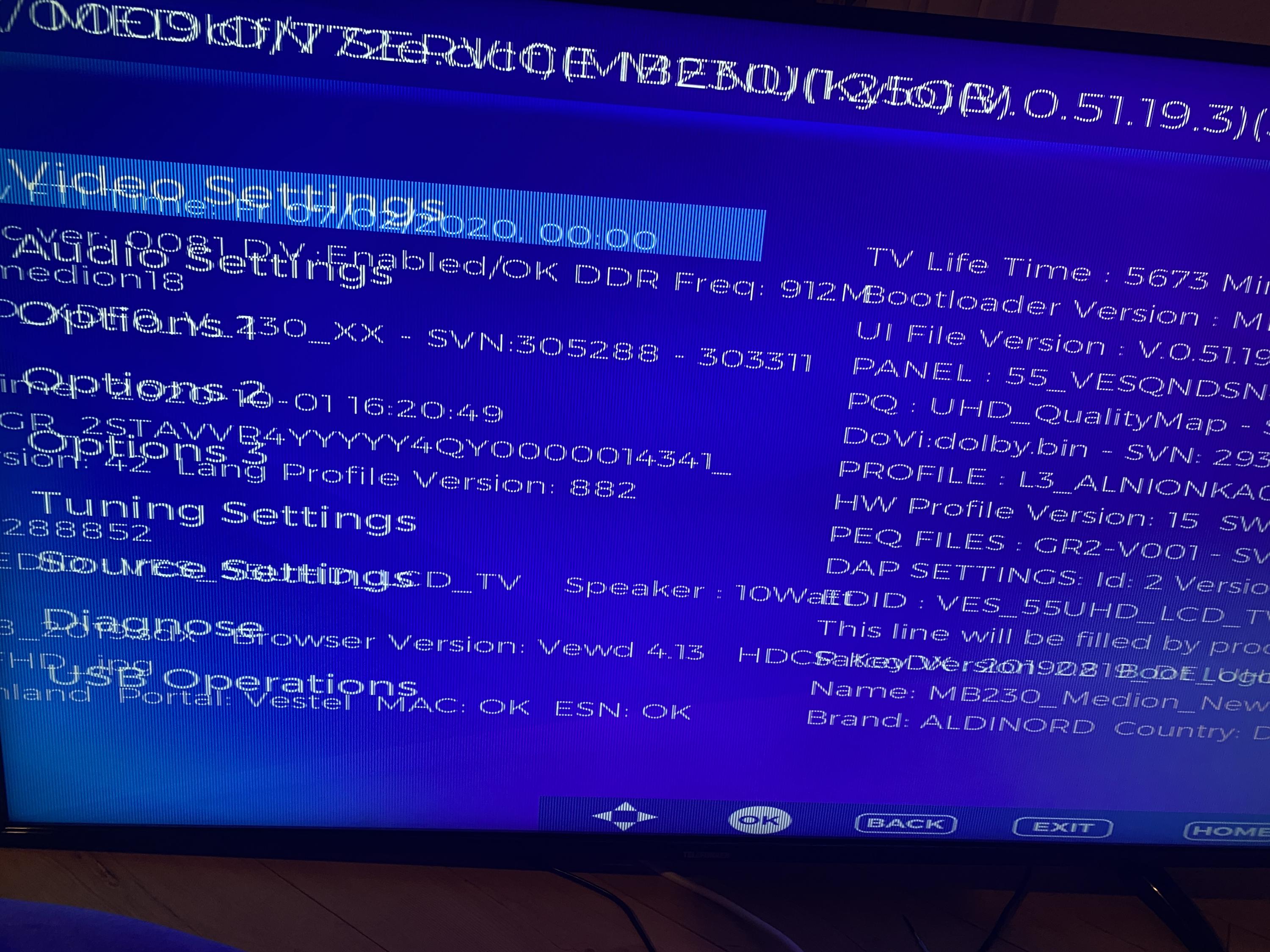

    After the replacement I stumbled upon a faulty looking display image.
    The picture size an the picture itself is distorted. (shown in the pictures)
    I did some research found out, that somehow you can change the
    display settings but I only found instructions for Vestel MB1xx Mainboards, not for the MB230.

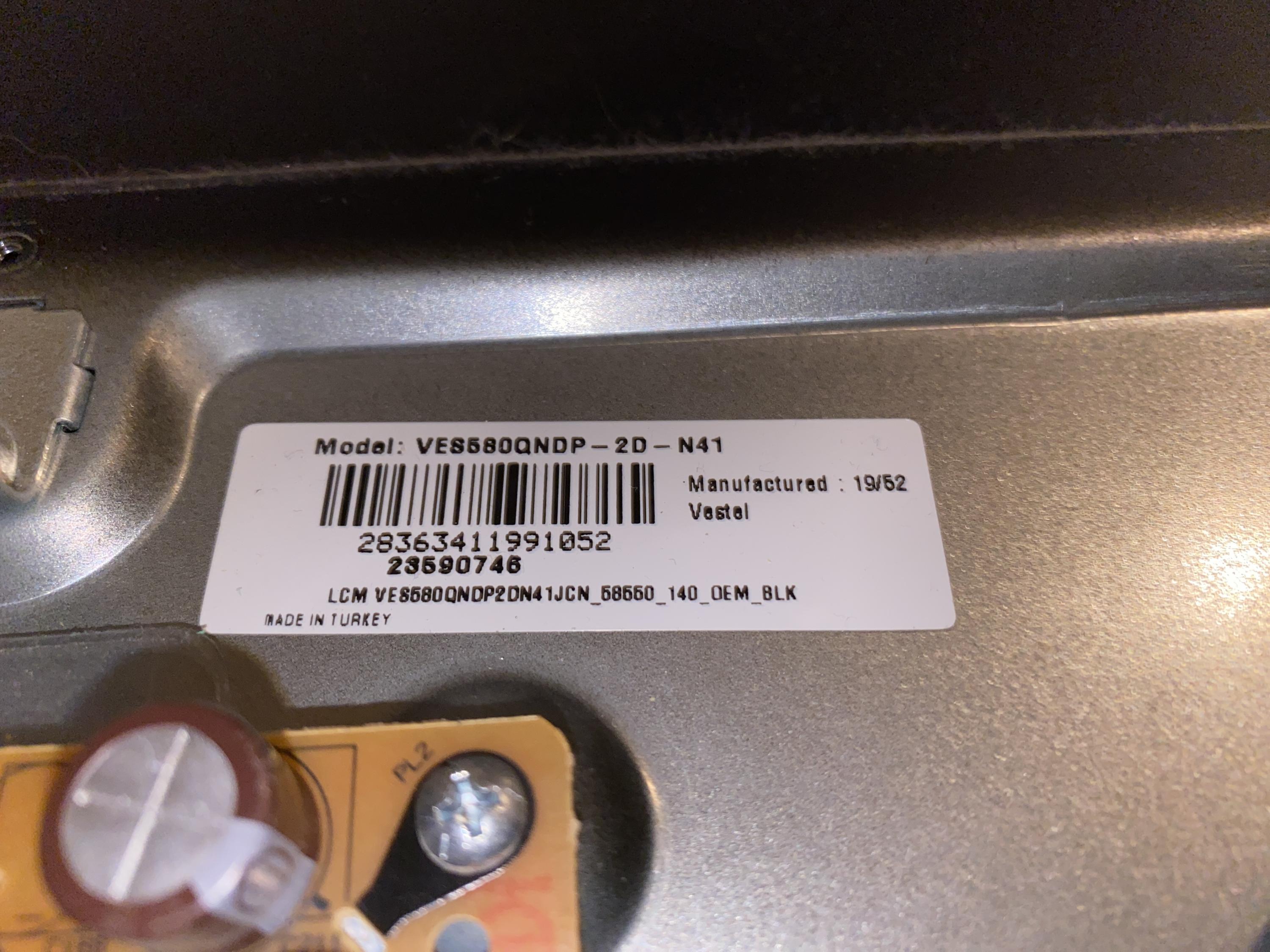

    I checked the display type on the new board: 55_VESQNDS (shown in the pictures)
    I need to change it to an 58'' type. (VES580QNDP, shown in the pictures)
    Any help is highly appreciated.

    Re: Change Panel Settings (Vestel 17MB230)
    search after brand name and yours MB 17mb230 with yours panel code right firmware to flash it via USB.
