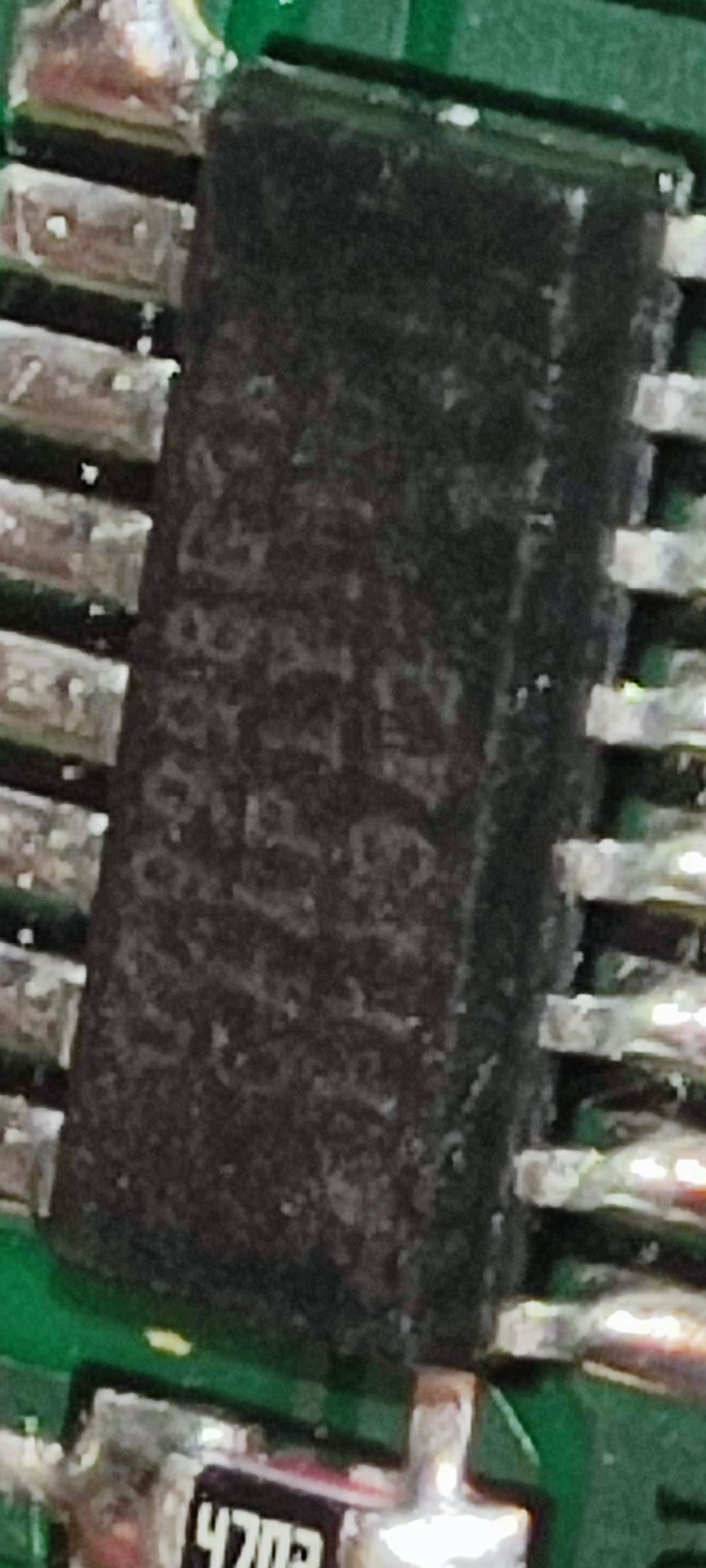

        I can't figure out the model for the BL driver IC, I'm attaching a picture of the best I've able to take from it as it may look similar to some IC you know

          Originally posted by edugimeno
          The main board was connected all the time for these tests so the signals were driven by it, and I was turning the unit on and off to get these signals during on and off state
          OZ9998BGN

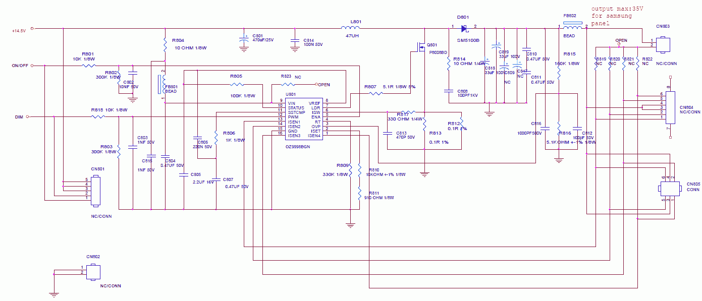

            Ok thanks to the good sight of LOTAS I've found the PDF for this driver IC.

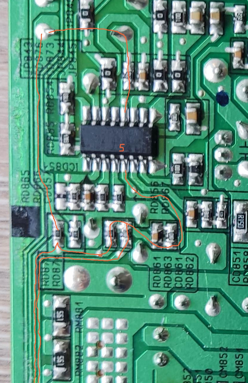

            It takes ENA signal at pin 5, which, after taking several pictures and drawing lines on my screen to follow tracks, seems to go through CD861/RD862, and then RD861/RD863 goes down to the opposite area of the board directly to B_ON in the CN to MAIN
            I will probably check the voltage directly on the ENA pin in driver IC while ON/OFF and see what I get

              Ok I've spent some time on this TV today. The worst this of this repair is not being able to find an schematic for this PS. This makes this all extremely difficult for me.
              I had mosfet QM851 (STP652F) out of the board, as it had a short. Still the BL was ON all the time with ths mosfet OUT.
              I tried to check voltages while TV ON/OFF at the ENA pin in the BL driver IC (OZ9998BGN), and it didn't show any valid voltage. I suspected it needed the (still shorted) main mosfet back on the board. I soldered it and checked again. My suspicion was right, actually with the mosfet OUT the TV wasn't fully turning on but cycling on-off all time. So I put it back in.
              With QM851 back on the board I was still getting BL ON all the time (while TV off and on), but when TV was on I could see 5v into the ENA pin of the BL driver IC, and while the TV was off I saw 0,5V. At this time BL was still lit. I shorted ENA pin to GND to get a true 0,00 v and still BL was lit
              Why is the BL ON when the ENA pin is LOW and it actually follows the signal from the B_ON pin from the main-to-ps plug?
              I'm tempted to buy a replacement for the main mosfet to see if it changes but if having it on the board (shorted) and having it off the board makes no difference....makes me think this is not the problem. But it may be something indirectly related... can you guess...???
              Thanks!

                The OZ9998BGN ENable pin is pin 9 NOT pin 5

                  Re: Diagnose PS BN44-0467A
                  And here on the diagram it is 5pin. (ENA).

                    Like LOTAS pointed out, I found that schematic showing pin 5 as ENA, which does make total sense with my board, it has just some caps and voltage dividers at the signal taken from B_ON from main-to-ps connector
                    The schematic you may have found, like me, showing pin 9 as ENA, states OZ9998B (not BGN), which seems to be different. My board reflects the one LOTAS found
                      I was just going by the datasheet, which did not seem to match the board.
                        Yes you probably found this one Im attaching, page 16
                        Anyway do you have any hint on what could be holding BL on all the time, even with EAN pin LOW? Does the shorted mosfet relate to that?
                          Without the proper datasheet, it is a guess as to what the enable pin should be, It would seem that having a low on the pin, enables the ic, so it could be that it requires a logic high to disable it.
                          From what I can trace RD861 is connected between the enable line and the B5V line, so without the B5V voltage this might be why the backlights are on.
                          Off the ENAble line there is RD862,CD861 to ground, and RD863 which connects to the B_ON pin, Off this line is RD861 which goes all the way up the board to JP814 (B5V)
