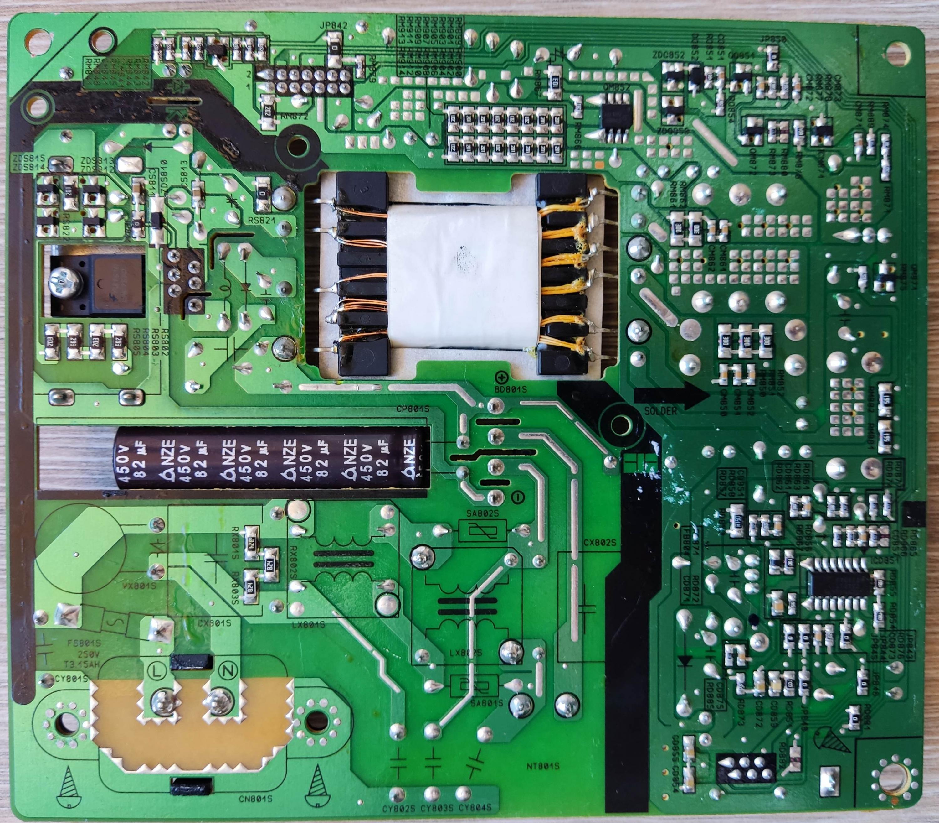

    Re: Diagnose PS BN44-0467A
    Show a photo of the reverse side.
    • edugimeno
      • May 2017
      • 581
      • Spain
      See attached.

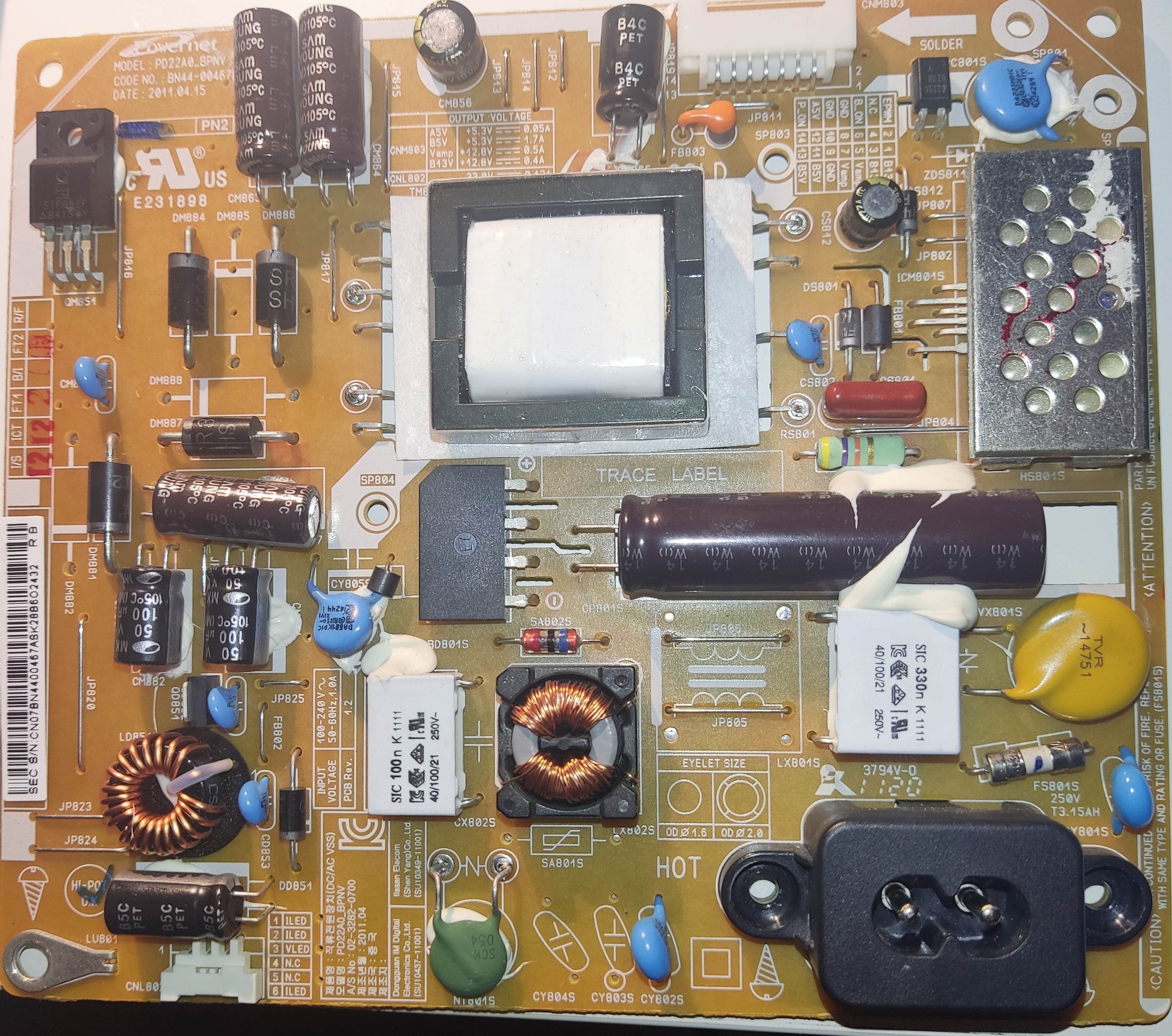

              It looks like the ic is trying to start but the run vcc is not there, Chcek that RS821 and DS812 are good.
              Check if you are getting any voltage in the secondary side, like CM864 or CM8882, I would also check all the diodes in the secondary to be sure none are shorted
              • alfatv
                • Sep 2020
                • 353
                Agree, could be a short on the secondary side.
                Need to get A5V running first, this should be standby voltage.
                Also CM856 in the picture looks suspicious.

                    Ok....DM887 was shorted, in and out of the board. I would swear I had chcked all the semiconductors for shorts initially, but this one is bad
                    Just by removing it from the board until I find a replacement recovers steady power on some of the capacitor that previously were at 0v or pulsing so this is promising.
                    Going to find a quick replacement for it in a second in my drawer and will get back to you guys

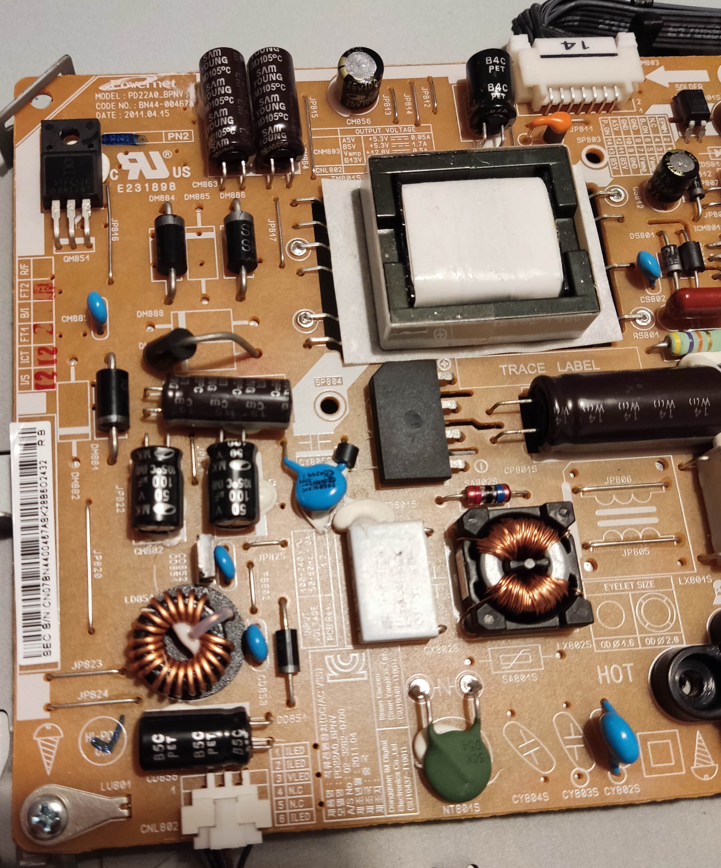

                        Ok I just checked again.
                        The TV actually turns on normally and works. But when you turn it off, the BL keeps ON (actually goes to full bright), and that is when I though the TV was on but unresponsive before.
                        All voltages look good
                        As you can see in the picture I swapped that diode that now sits (almost) vertically (taken from another board). Also that N-mosfet on top-left corner was having 30ohm between G&S but I unsoldered it and it doens't have that resistance while OFF the board. Neither the board shows that resistance when the mosfet is not on it...weird.
                        Anyway, what can be keeping the backlight ON all the time?
                        Thanks!
