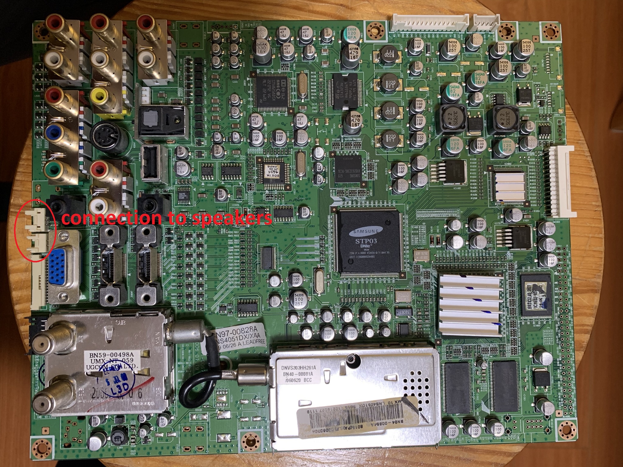

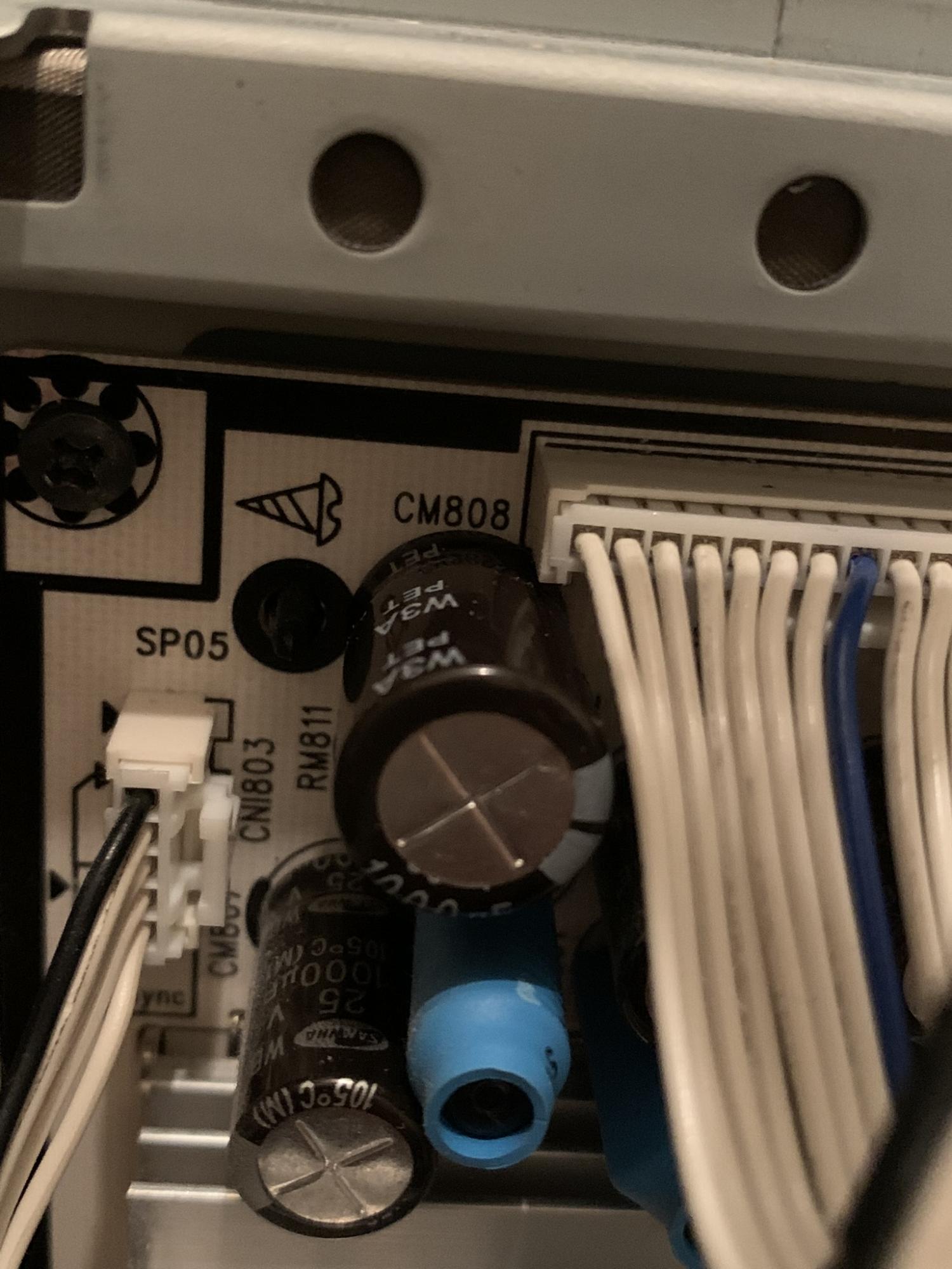

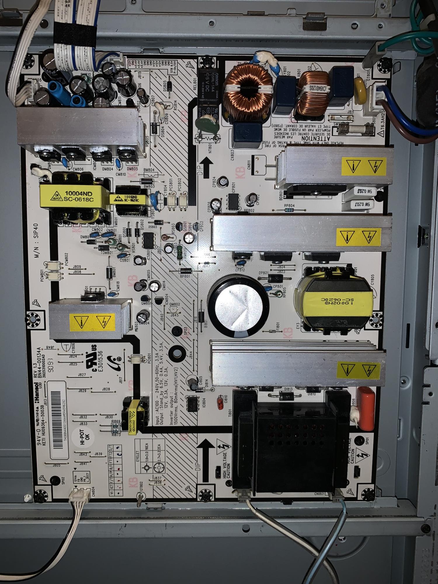

    My friend asked me to help with fixing his TV with no sound. But I only have very limited electronic knowledge. Therefore, I need you to help.
    There is picture but just no sound from the tv. I have checked that it is not the source or input problem. I have checked that the TV speakers are okay.
    On the power board, the top left corner capacitor (CM808) is with a bulged top. It is 25V, 1000 micro faraday. I then replaced it with a 35V, 1000 micro faraday because that is just the closest value I have, and I guess it is okay to do so.
    I got all the voltages as marked on the power board. Therefore, I think it is the mainboard with problem. But with my limited knowledge, and there is no visible damage on the board, I have no clue on which component may have problem causing no sound. Please help.

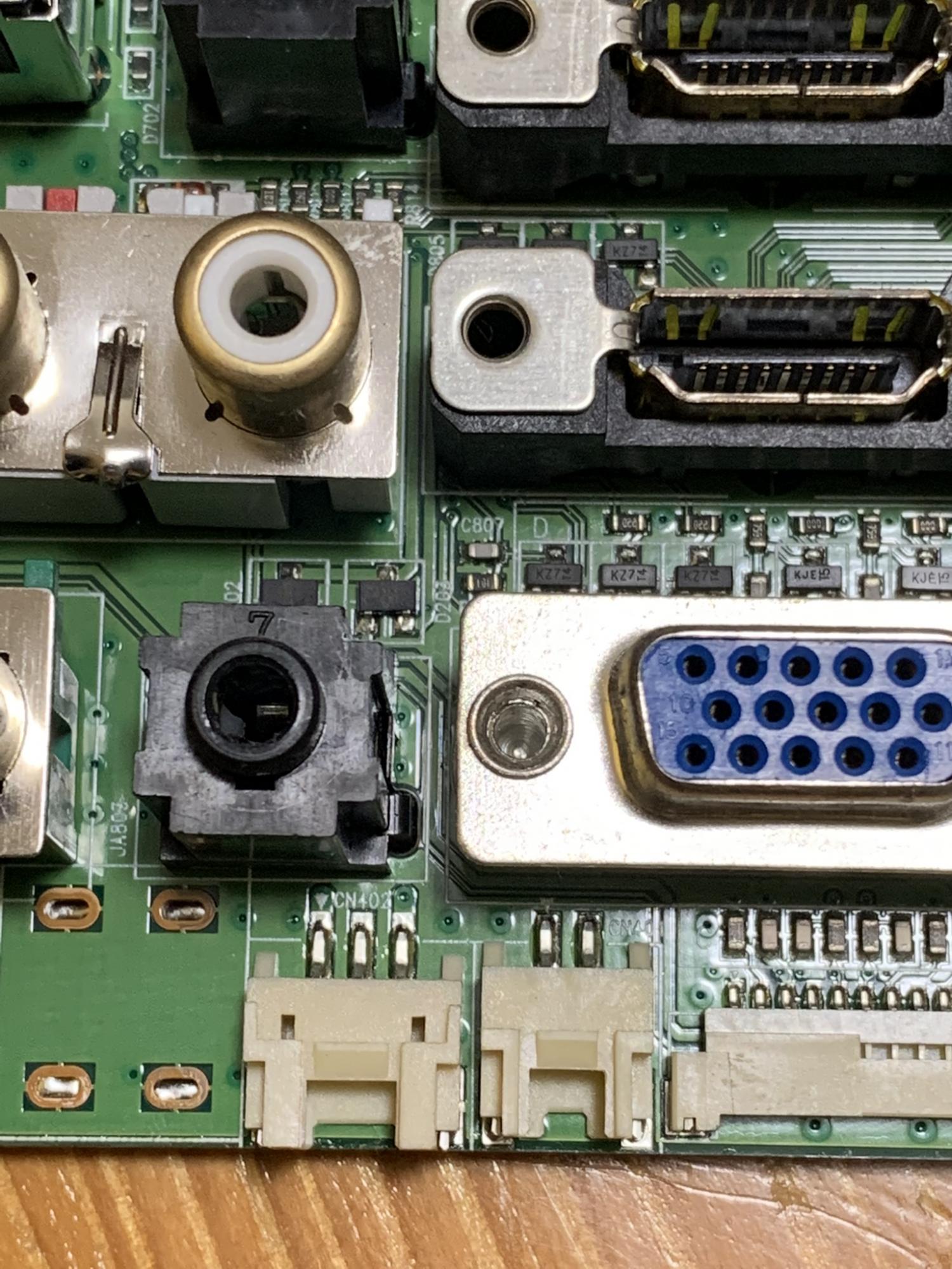

          Re: Samsung LN-S4051D no sound
          can also plug and unplug the 3.5 headphone jack or any 3.5 male end several times, see if that helps.
                    I have just plugged and unplugged the headphone jack several times. But still no sound.
                        You need to find the schematic for the main board (did I read bn97-00828A?)
                        Then you need to see how the sound signal travels thru the whole board, probably getting out of the main video processor IC, going thru amplifiers, mux/demuxers, probably more amplifiers and then to the earphone and the loudspeakers.
                        Have your TV set ON with a reasonable sound volume set.
                        Find exposed component leads on those stages and using a small earphone, connect GND from earphone to ground, and another lead (L or R) from the earphone to one needle and start touching those areas in the schematic going from start to end points I mentioned before, you should be hearing sound, very very low at first stages and increasing volume at later stages
                        See what you can with this
                              Do you have the service manual? IC302 process the audio so it seems to be passing ANY_SR_OUT, the reason there is no left audio could be due to your source. You should be getting headphone audio, but it might be muted, you would need to check the voltages on ic303 or Q303
                              To trace faults like this you need the proper equipment like a scope, without it your best bet is to replace the board.
                              I believe the melody is only played through the tv speakers, I have never checked if it plays through the aux out. Since all the switching is digitally controlled, it may even be a firmware issue.
                                        I have tried reflowing ic302, but still no luck.
                                        Thank you for everybody's suggestions and comments.
