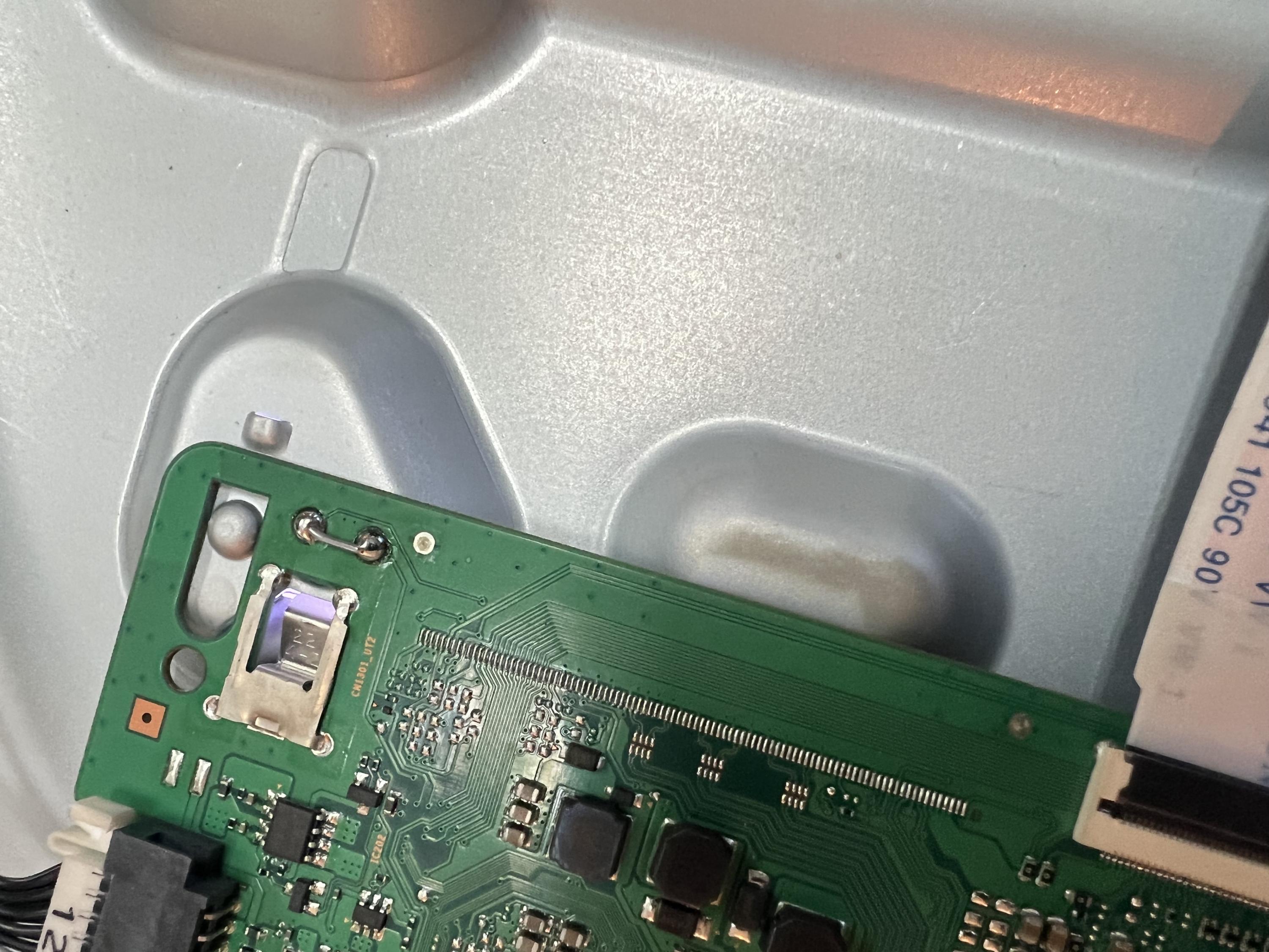

    Hello, i have posted in some other thread but i was hijacking someone else's thread it seems. I had the same model.. Anyway, here's the issue
    un58tu7000fxza samsung, originally boot looping.
    Taping a bit of the right side of the U ribbon connecting both sides of the TV's buffer board got the tv to boot, but no image. That is normal on this set.
    So i cut the VGH line on the board going to the ribbon, and fed VGH to the right side of the pcb directly, the tv powered on with no flashing, but it has lines on it.

    So, right now, i removed the VGH line to where i injected it on the screen's pcb, and the tv works fine, without taping. Did injecting VGH there cleared any shorts on it ? It seems like it? I don't understand.

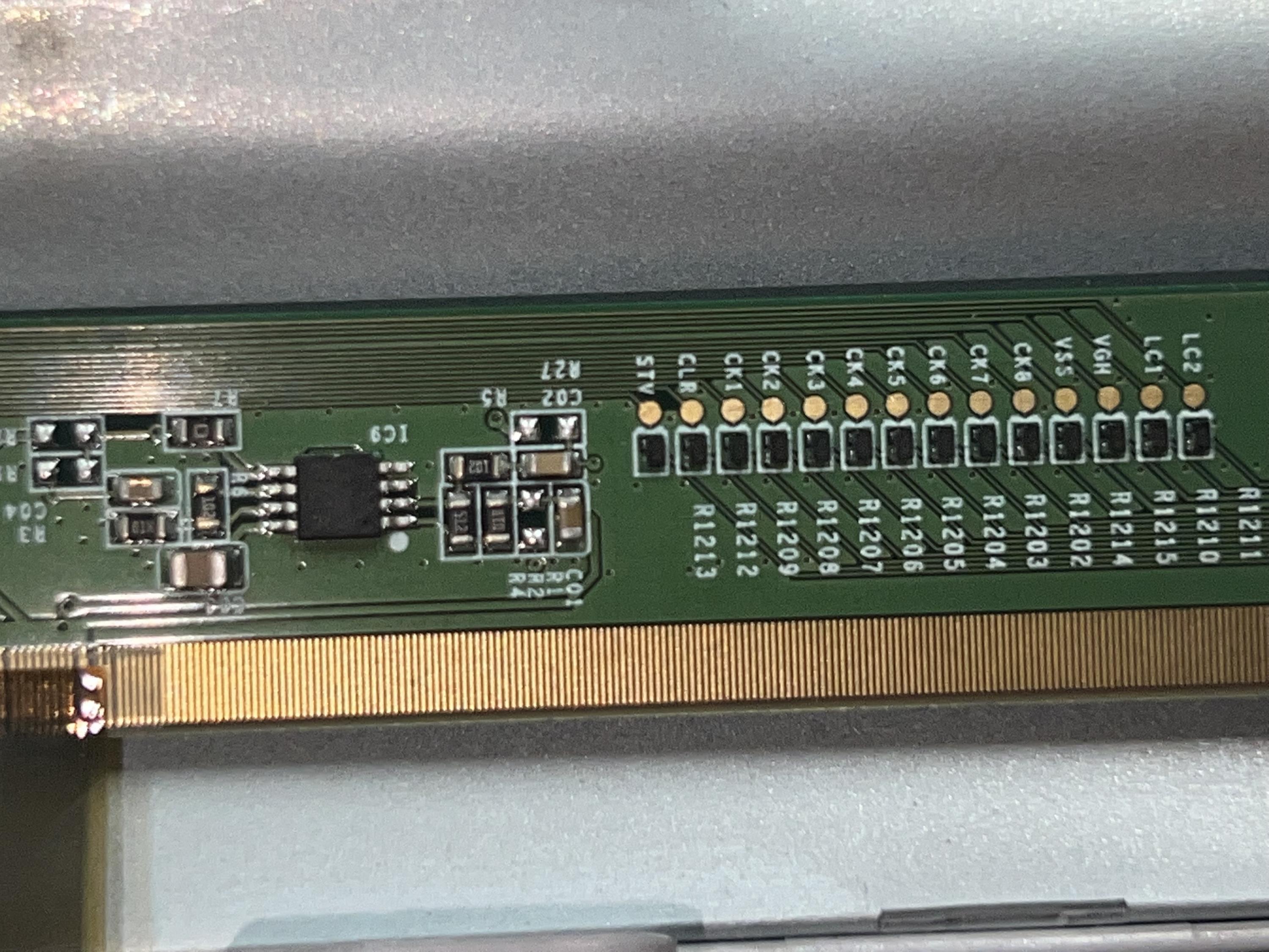

    Watching some videos, it seems there was a way to 'isolate' the fault by cutting the CK1 to CK8 and VSS/STV/VGH/CLR/LC1/LC2 on one side of the pcb. I've then reconnected all these traces back since it didn't change anything, still had the same issue with lines on the left side alone.

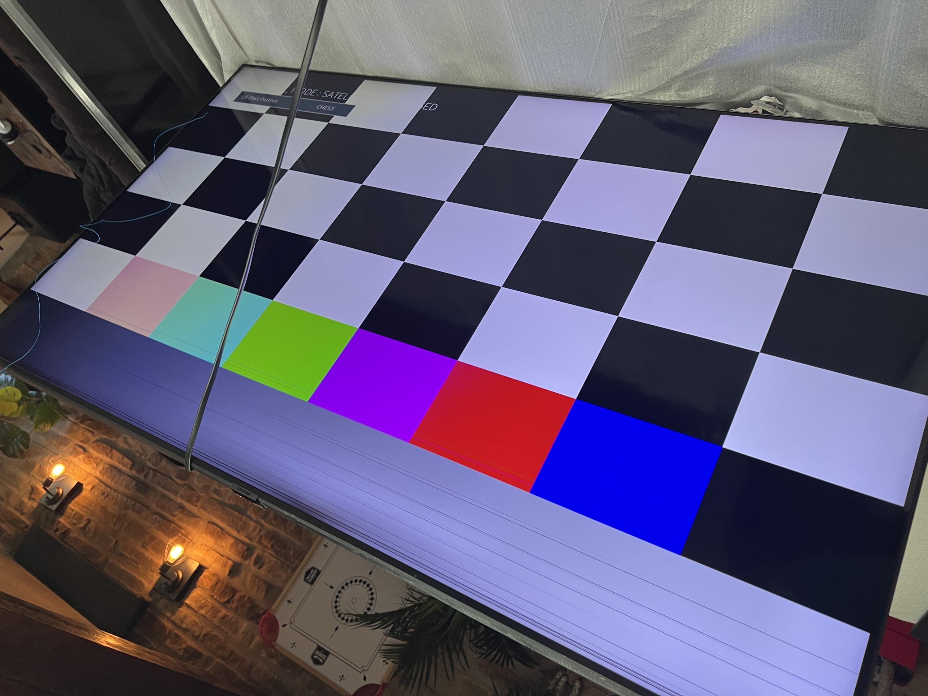

        However, these guys in south america were able to restore the full color on the bad side, it's clearly shown in these vids.. But i haven't been able to follow due do the language barrier, even with the subtitles, i don't get it.
        Lines are ok, but the washed out color ? Would be great to restore it.

          it's a bit hard to follow spanish when spoken that fast, but that tv was rebooting, he says to check the main board dc-dc voltage (in 14V, out 12.8V), then to check both panel sides to see which one is causing the tv to reboot, test for shorts, he found none.
          Next is to remove these resistors and see if the rebooting stops. He cut VHG, then applied 12~13V and test where it stabilizes. After that, link those clock lines back and see which combination makes the colour on the defective side come back. He said that in this TV the only defective lines were VSS and CK6, if he tried to solder those back the tv would reboot.

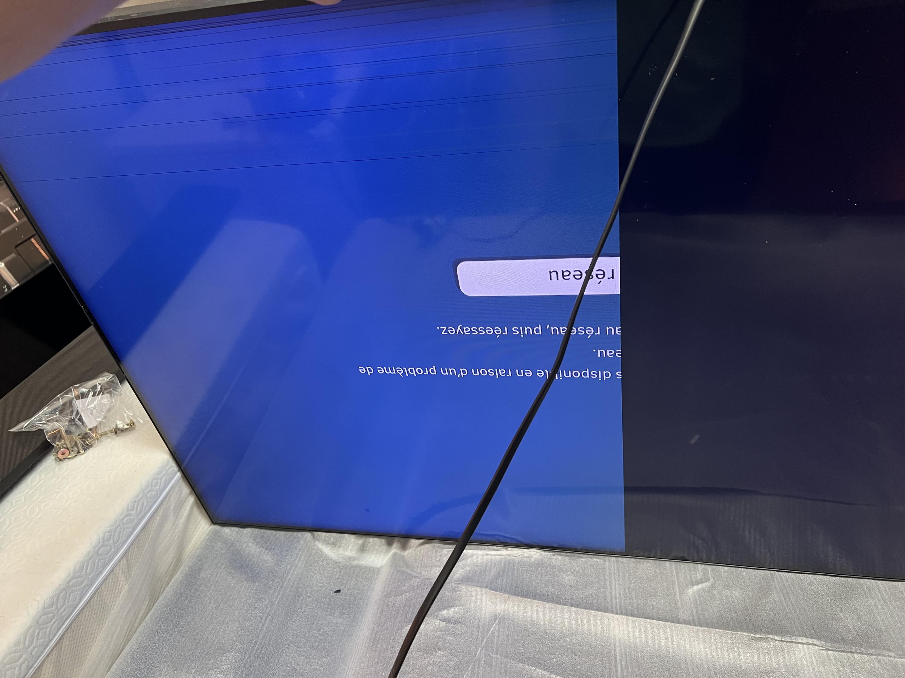

            Ok, this what i understood it also. I cut all the lines one one side, but the lines did not dissapear, and the washed out was still present, with all the lines cut one one side and the U ribbon disconnected at the bottom, so i totally isolated the right side of the screen alone.
            When done, this side of the screen was lighted up, with black lines still.
            After that i reconnected all of the cut traces, when put the bridge back. So basically did all of that tiny soldering for nothing.
            Now, since i saw lines on that side that was isolated, does it mean that these lines are really coming from this side ?
            If it means that, well im gonna try the same exercise on that side, cutting all lines and re-connecting them back 1 by 1.
            I still dont understand why there are 2 issues at the same time, the washed out colors AND the lines..
            Are these 2 different panel issues, at the same time ? Or the lines are caused by 1 of the CK(x) lines, and that creates the washed out panel ?

              whenever a TV has those horizontal lines it will start from the defective side as really strong and get thinner and dimmer as it passes to the funcional other half. In your case they originate from the right side.

                Ok, but why is the other (left) side washed out, if the issue comes from the right ?
                I will proceed to disconnect (cut) the CK(x) lines on the right side to see if the image improves and then reconnect them 1 by 1
