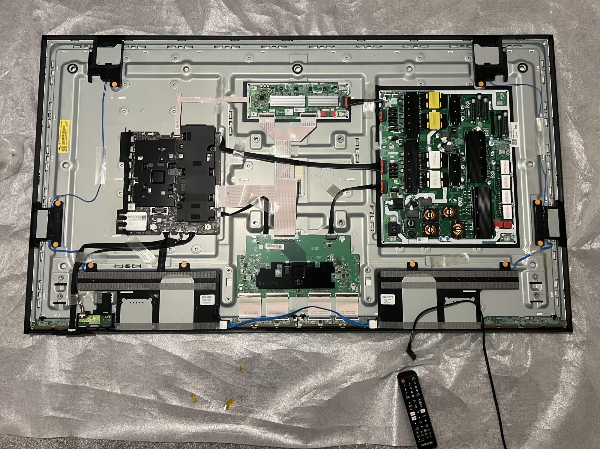

    I have tv model qE55Q700TATXXU Samsung 2020 8k model with strange issues, it would work fine for a day or at least few hours and then go in Loop restart, it gives you like 10 seconds before doing again. If I leave the tv off for long period of time, it would eventually work again for few hours or a day and start doing it again…
    I have opened the back and tried to find what's causing the issue but can't find it yet… If I remove any flex connecting T-con with main board, it stop boot and I can hear tv working normally (can hear Samsung plus channels) but no video, just the audio and back light leds, If I removed one of four connecters coming from screen to T-con again no video and only audio but no loop and can hear audio. Same if I remove PSU connecters going to Mainboard or T-con (no loop but also no video)
    Check the picture to see how it looks on the back
    If I connect everything back, I can see video for 10 seconds or less and then it restarts…
    Anyone can help me? Luckily I have a same TV in working condition if needed I can take parts from it to test what's wrong, but not sure if its worth the risk…
    Thanks everyone who can help me with this

    Not sure how risky it would be because not sure what is wrong, but if you want you could try your tcon from your other tv in there, maybe just run it long enough to see if it clears up the problem, if its the same then turn off right away and switch them back out, that should confirm or eliminate the tcon as the culprit.
