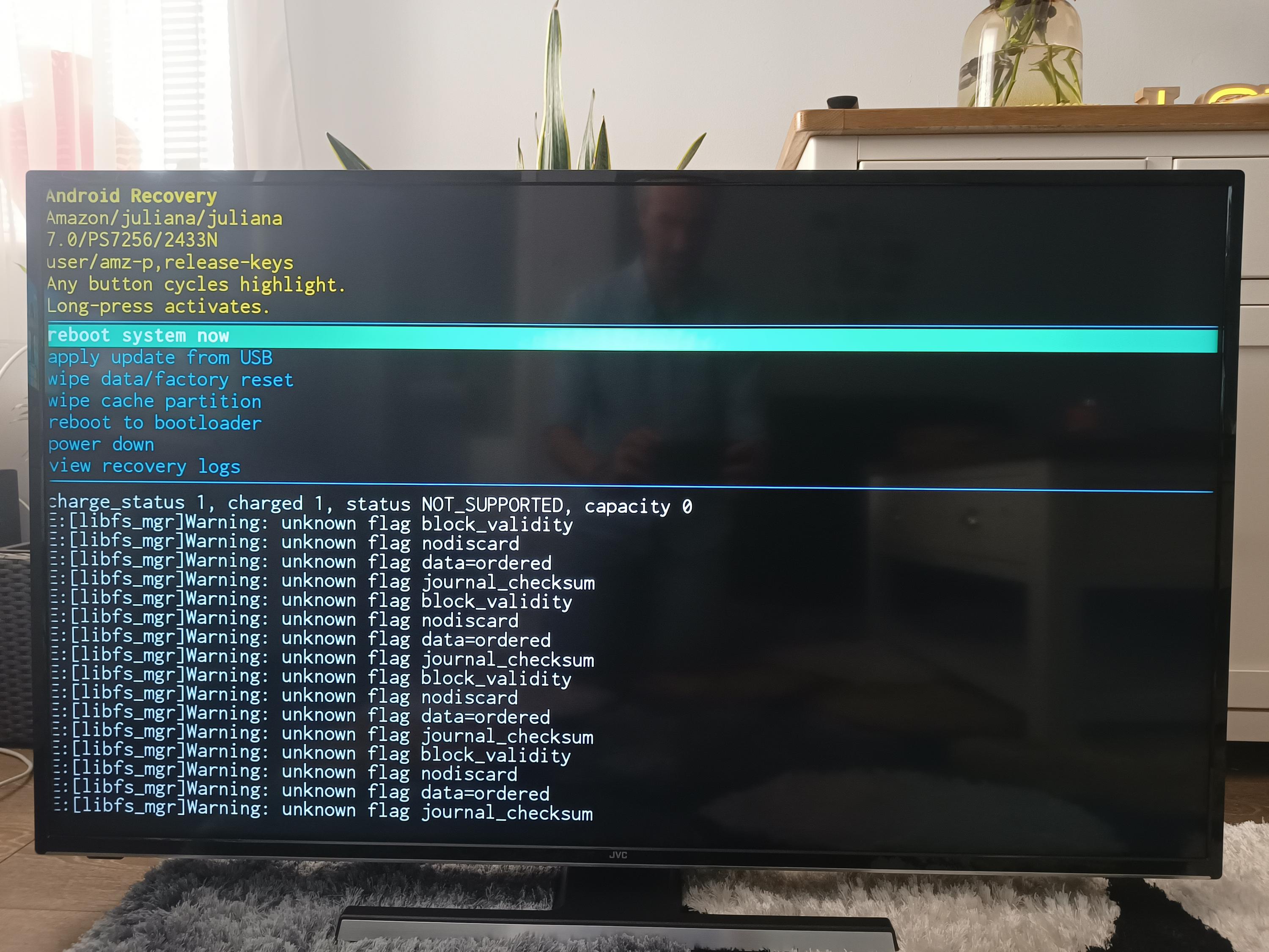

    Fire TV - JVC LT-50CF810(B) -Keeps rebooting in the loop
    I need your support, please.
    TV keeps rebooting in the loop.
    After switch on to the power shows the Android recovery page.
    See attached picture.
    Thank you very much for any help.

    Re: Fire TV - JVC LT-50CF810(B) -Keeps rebooting in the loop
    did you tried one after other
    1- wipe cache partition
    2-wipe data factory reset
    if this didn't bring it back mean issue at nand , so post clear high resolution photo on yours MB
